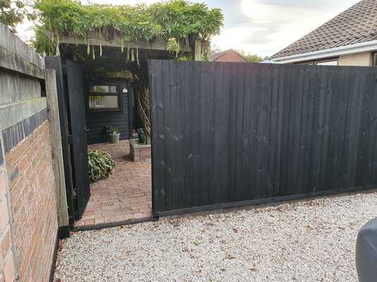

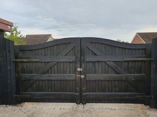

Running between wall and gate post, getting into hollow post through the fixing holes?
Is it a hollow post? Top sealed? Any holes?
Did you ever have any temporary services like water, drainage or electric penetrating the "roof" that were cut off.
Is there a gate post? Bolted to the wall I assume rather than into the ground.
Water could be running down the side of that embedded bit.
