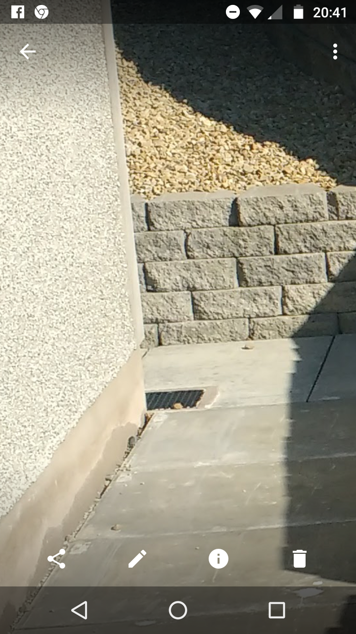

Hard to make out on this photo but the dpc on mine is where the dash stops. It kicks out like a bell cast and then steps in for the rubbed up section below. Any rain that runs down the wall drips of away from the wall onto the slabs below. You can't have your dpc higher than your finished floor level so don't step it up much. It is usually a course of block below this level.
