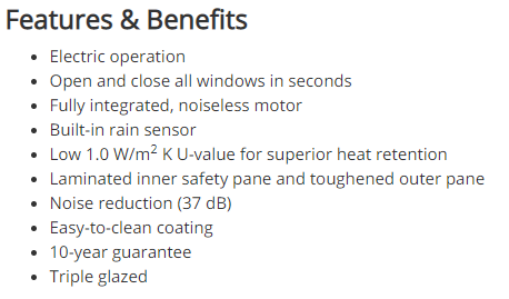

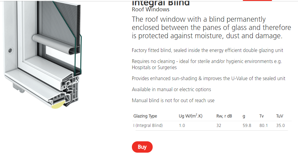

  19. The Keylite was 2G but appears to have the same u-values as the 3G Velux (as below) This is the blurb for the 3G Velux:
  20. I've just had a look at Keylite and see they do an Integral blind model in double glazing but that the u-values (1.0 W/mk2) is the same as the Velux Integra 3G, with costs about the same and negating the need to buy and fit blinds to the Velux model. Am I missing anything?
