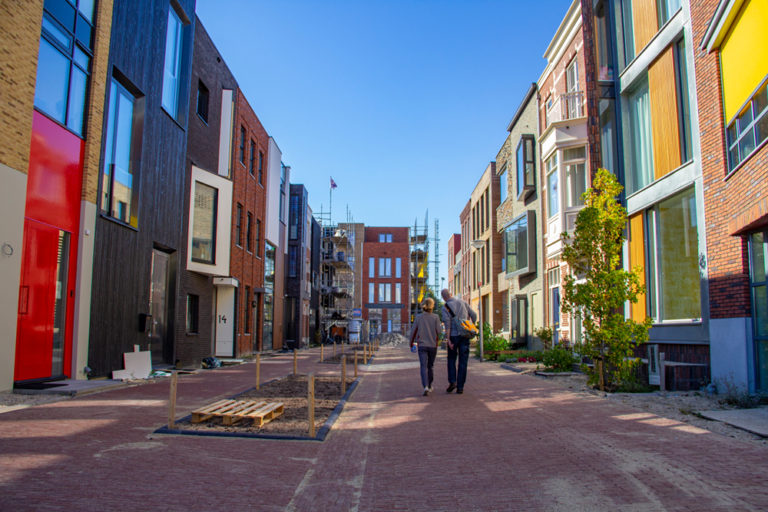

Looks good and can see where you are coming from - there's an SME developer in south west Scotland that only does small developments in the local vernacular and whose sites I love but I'd take a streetscape like the one below before it: There's some custom build pilots that aim to do that but not sure how they're progressing (Igloo, now owned by Aviva, have a site in Plymouth which is the main one that I remember from looking before, where you could choose from shell designs by a panel of architects then choose from within approved palate of materials and configure however you liked internally).
While some houses are ugly they're still far more interesting than an identikit volume developer house. I love the idea of having random designs, shapes and sizes in an Almere like fashion but it sounds a real pity that the development company are constraining supply in such a way that only a certain type of household can build and only a certain type of build will be possible to meet mortgage market valuation requirements.
