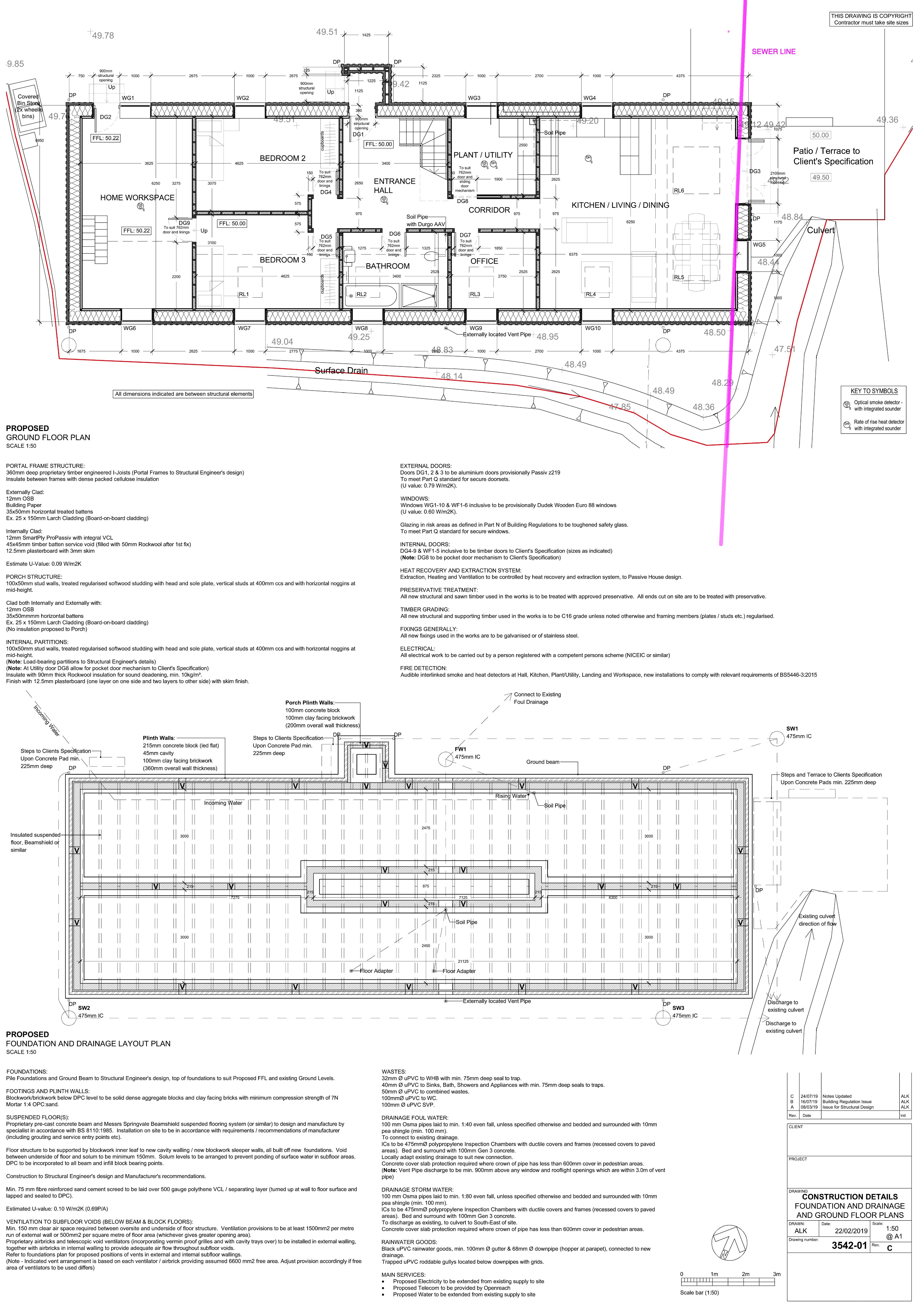

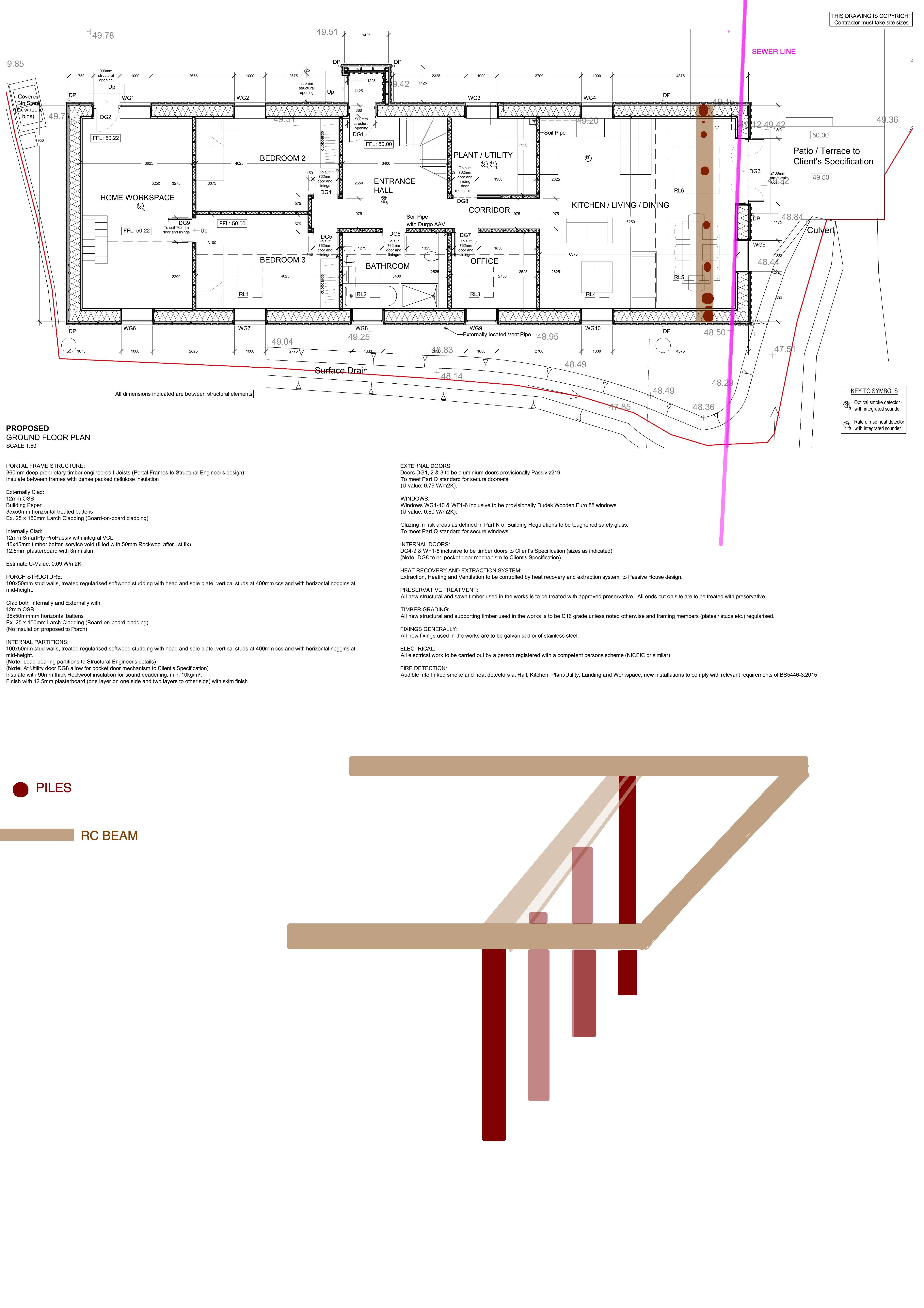

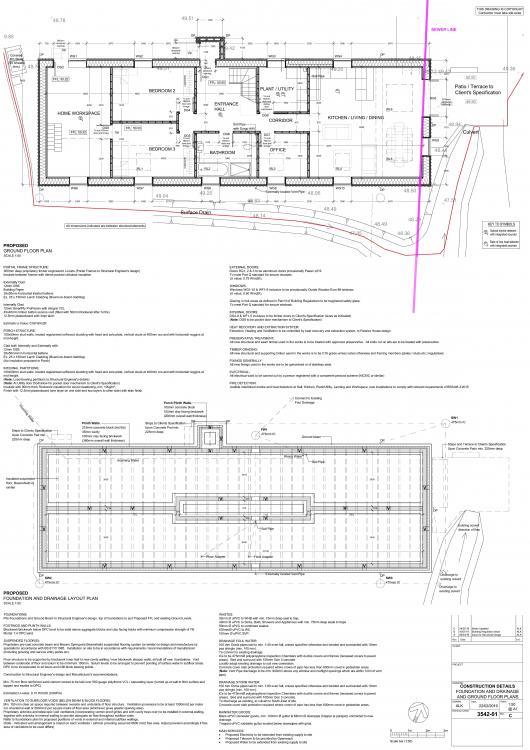

OK. Just cause I always prefer to read the ending to stories, I give you the result :Emailed my SE, asked if she could do cantilever calcs for what I sketched up at the top of this thread. Answer was 1. Not a problem, takes 2 hours, cost about 60£ 2. Probably don't need any adjustment (subject to calcs.), as the existing piles and RC beam are massive anyways. Excellent result. Thanks everyone as well for chipping in.

Yep, it already is going underneath the stream. Digging down and rerouting the stream and putting a new Sewer pipe in definetley will be more expensive than redesigning the foundations, as we are on piles anyways. This will be the Plan B , if Plan A should be not possible .

My SE will be able to design it. She is a good Engineer. I just wanted to know if that is the best method or if there where alternative ideas out there. My SE definitely won't come up with any creative alternative solution (should it exist) and will just go with what I tell her to do or, if in doubt, bang a few tons of steel in.

That would be great, but there is a stream which would need to be redirected or dug under, so even more expensive than cantilever over the existing sewer I believe.

Yesterday the guys from Wessex Water came over to check the Sewer Pipe that runs underneath the property and give their ok/opinion on it. Good news is that the Pipe are all fine , not cracked or broken , so we will be able to go ahead with building over the sewer. Bad news is : Our rear living room wall sits more or less exactly on top of the sewer pipe.(see Plans ) I dont want to change the size of the building and we cant move the building elsewhere , as the plot is too tight to move it significally. I was told that Wessex Water requests at least 500mm distance between any Piles and the sewer. So how do I support this back wall? I know I have to give this too my SE eventually to get it sorted, but unfortunately my SE does have the creativity of a Strawbale so every "creative" or "alternative" solution that was developed throughout the planning, I had to come up with and SE was just twisting the numbers to see if it works. On the other side , my Architect is VERY creative , and I could give it to him, but chances are that he comes up with a plan that involves a curved bridge over the property that is build out of carbon and supports the entire house via electric magnets , available for just under 9million £ (to be calculated by SE) My best Idea so far would be to build a kind of Foundation-Balcony Like this: Where the Piles sit back from the end wall for aprox. 600-700mm (giving the sewer the requested 500mm space) and the Concret RC BEAM just extends over the end of the piles to form this little "blacony" Fortunately, our house has a small flatroof, single story "extensions" on that end , so the weight on that overhang will be minimal. Any other , alternative solutions? Does this make sense or is it rubbish? And any other flaws in the drawings?
