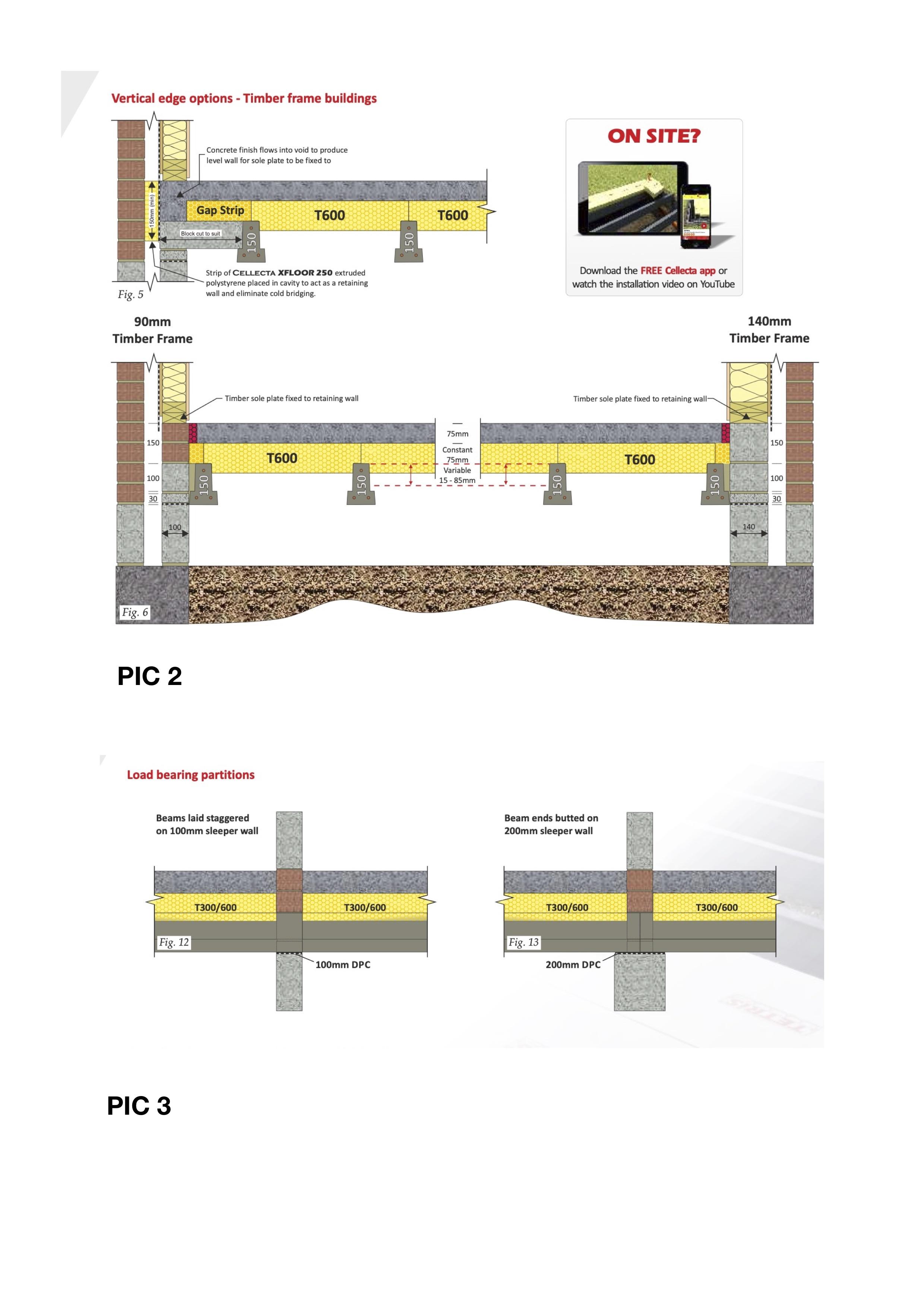

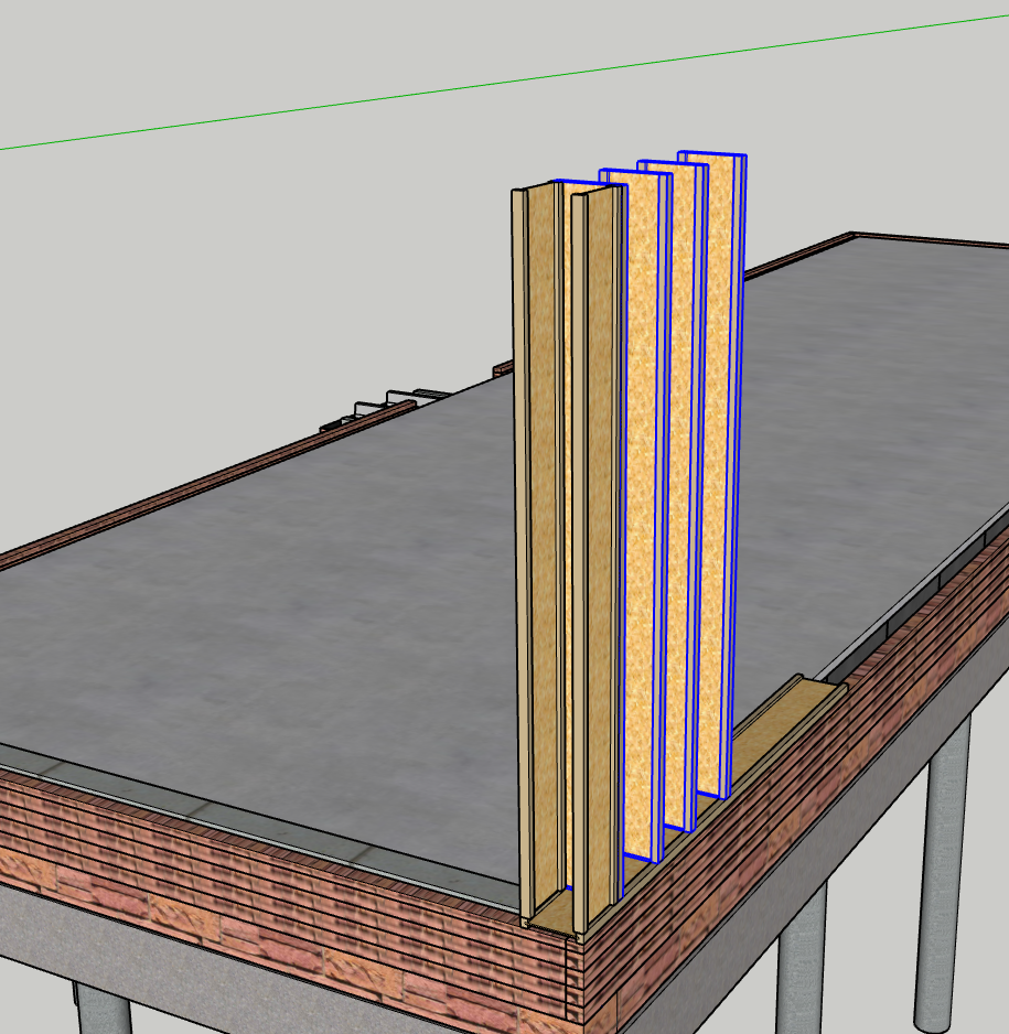

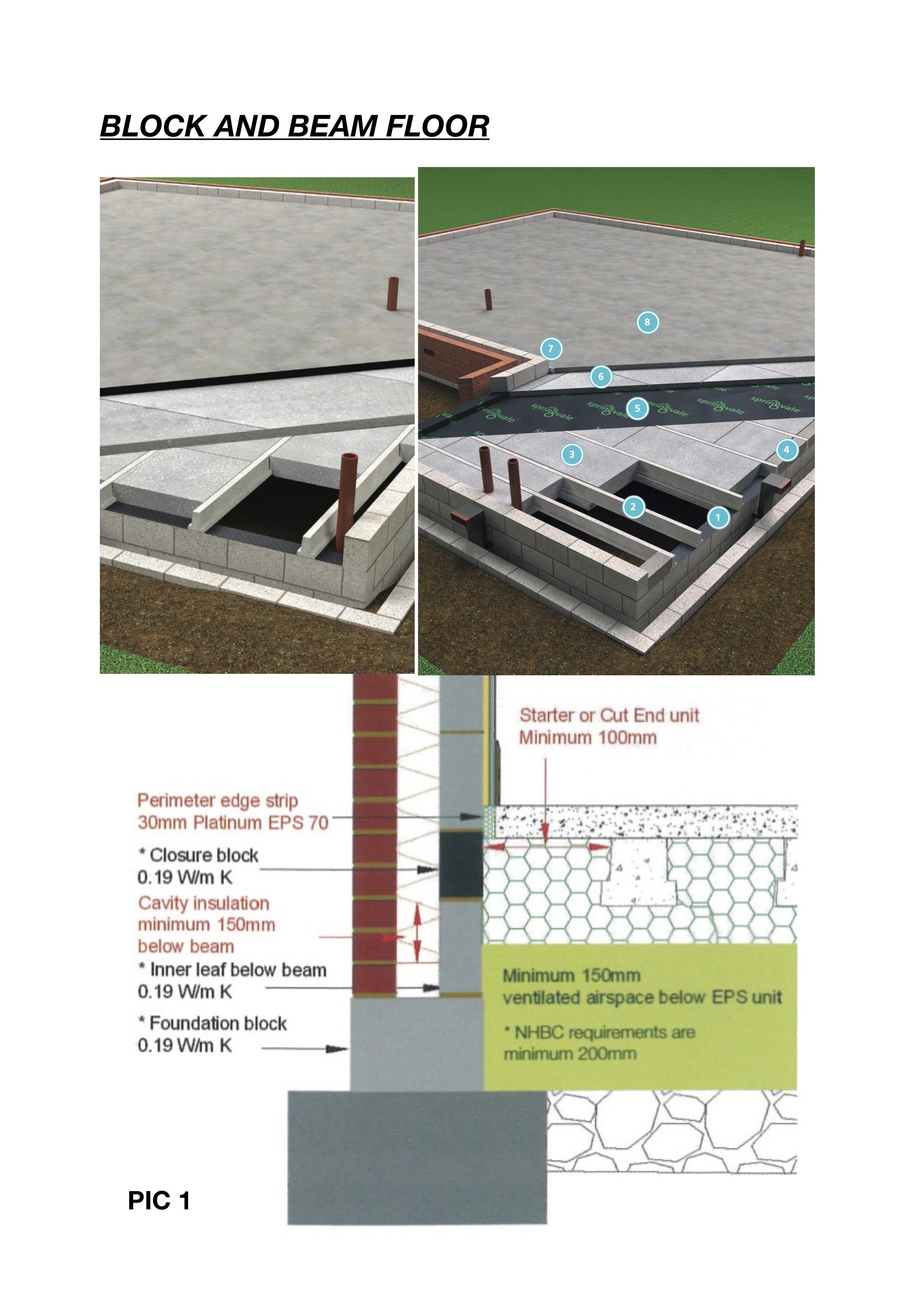

Maybe someone can help me understand this a bit better, as I haven t seen any drawings that make sense by manufacturers. Or maybe I am just too thick to understand. I am building Timber Frame(i-beams)_ with timber Cladding on top of a Insulated Block and Beam Floor. Most of the Block and Beam Insualtion Systems have manuals of how to lay them out. But they all just explain for timber frame with cavity and Brick Cladding/ Render to the outs ide. (See PIC 2) The entire setup is fairly similar with all the manufacturers , it is something like this: So If I want to put I-Beam Walls on top of this, should I put them over the cavity , a bit like this: Or could i not make the entire Foundation like a Platform with Screed going all the way to the outer skin of the wall in order to build from this platform (a bit more like you would do with a suspended timber floor) Hope this makes sense. But in PIC 3 is a short description of load bearing walls and my understanding is, that they have to sit on top of Bricks/Blocks not on top of EPS ? Not trying to overcomplicate, more than happy to go with what s easiest this time. If you could give me some sketches or drawings, even just quickly handscribbled, as I am stupid and understand pictures much better. And also YES-it really has to be suspended Block and Beam NO - I can not use different Foundation systems, Not Passive Raft, not suspended Timber Floor . Cheers ?
