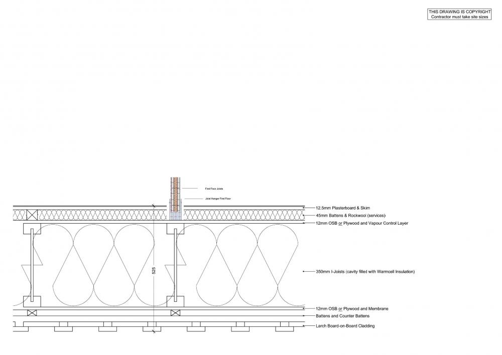

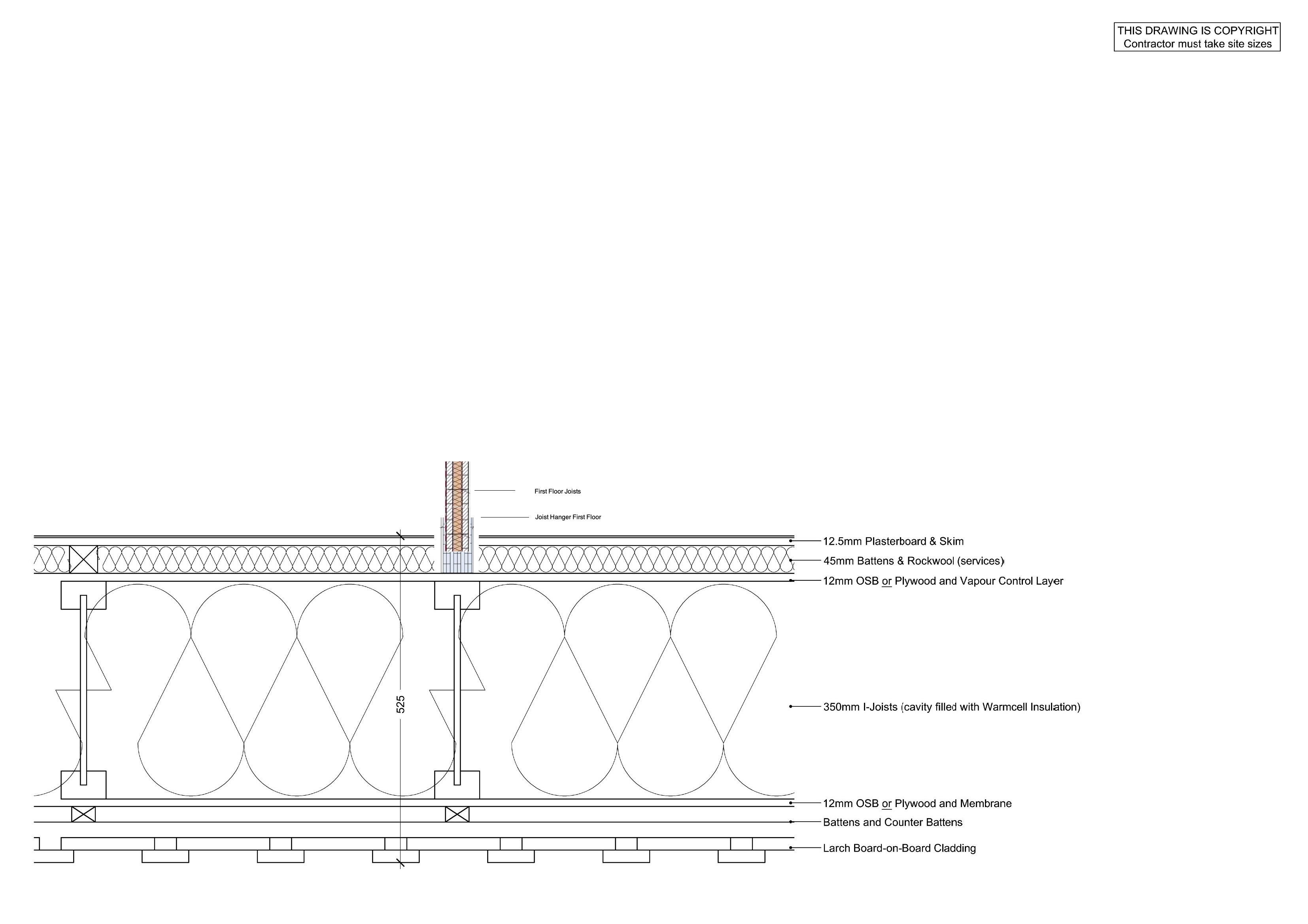

Thanks. This than only leaves me with the question how to attach it to the I-Beam wall in a similar fashion than @PeterStarck done it . His method seems to be excellent, even though i would like to do the same while still using Blown in Cellulose . So need to put a Foil behind the ledger plate. Tricky .

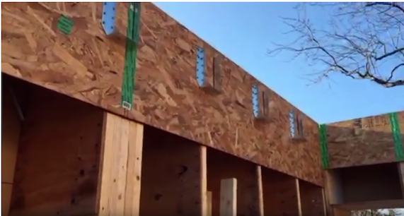

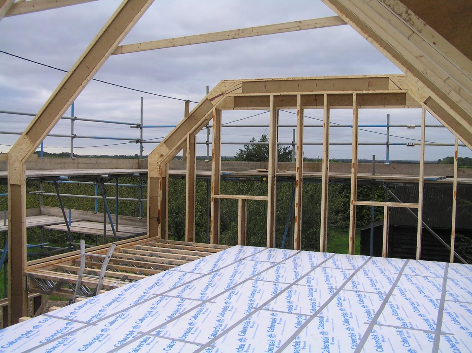

Could not find these details anywhere so far. Very often the Stick Build Constructions are traditional Framing techniques, where the first floor Joist sit on top of the Groundfloor studs and so on... For a Portal Frame construction, people seem to use prefab timber frame companies.So the company will sort out these details. I wanted to see if someone has experience in this or how you would do it/ are doing it. I was wondering what would be the best way to attach the first floor Joists to the outside Walls in a Portal Frame, while keeping the Airbarrier flowing without interruption. I hijacked one of your picture @PeterStarck to demonstrate what I mean Here are the first floor joists, attached to the outer frame without any airbarrier (as far a i can see) . This means, as far as I understand, that you later have to work/tape around each Joist for airtightness. I have Found one solution that made sense to me, but I am not sure if that works well : Studs are carved in on the level of the floor (potential problem with the I-Joists) than timber studs are inserted as a backing board before the Airtight Membrane OSB (in this example just plain OSB) is Nailed on to the front . Than joist hangers are Nailed into the timber studs(through the OSB) And the Floor Joists go into the Joist hangers. Later on the Osb in the Groundfloor and the OSB in the top floor can be taped to the osb section "behind" the floorjoists/ Seems like a method of eliminating some problems(cold bridging, airtightness) It than looks a bit like this: Hope this all makes sense. I m much better with visualising things with plans/photos so if anybody got some sections or drawings of a similar setup that works, I would be very greatful . All Ideas are welcome.

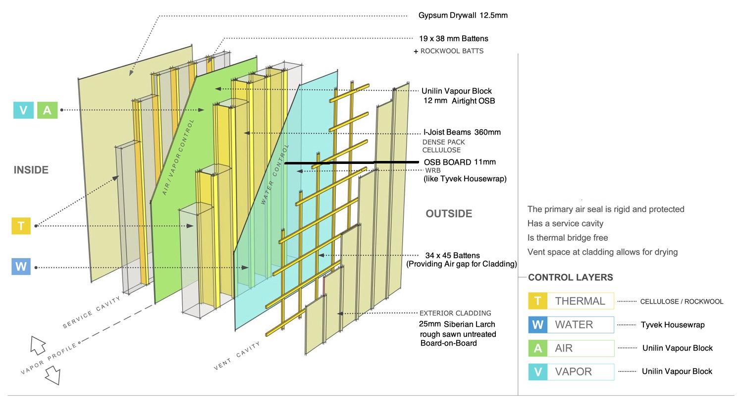

@Simplysimon Sounds good. My internal insulation is only because there is empty space anyways. Might as well insulate the service cavity I thought. Just pushing down a few cheap rock wool pieces myself. Main insulation will be the 360mm. I wanted to do 350like you, but most ibeam companies only provide 360mm. Apart from 2, so wanted to have more choice getting quotes. I guess you are going with a certain timber frame company that likes to use the egger dhf outside ?? Any idea what bonus the outside insulation will give? -

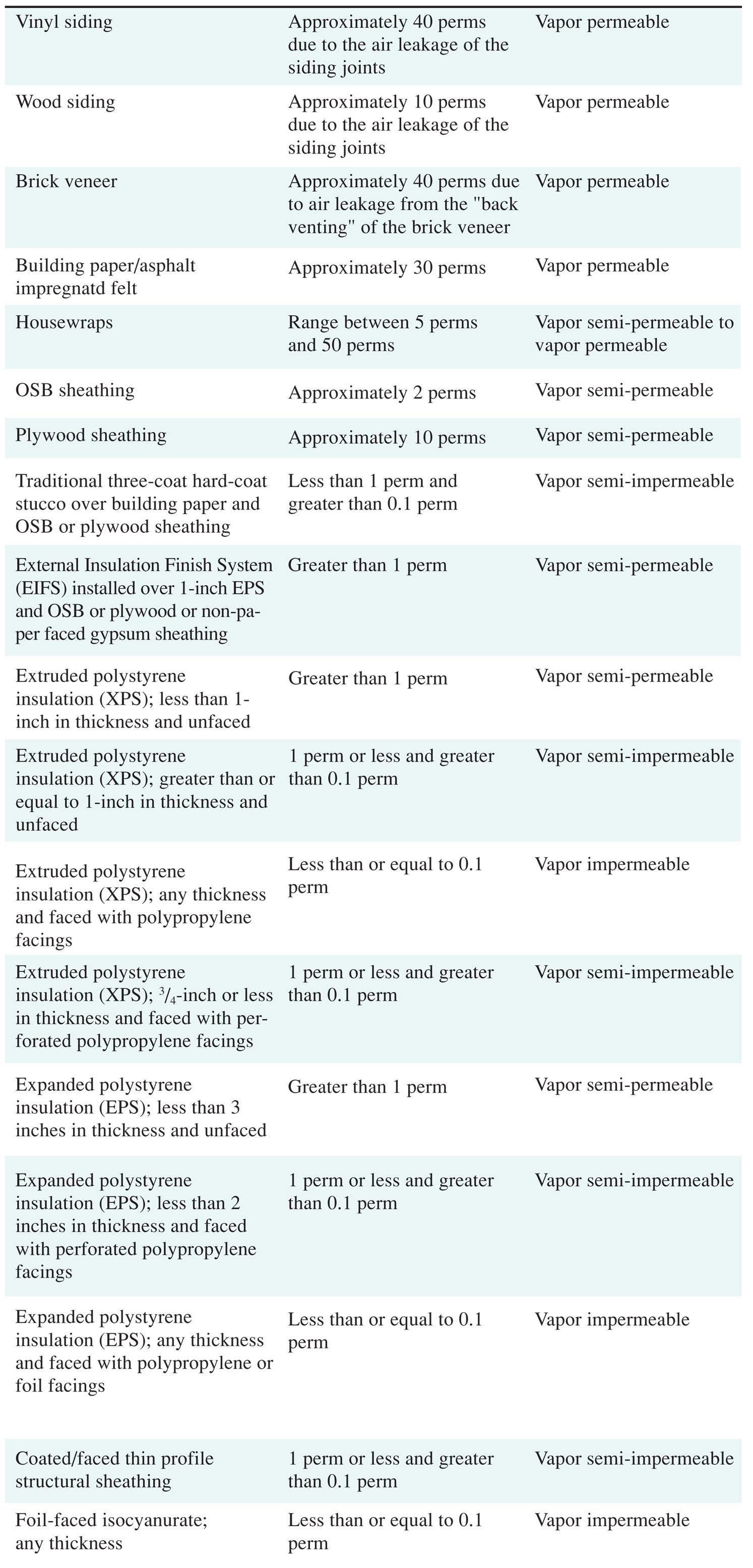

Maybe this post is in the wrong section, but I am trying to figure out if this works just fine or if it is going to give me problems: I am trying to build it in that way, because it is to my limited knowledge, fairly cheap, compared to staggering different insulation Materials and Insulating the Outside of the Building. Most of you on here who worked with Timber I-Beam construction opted for a thinner wall and to insulate on the outside . Which is great, just an extra step of work, but thats just my opinion. My main worry on this setup is condensation. Because the outer layer of OSB, even when left untaped is not very Vapour permeable : So following this logic, there could be a problem with condensation on the backside(looking from inside - outside) of the OSB sheets, as there is always going to be inperfections in the inner Airtight layer and Moisture going to get into the Insualtion . Am I overcomplicating this or is that something that needs to be addressed?
