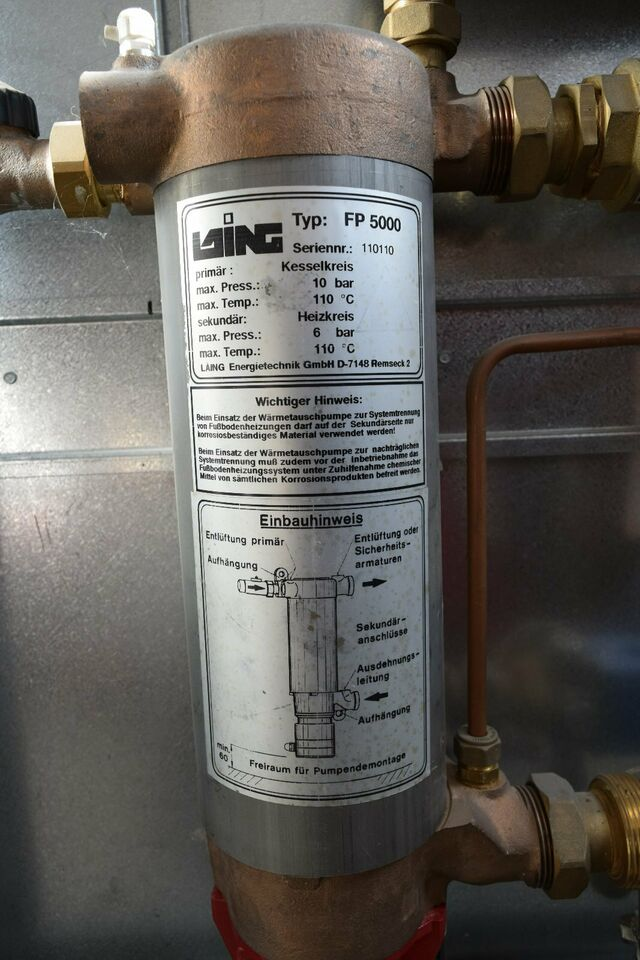

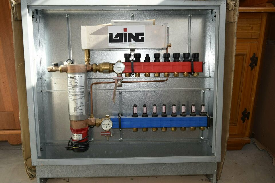

Hello, maybe some of the educated people on here are able to shed some light onto this purchase. As the Foundation is progressing, I needed a manifold for the UFH system. To have that in place before the screed goes down. So i looked on ebay , and found that loads are coming from Germany . Thought I skip the importers and just order directly. Had a quick look on German Gumtree as well and found a cheap offer for a Manifold including a LAING FP5000 Heat exchange pump(At least thats what it translates as), pickup only but next to mums town, so she quickly done me that favour. Looks like this: The Label says: TYPE: FP5000 Serial No.: 110110 primary: boiler circle max pressure: 10 bar max. Temp : 110deg secondary : heating circuit max pressure : 6 bar max. Temp : 110deg Laing was bought by Xylem and so the Laing pumps are not produced anymore My technical knowledge in regards to heating system is fairly limited and I am struggling even more with translating between German/English terminology. There is only a German manual (http://www.bosy-online.de/Systemtrennung/Laing_Systemanbindung.pdf ). I can read it , but it s telling me nothing tbh. The tricky bit is that I am fluent in German, but never worked anything to do with construction or anything technical at all over there. Now I do, but all i learned in the years between is the English terminology. Maybe someone is able to tell me what kind of pump this is. Because it says it is a heat exchange pump with it s own separate 6kw heater , which I didnt come across yet (again, what do i know) I mainly bought the item for the manifold . The rest really was just a bonus. The seller bought it around 18years ago and never installed it (rich farmer) and now just wanted to tidy his garages . Said he paid 1000£ for it , so it might be worth installing the pump as well. Any opinions on it?
