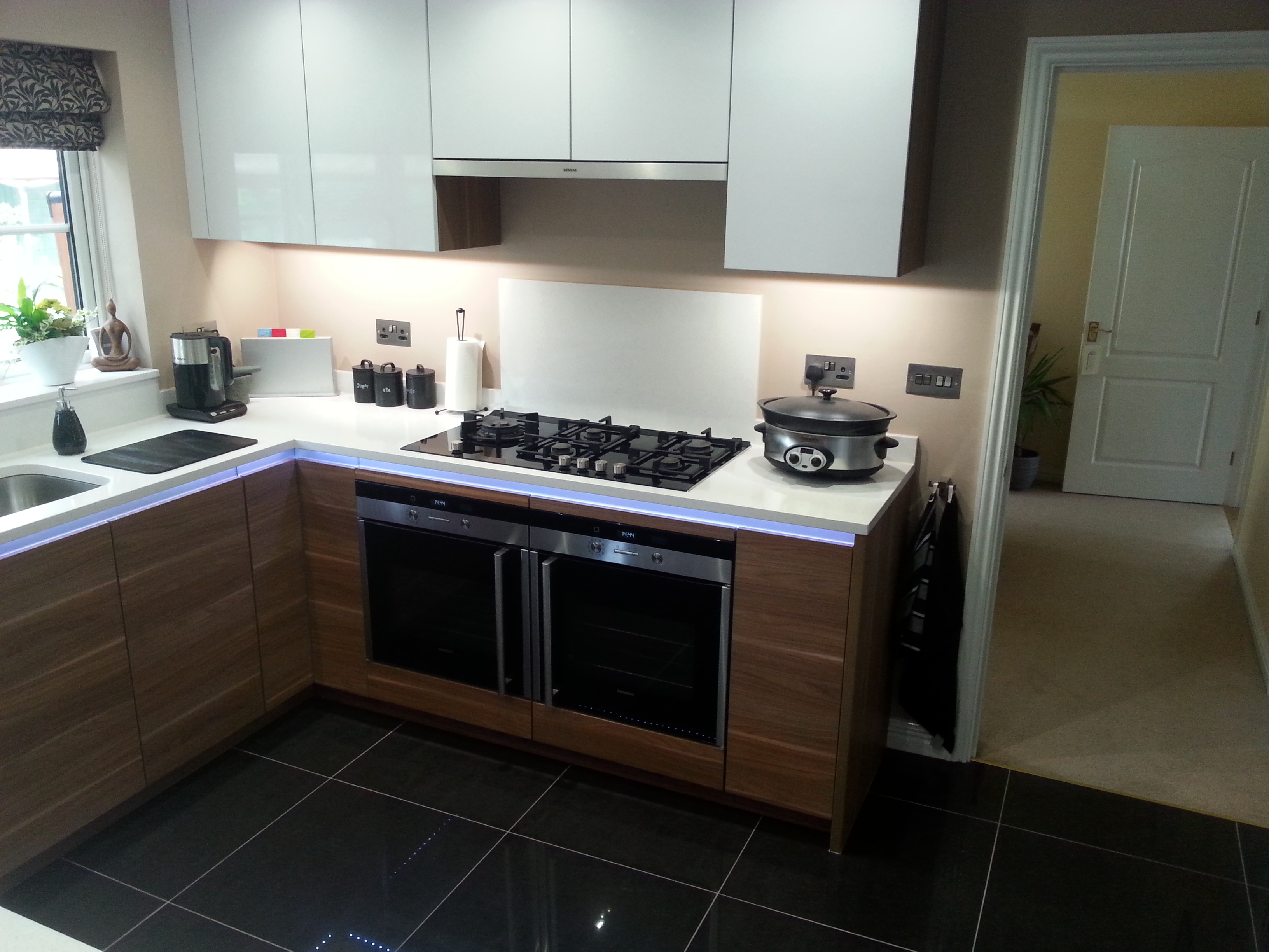

  4. I didnt think Alno did oven housings with the rails in them. How about this (not Alno)?
