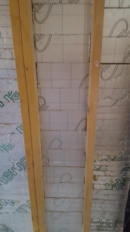

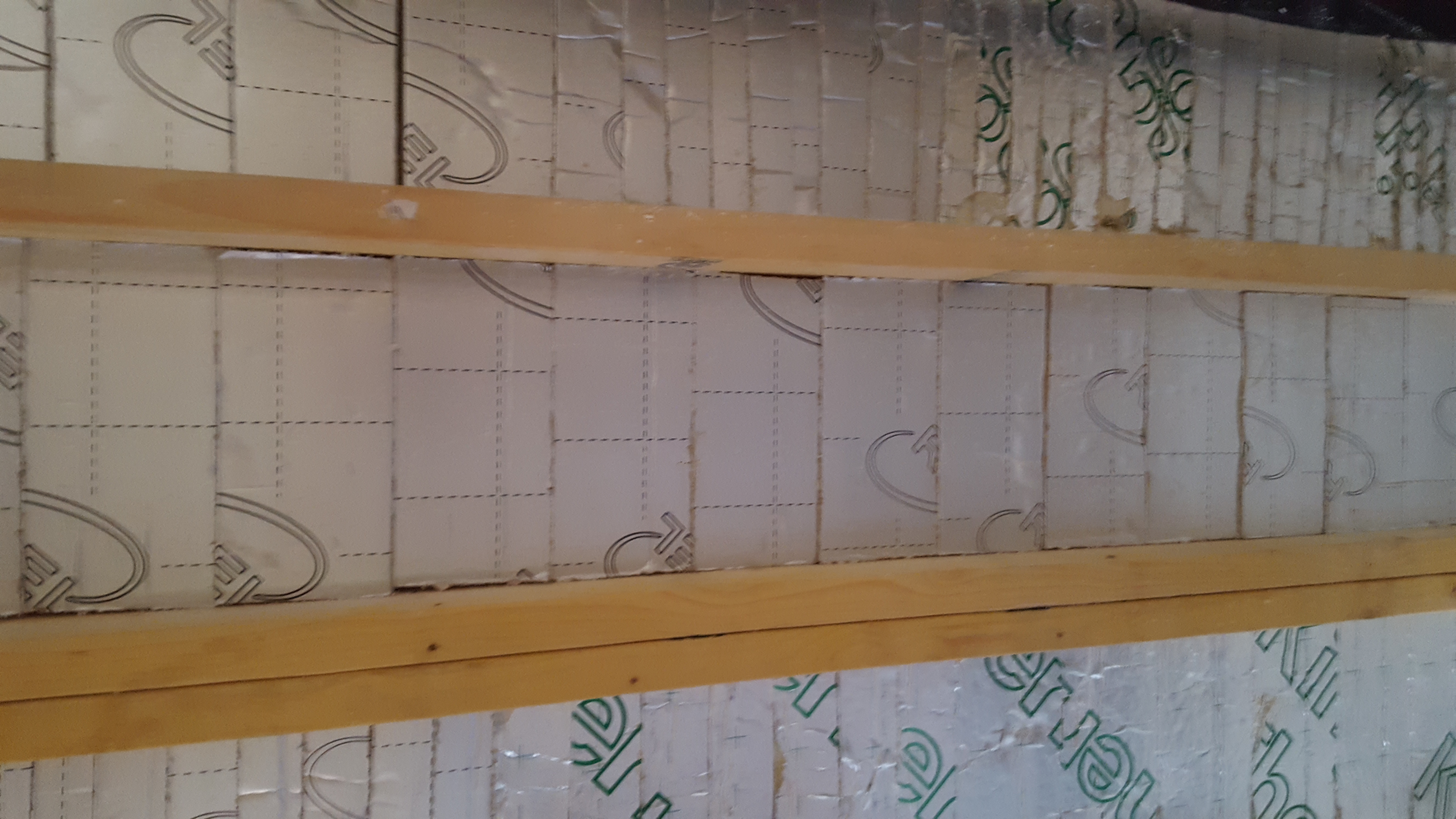

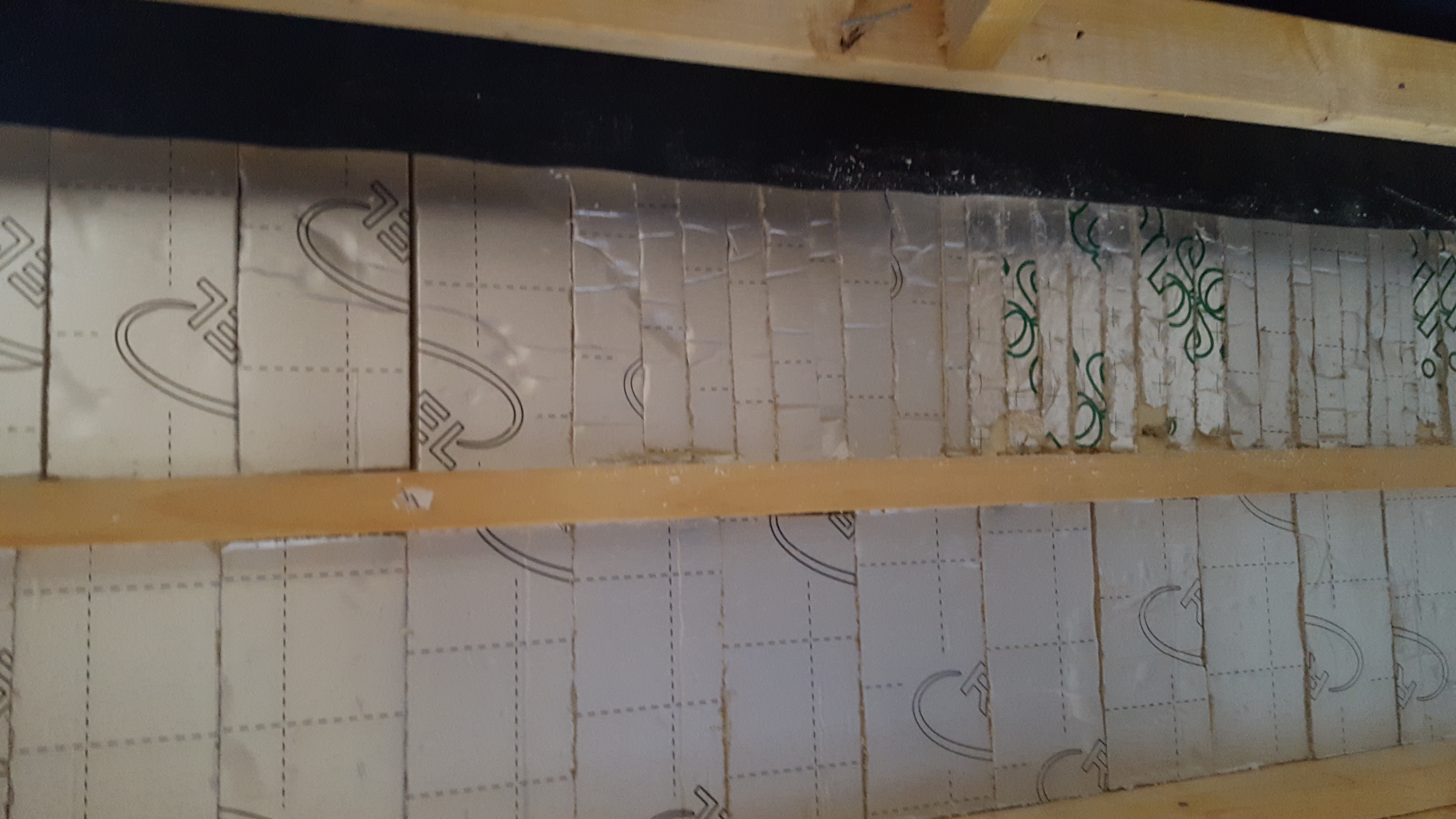

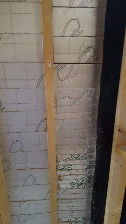

  1. Thing is, no matter how finely its cut and butted, multiple pieces are not the same as 1 piece and a stack of 30 pieces is never going to perform as well as a single piece, leave alone one made from 3 or 4 offcuts. I hadnt paid any attention to the use of mixed brands but thats a good point that will need addressing too. Appreciate its not going to landfill but at the risk of being called a nimby, 'not in my house'. Very disappointed.
  2. Thanksfor your replies. I have seen this in only 1 room. The insulation is two sheets of 70mm PIR and most places (5) where the inner layer was visible was in this state. There may be more but i didn't have time to check today. I will be asking all secondary layers to be stripped back to inspect, something I wasn't expecting to do. I will obviously report tomorrow. My concern lies around the fact that i have uncovered this and I wonder what else lies hidden.
  3. So I visited site today and found this. This is one of two layer of PIR insulation being fitted between timber studs. The height between studs is around 2.6m so it is inevitable that there is atleast one join and perhaps sections where 3 or 4 pieces make up the insulation but 20-25 pieces doesnt sit well with me. Your thoughts?
