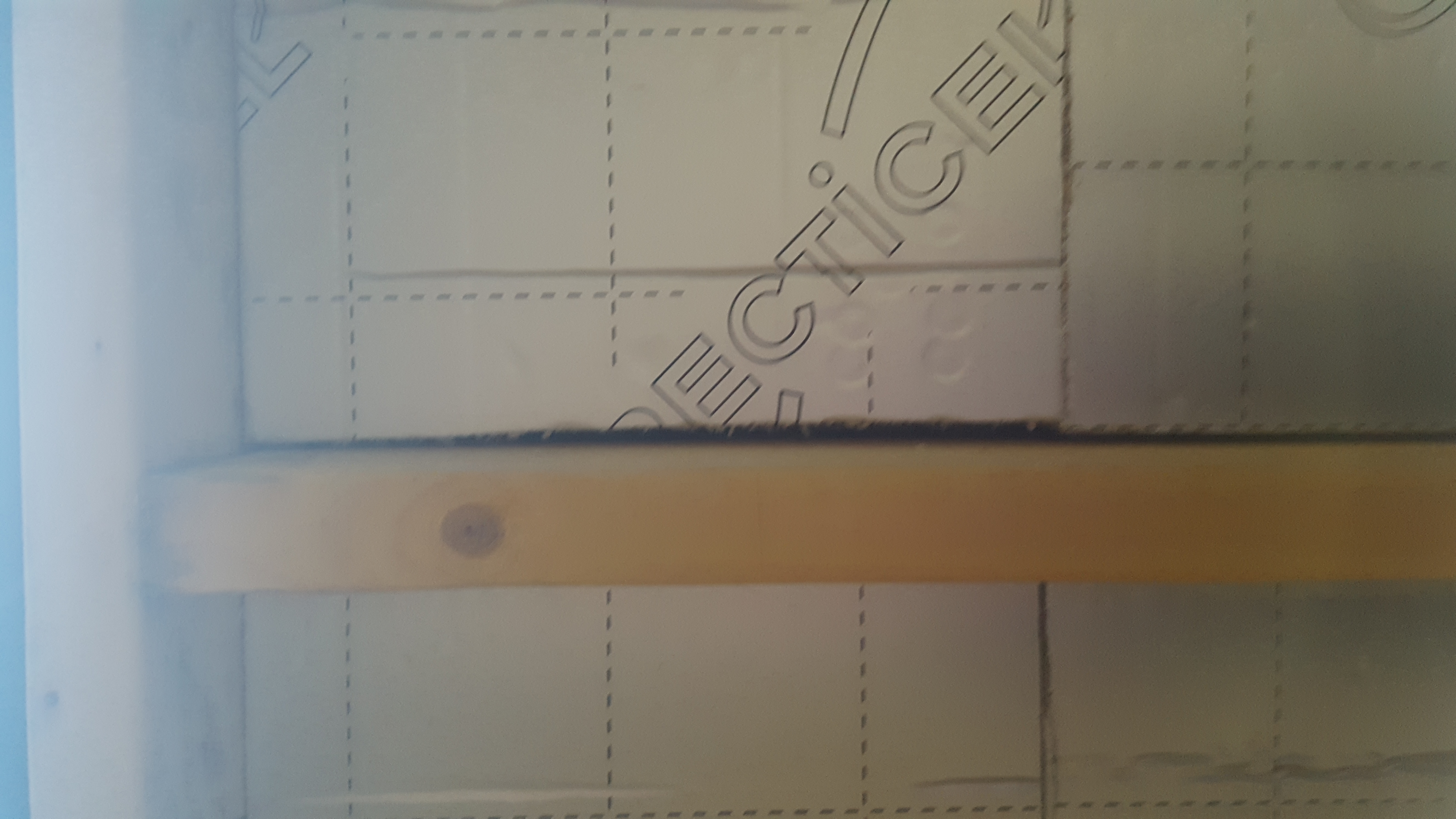

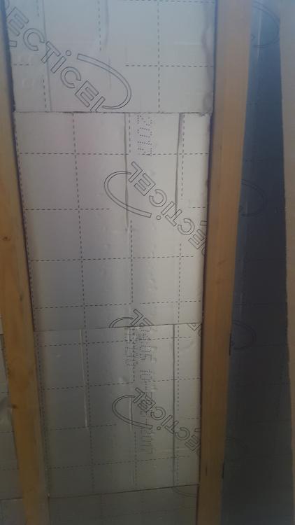

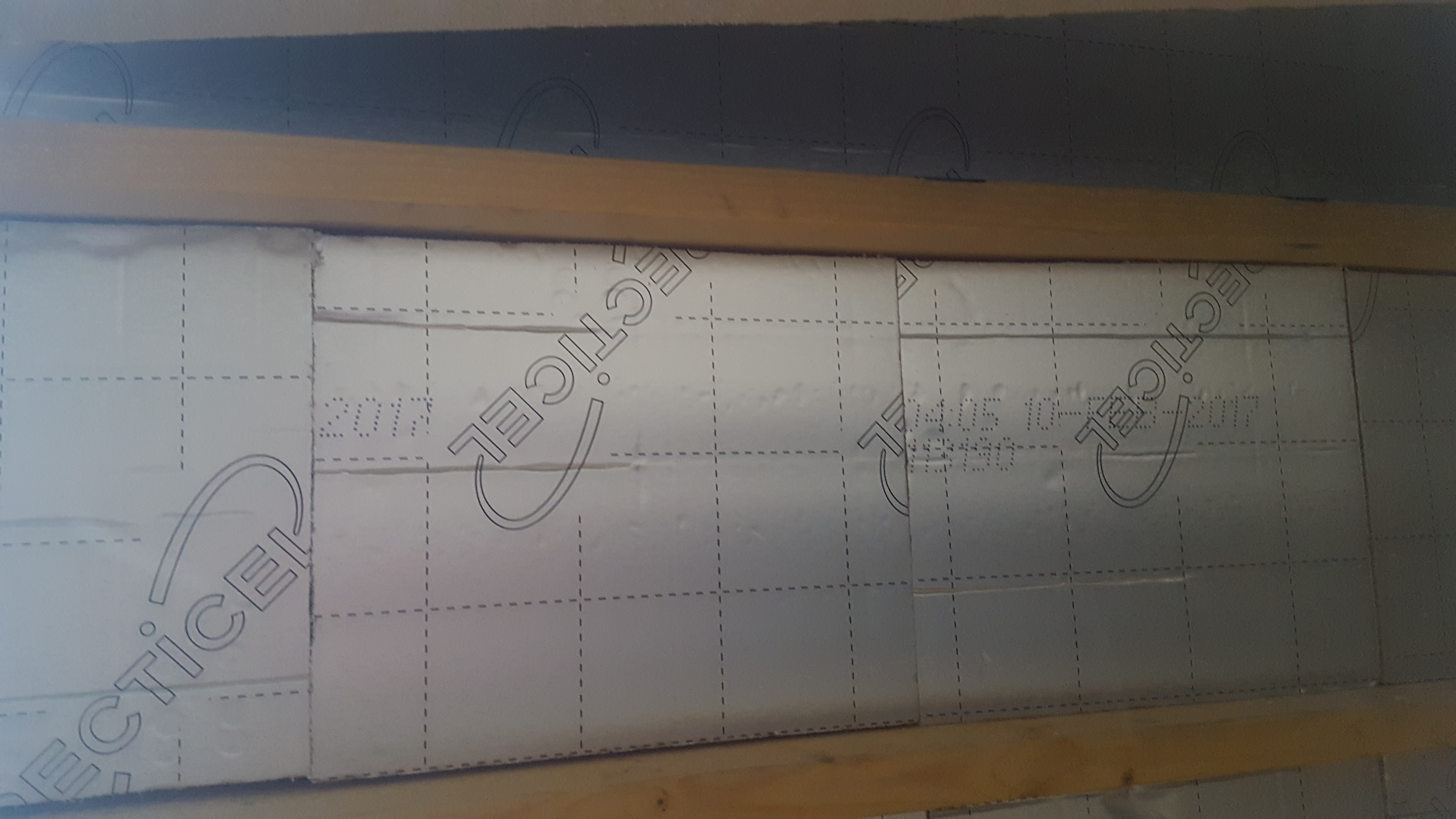

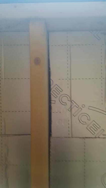

I have attached two more photos showing rather large gaps (as much as 8-10mm) which I assume are not acceptable either? The proposal was to foam fill them. Is that acceptable or should every piece be carefully measured and cut to suit? I am so glad I notice the original bodge. This has opened another can of worms.

Granted that blown cellulose will most likely eliminate any voids but there is surely a proper way to fit PIR insulation.
