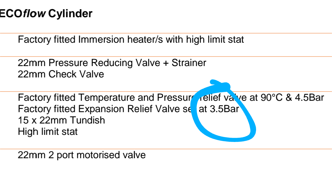

  1. Nope. Cylinder manufacturer's instructions say this is supplied with a 3.5 bar PRV: (The guy was a complete monkey though. Installed the water softener isolation valves the wrong way around, so you wouldn't have been able to isolate the unit. I sorted it was wrong the second a looked at it. He failed to screw the waste trap onto its fitting when he was done, which I only learned about several months later when I found mould growing behind the tank. And the pipework he assembled for the water softener was crooked and put a lot of sidewards force onto some of the fittings. And my wife wonders why I don't just get trades in to do things that need doing around the house!)
  2. Incidentally, this is the same setup as Altecnic (possibly rebadged? I know McDonald and another manufacturer sell exactly the same cylinder we bought from them):
  3. There's no control group as such. There's a pressure reducing valve on the incoming main. It's a bit hard to get to and I can't remember the pressure it's set at, but possibly 3 bar? Our static water pressure is typically around 2.8-3 bar I think. There's no pressure relief valve at that point. I'd be happy to use this opportunity to rejig the whole setup tbh. The dynamic water pressure's always been a bit shite, probably at least partly due to the pressure drop across the water softener. There's been the odd weep from a couple of the connections that I want to sort out too.

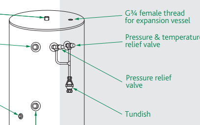

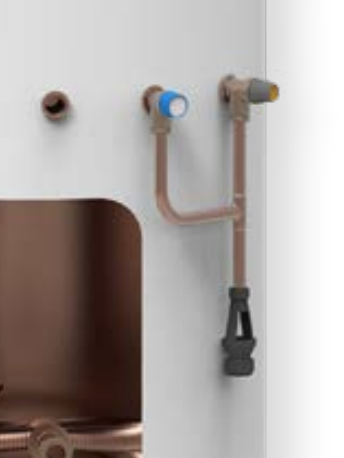

  4. It's on the cylinder. To save me going and taking a photo, this is how it came from the manufacturer (McDonald Cylinders): The one on the left is the PRV, which is what's failed. Interestingly, this diagram shows a light blue handle on the valve, which accords with the 107-series ("cold only", but rated to 110° C) Reliance valve I mentioned above.

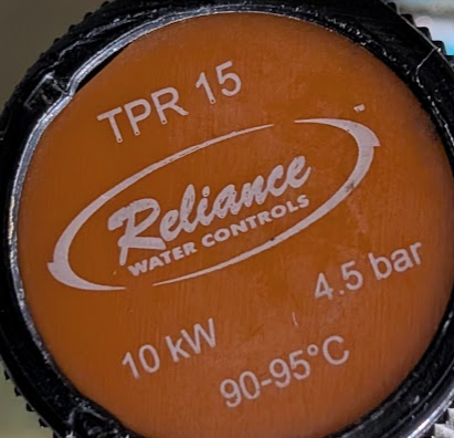

  5. Right, I've had a bit of time this morning to look more closely at this. It's actually the pressure relief valve that's failed. The 15 mm pipework from outlets of the PRV and the PTRV joins before the tundish (I assume that's acceptable?), so it isn't possible to tell which one's failed without disconnecting the pipework from the valve outlets. The failed valve is a Reliance 102-series 3.5 bar PRV. Apparently that's a "cold water only" valve. I think this was the valve originally supplied with the cylinder, but it's also possible I asked that it be replaced at the same time I had the TPRV replaced a few years back. Either way, it doesn't appear to be the correct valve for this application. Annoyingly, none of the Reliance valves designed for hot water systems come in a 3.5 bar variant. There's 107 series that is allegedly for "cold water use only", but it has a 110° max working temp. Shame I didn't realise what was going on yesterday or I could have given their technical department a call to see what the deal is there. On the assumption that I shouldn't increase to a 4 bar version, and a 3 bar version is too low given I'm already having issues with the 3.5 bar version, I may need to look elsewhere. Annoyingly, I can't see any obvious options with the same form factor, inlet fitting, and outlet fitting. If the Reliance 107 model mentioned above isn't suitable, it might be time to replace both valves with a different brand and adapt the outlet pipework to suit. Anyone have any thoughts?
  6. I'd need to check, but definitely nothing like 90 deg. The issue is that the immersion is quite low on the tank (the upper immersion died and I've never gotten around to replacing it). By the time that lower region of the tank gets hot enough to turn off the immersion, there's been a lot of time for the water at the top of the tank to get very hot due to convection. That was my thinking when I mentioned a destratification pump.
  7. Did it ~15 times aggressively but no luck. Any recommendations for an alternative brand? What's "big" in this context? It's a 22 L tank for a 250 L unvented cylinder. Minimum appears to be something like 4-5%, but rule of thumb is 10%, so it's above the minimum but a little short of the rule of thumb. The bladder on the original one died a few years ago, so I replaced it with a new one with a replaceable bladder. I'd ideally rather hang onto that than replace it again, although if it's important, I'm pretty sure I have the space for a larger one. Any brand you'd recommend?
  8. Thanks Nick. I tried that a few times earlier, but could try it a few more times and see what happens. No HRC circuit. I just checked and the expansion vessel had no pressure. Bah! So likely that, possibly made worse by the immersion diverter. I need to put a reminder in to check the pressure in the expansion vessel more regularly.
  9. The overtemperature/pressure valve on my pressurised DHW tank has started leaking (again). This is the model: My understanding it that it's a combined temp/pressure release valve (there's a separate 3.5 bar overpressure valve connected to the same tundish). I also remember reading that these types of valves have a tendency to leak after they've been triggered, or even after testing. This is the second time this one has failed. Last time, the bladder on the expansion vessel had failed without me realising, leading to higher than usual system pressure. However, I don't now whether that was the cause of the valve failure. Our static pressure is less than 3 bar, so I doubt the system has ever seen anything like 4.5 bar, even with the immersion diverter working. I wonder whether the immersion diverter is occasionally causing the temperature near the top of the tank to exceed the trigger temp for this valve? I recently installed the relay module on our Eddi immersion diverter, which will let me control the maximum temperature better. I also have a couple of spare pockets that I could use for something like a solar mixing pump, but I'd rather avoid any more complexity. So my questions: If you had to speculate, what do you think is the most likely source of failure? If it's likely to be temperature, are there brands of valve that are better at coping with being triggered and returning to closed without leaking? What is the most appropriate pressure for my expansion vessel? Anything else I should be thinking about? Thanks as always.
