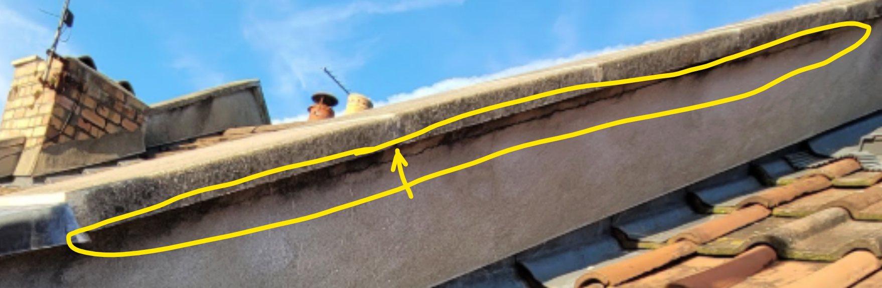

The massive crack circled in yellow would have me concerned: Even with a drip edge along the underside of the coping stones, there's a discontinuity at each join that could let water track away from the edge. The one at the yellow arrow seems particularly bad. Could you temporarily cover the render on your neighbour's side with some plastic sheet that goes right up under the coping stone overhang, ideally with a continuous bead of silicone to make sure water can't track through? That might let you at least rule out the neighbour's render.

Welcome. I'm certainly no specialist, but I'd start with the fact that the coping stones don't appear to have any sort of drip edge on them. If so, water will track underneath them to where they join the render. Any cracks/gaps at that joint will let in water. Re "Coping stones have dpc underneath them (protection from water ingress if coping stones were failing)", what does the DPC actually cover? If it's just the top of the wall under the coping stones, the water behind the render will find its way to the brick wall once it gets lower than the bottom of the DPC. Before rendering, the brickwork looked very "gappy". Any water getting though to the brickwork could take any number of paths downwards, including from one side of the wall to the other (e.g., it's possible water getting on on your neighbour's side could track to your side through a gap in the mortar). I'm sure someone more knowledgeable will be along shortly, but having dealt with a serious roof leak in the past, you have my sympathy!
