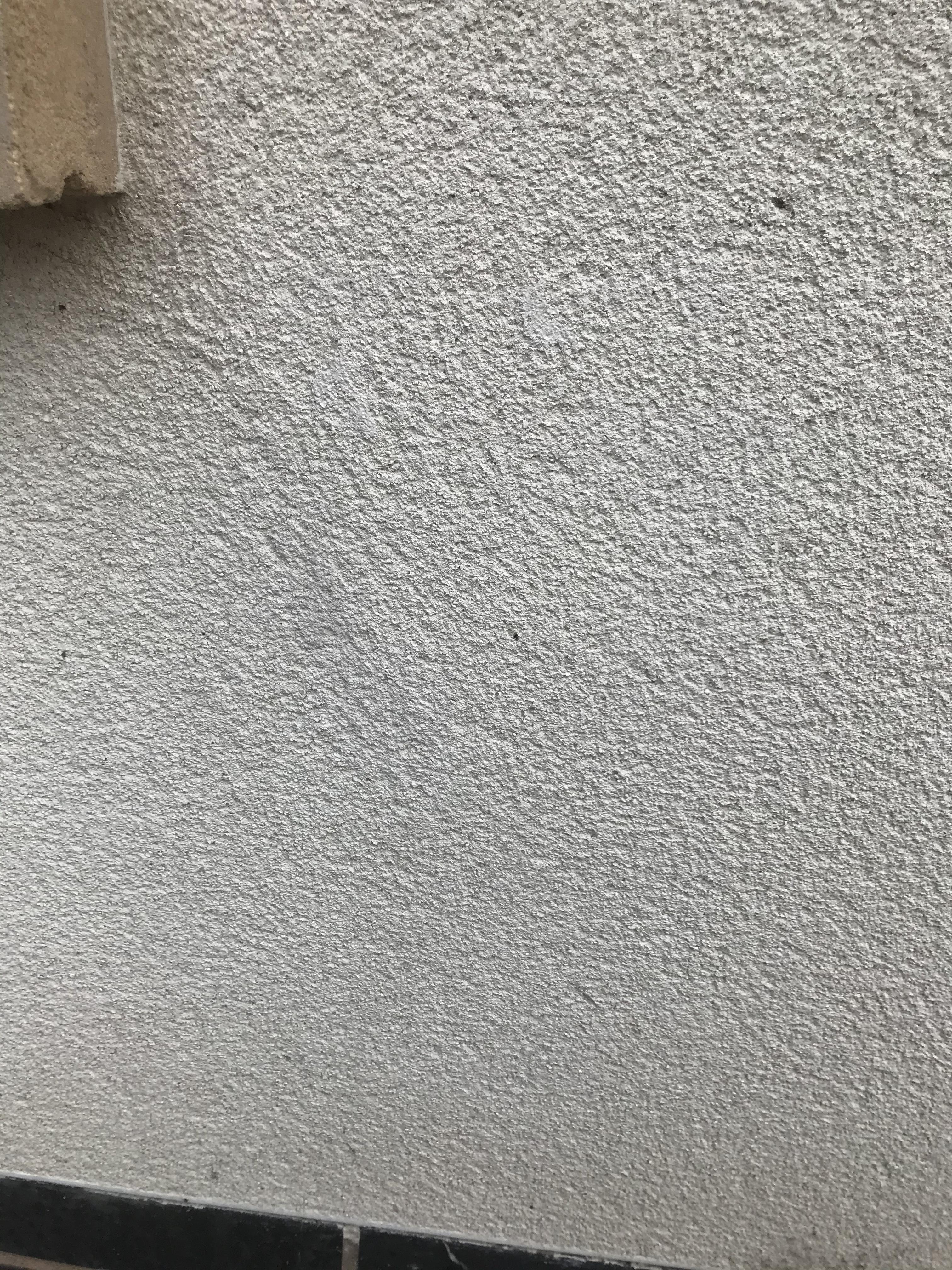

  20. I posted a couple of weeks ago John remarked that the repair was quite noticeable The homeowner has sent me a photo today While you can still faintly see the repair I don’t think you would notice if you didn’t know it was there Especially once we have had a bit of rain
