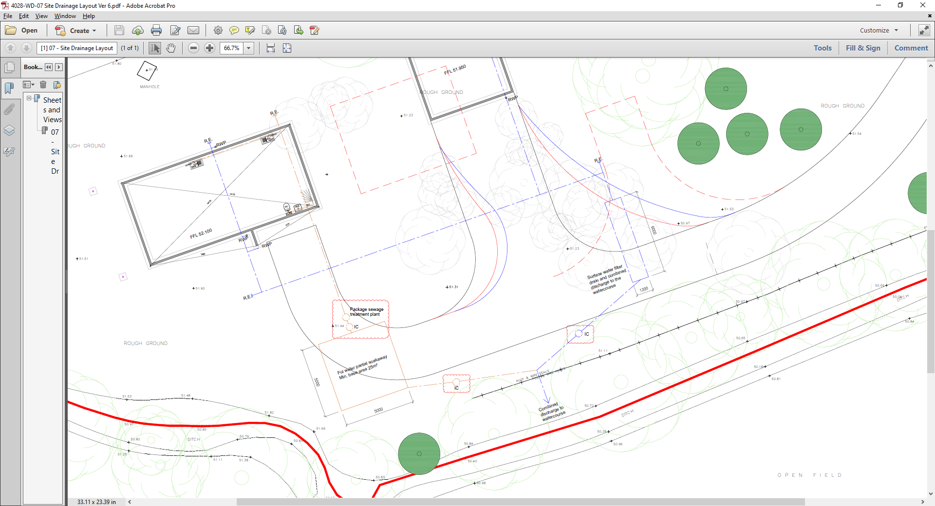

Sewage treatment plants
Ralph replied to Kerron Allen's topic in General Self Build & DIY Discussion
We are putting in a BioFicient 1. As you can see from the below the plan was for it to discharge to a partial soakaway which will in turn discharge to a stream. The surface water goes to a filter drain then also discharges into the stream. The question is do I actually need the partial soakaway? I've read that you don't for a treatment plant? As I'm in Scotland I looked up SEPA for guidance which refers to Code Of Practice Drainage Fields For The Disposal Of Effluent From Bs En 12566 Certified Packaged Wastewater Treatment Plants And Septic Tanks Df-V0.1-2020 at www.britishwater.co.uk This has confused me even more are it states: "The terms drainage field and soakaway are sometimes used interchangeably as if they are the same thing and perform the same function. They do not." Then reads: "Drainage fields, or soakaways in Scotland, are an important component of the wastewater treatment system" and further: "It is essential that as an owner of a Packaged Wastewater Treatment Plant or Septic Tank you do not inadvertently agree to have a soakaway installed, which should only be used with surface water, not with wastewater. " -
