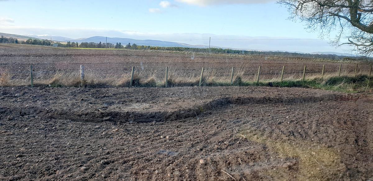

  4. That tractor and stoneburier is exactly what I'm looking for but that is an expensive hire. We have a lot of fruit and veg pickers around here, might well be worth finding out if they want some extra cash.
  5. The farmer could probably do some of it but we also have quite a bit already landscaped as in the picture with terraces and bunds as we have a flood issues with surface water coming off fields. I think a tractor with one of those big stone scanners would trash it. I was hoping there was something more like a rotavator size but can't find anything.
  6. We cleared and scraped much more ground that we thought we would and have ended up with quite a lot of bare soil. The quality of it is fine but I have noticed that we have a lot of stones, ranging from 5cm pebbles right up to 20cm+ rocks. Does anyone know of a small machine that could be hired to remove the stones? I don't fancy doing the 1,500 sqm by hand and the farmer's stone picker needs a tractor so is too big.

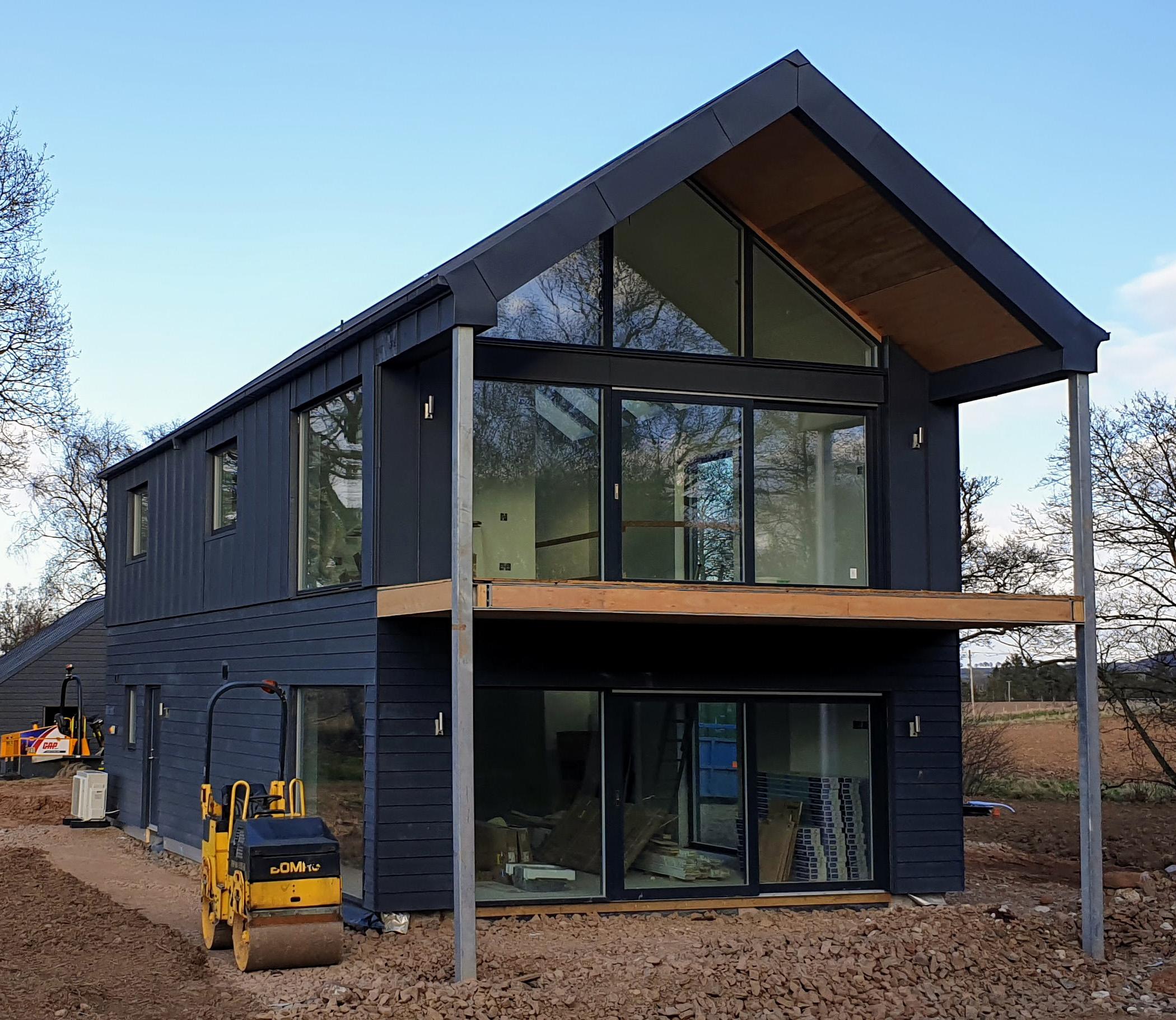

  18. It's a thought but I think we need them built out a little. The look a little spindly, especially where they meet the roof.
  19. Hello all, I'm trying to find a solution to clad the steel columns and the edge of the balcony below. The roofers previously said that the steel cladding was not suitable (not 100% sure why not) We were going to use aluminum soffit board from https://www.marleyalutec.co.uk/products/evoke-fascia-soffit/ which is rigid with a foam core but they don't seem to be able to supply us, it's always on back order. I've found this https://www.columncasing.co.uk/other-products/ but it's pricey. Any other thoughts form anyone? Thanks.

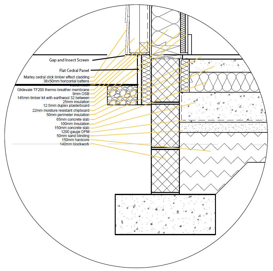

  22. HI I don't have any great detail photos, we're still working on it but this one shows the block work with and without the insulation. I'll take more at the weekend.
  23. We have blockwork out of the ground with the cladding sitting proud of it to there is a ventilation space behind the cladding (cladding is cedral rather than wood) . The exposed blockwork is then faced with PIR then a panel of the flat cedral board. But then we don't have a suspended floor.
