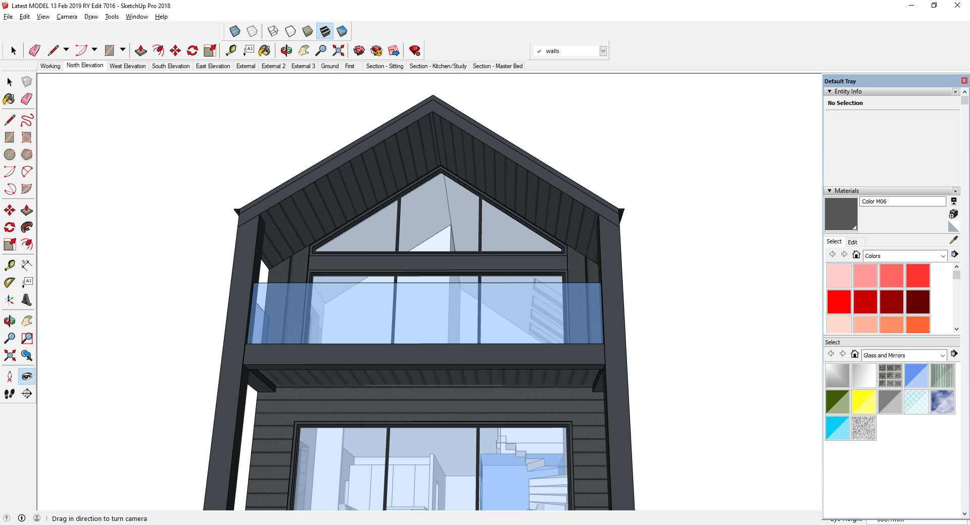

Yeah the planks are easy enough to find but the soffit board the use seems to be a bit harder. We're not sure if you can use the lapped planks on the underside. That may work, thanks very much.
That could be an option thanks. We liked the look of the lap, then we thought about click, then went back to the lap when we got quotes in for the click. I don't recall exactly what the price difference was but it was enough to put me off.
I like the idea of a contrasting colour however, as there is no other actual wood on the build I want to avoid it as it will weather and need maintenance.
Hi all, we have an extended gable to form a covered balcony and I'm at a bit of a loss as to what to use for the soffit/ceiling. The roof is standing seam down to he first floor level then lapped cedral on the ground floor. My joiner thinks that using lapped cedral may not work and has suggested plywood painted to match the roof. I'm a bit dubious on the plywood, I think it may look crap and the point of using cedral elsewhere was to be low maintenance. I know Cedral do a soffit material but I'm assuming the prices are going to be high for the kind of area we're looking at. We would also need something for the underside of the balcony. Any suggestions?
