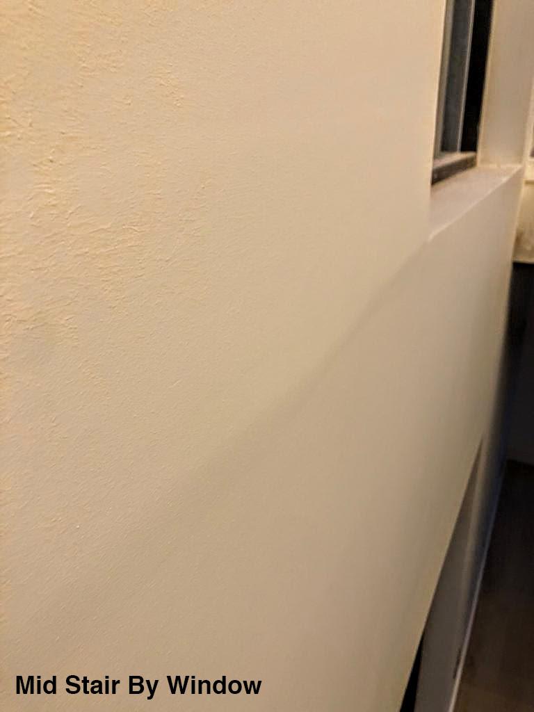

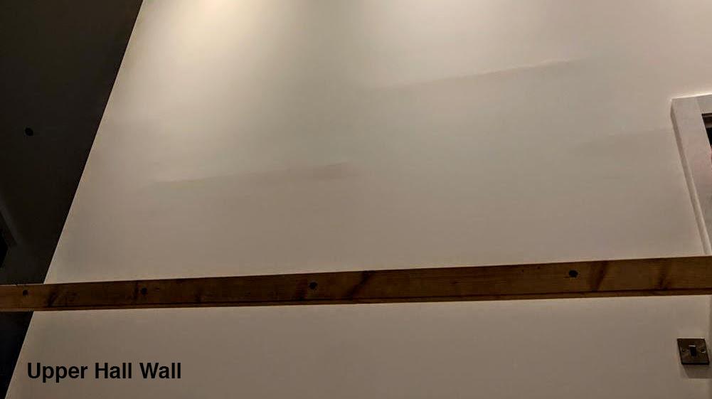

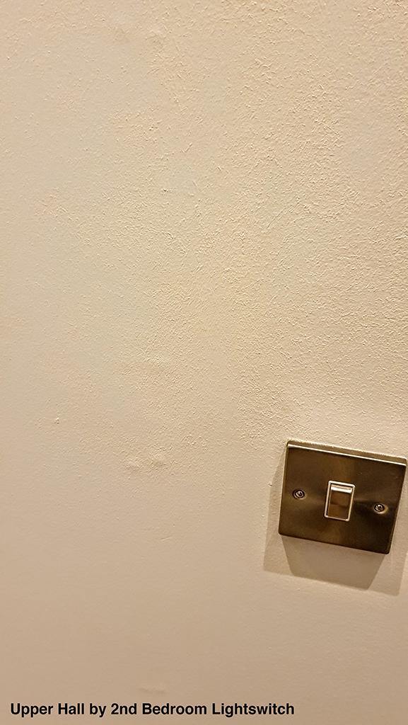

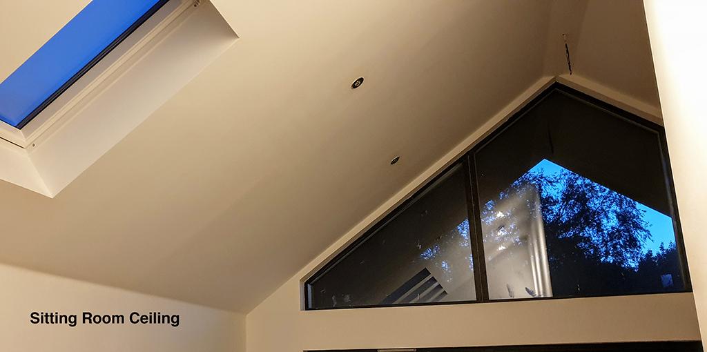

In Scotland taping seems to be more common on new builds than plastering. I have the tapers and painters coming out this weeks as I' m not happy with some of the taping and finishing. It's particularly noticeable at night when the lights are on. I'm no sure how they are going to be able to resolve them, any thoughts?
