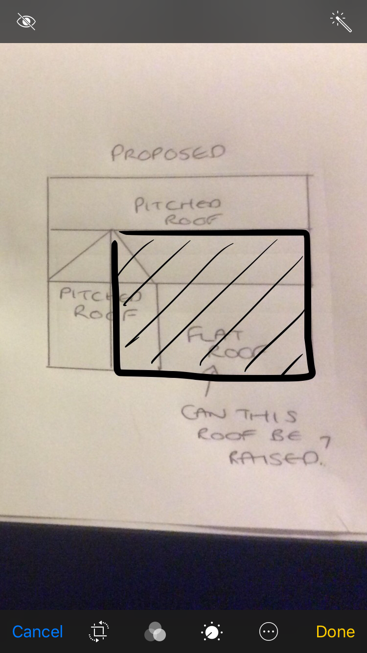

Or go crazy and have pitch at the top and at the left and have the square area as a flat room giving an area of high ceilings in the extension. I have a bungalow with high ceilings that slope from 2.4 to 3.6 metres high, marks an amazing different to the feel of the rooms. Or that area I've drawn could be sloped from the ridge to the bottom all the way across
My question is if you are adding pitched roof to the left side, why aren't you doing the same on the right? It may be wider so the pitch angle might not match, but is that really an issue?

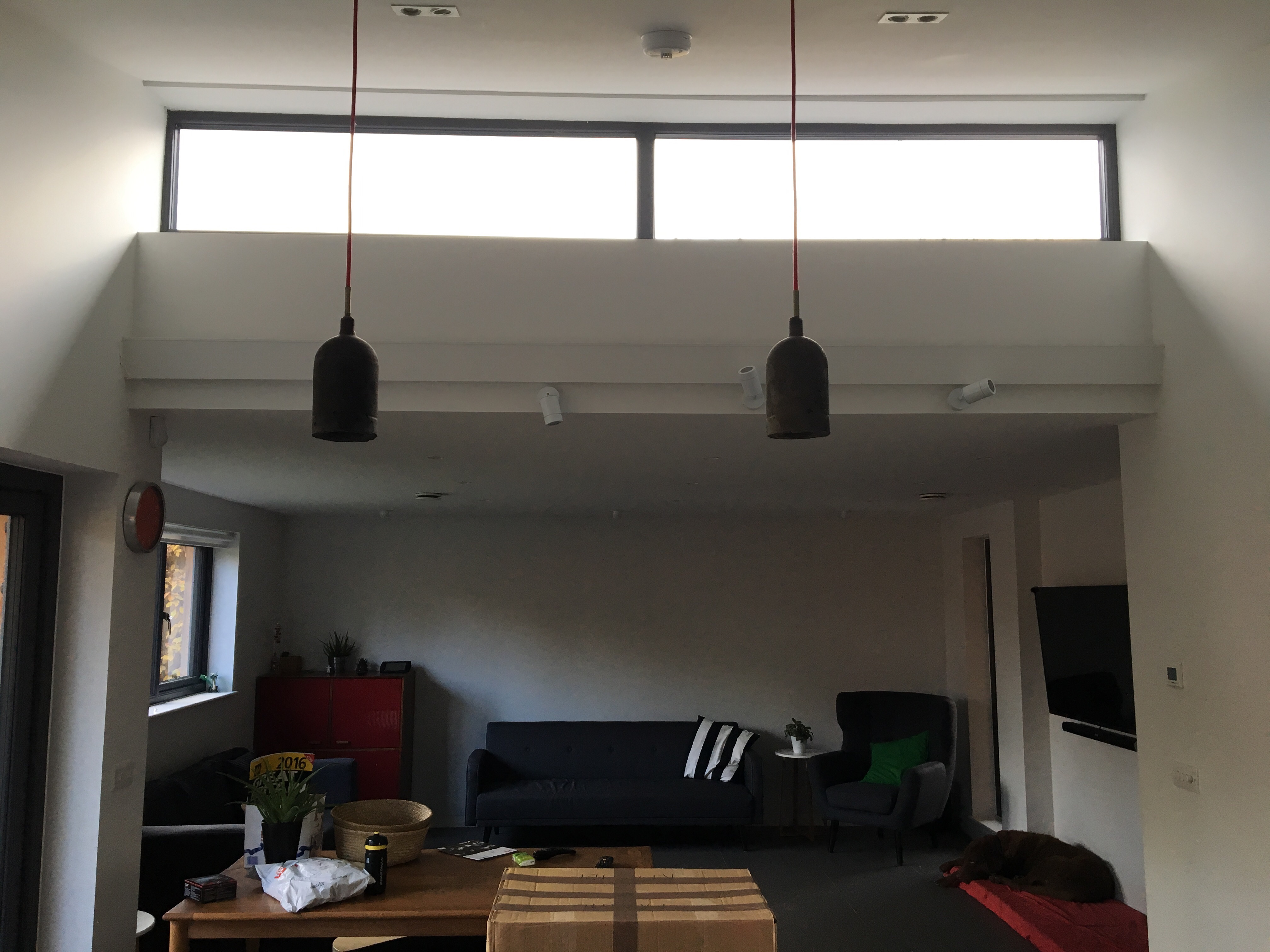

We have a small pitch as well, just did it with the joists and didn't worry about have a flat ceiling on the inside. But our element of flat roof is in the living room which is open to the steeper pitched roof kitchen. Will link to the post with the house pics in a bit
