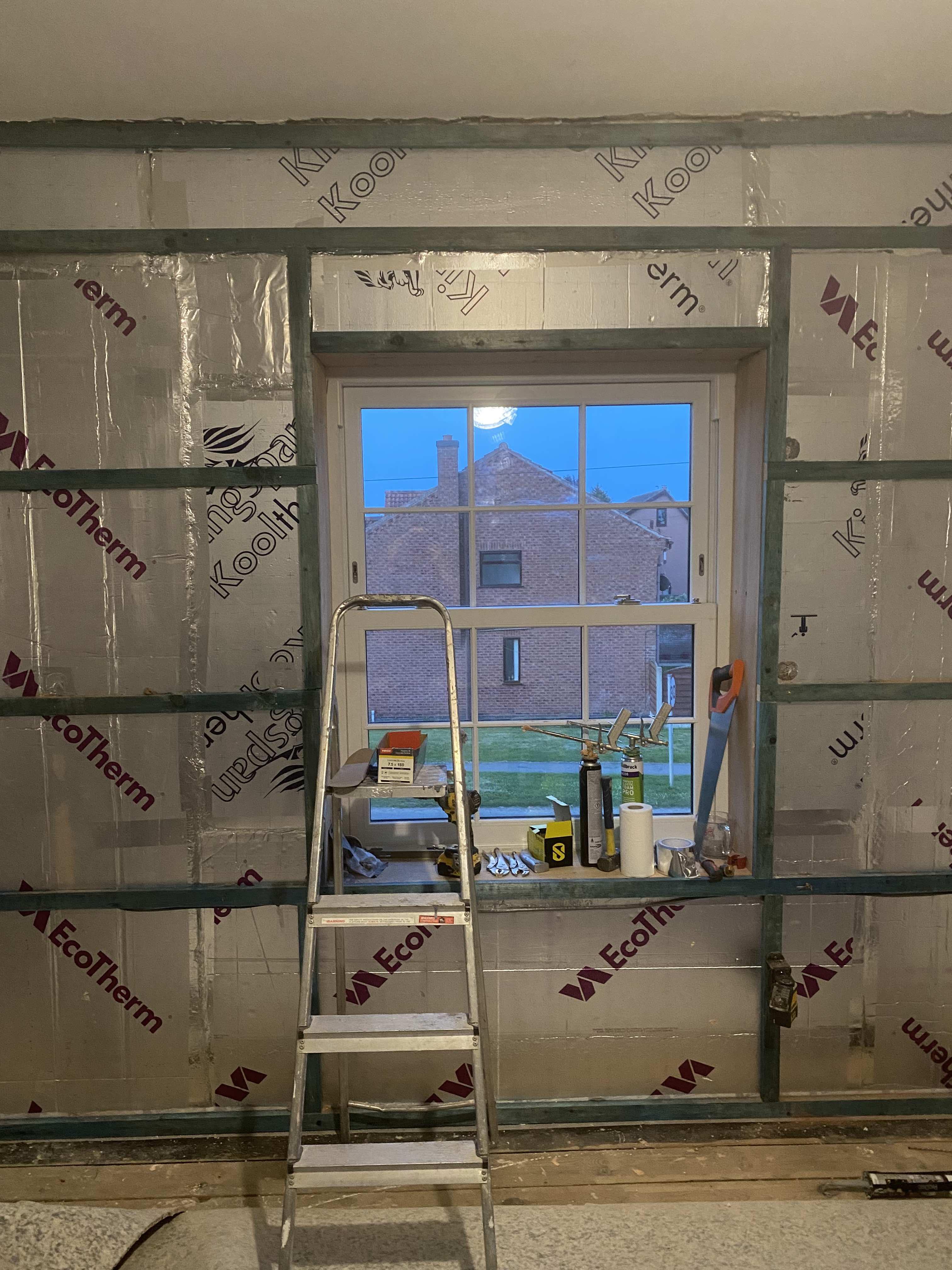

  3. Ladder's hiding the one of the left, but you can see the battens beneath the window that I was going to attach to.
  4. Battened out rooms using 2x1. Ran some in the correct locations for the radiator brackets. Radiators are Stelrad Compact K2 450x1400. Are 4x 5x40mm wood screws per bracket enough to hold?

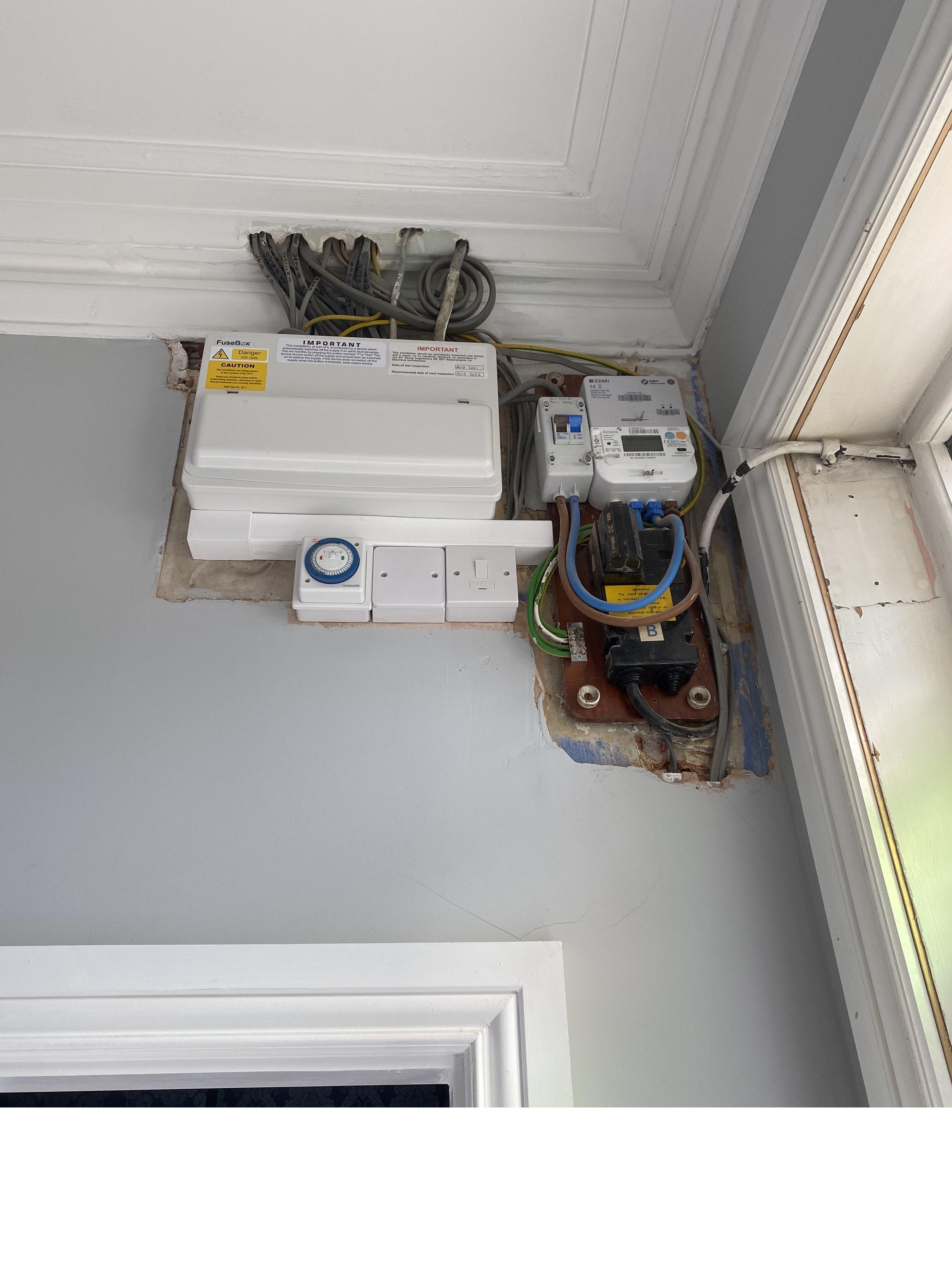

  6. Sounds expensive to me. My house is approx 250m2 and DIY cost is coming in at around £3,000 (minus room valves) For a house of your size, I'd seriously consider 2x units.

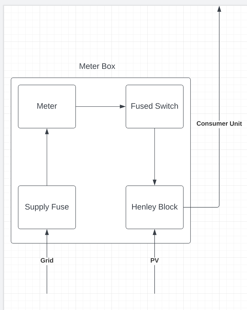

  10. My full time job is in Software Engineering, which is a really weird industry when it comes to pay; local companies pay pittance, but companies like Amazon have literally made some Software Engineers millionaires, forgetting about shares for a minute, some engineers on the West Coast of the USA are earning $350,000/yr +. Given the types of companies I have worked for in my career, I've genuinely seen a, nearly, 100x salary range. Mid-level jobs in the UK can still be pushing 6 figures today and there's been an effort recently to try push that down, but with the amount of venture capital money still sloshing around (it's still there, don't believe the media), it's very difficult. Supply and demand.
  11. Gas meter box is bang on where I'd want to install the new electric meter box. What's the min distance I can have between them? I've heard 150mm mentioned anecdotally, but can't find any concrete numbers.

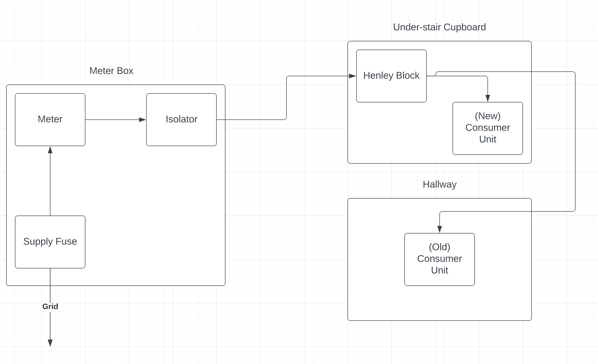

  12. Sparky also used our re-wire as part of his NICEIC assessment (are they annual?), so I'm guessing everything was above board.

  14. Any difference between that type and one of these https://www.directtradesupplies.co.uk/product.php/202439/fusebox-100a-fused-switch--63-80-100a-fuses---white-?gclid=CjwKCAjwpayjBhAnEiwA-7ena6XqoST4qKgfagJeZlUdreiAMRN2nKLLiU6uYCL59tDna5OvKB9ZIxoCcv0QAvD_BwE? I’ve put a cheeky offer in for a length of SWA on eBay, I owe my sparky some beers so that might be this weekends activities sorted out!
  15. I understand the sub-main needs to enter the electric box from either one of two holes on the right hand side; on the bottom or side of the box. Apart from that, are there any regs preventing the SWA going up the outside of the house and entering the property at the height of the first floor void?
