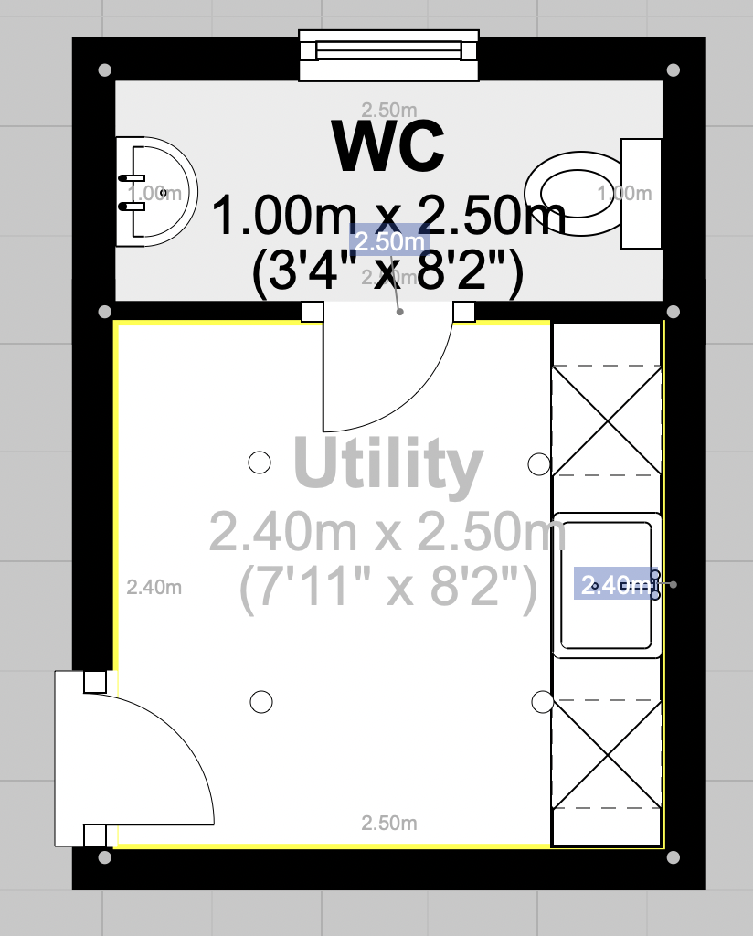

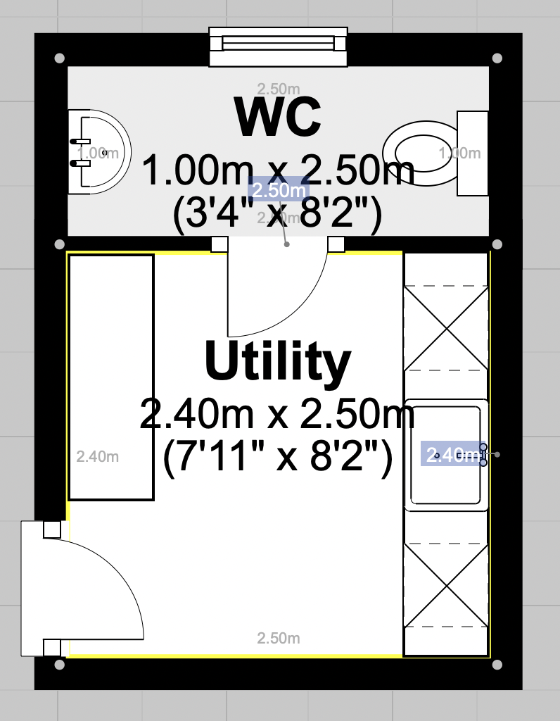

  5. We have a fairly small utility room, approx 2.4m x 2.4m. No natural light, so we'll have the lights on whenever we're in there. I'm thinking quite simple, 4x LED downlights. Should I just set them out as 2 banks of 2, evenly, or is there benefit to have them offset over worktops?

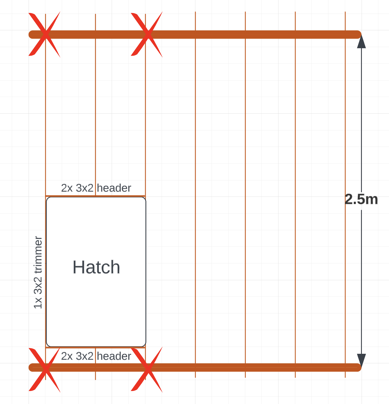

  17. When doubling up the joists, is that the full length; Not just between the new cross-members/headers?

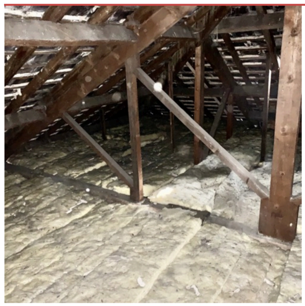

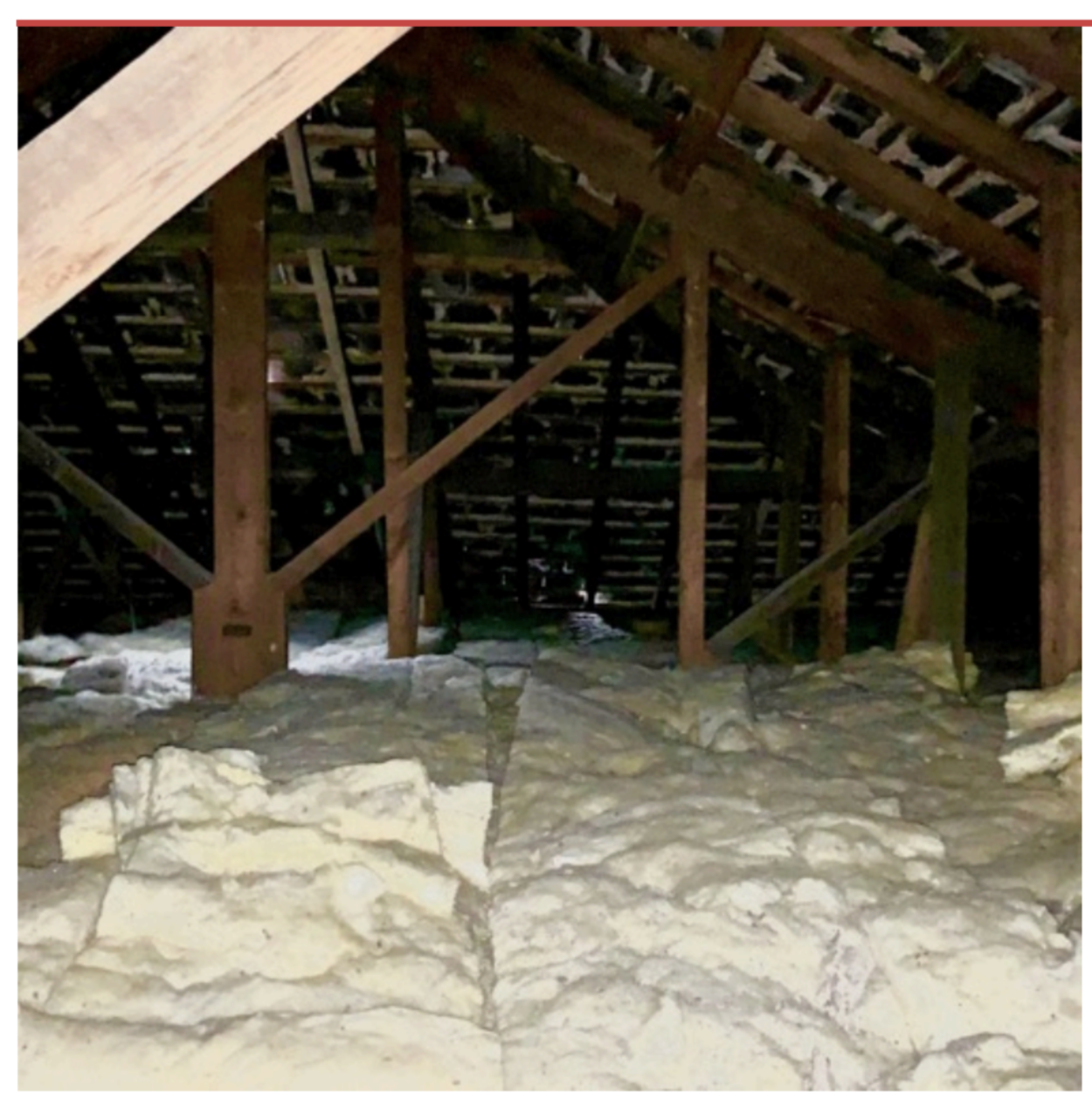

  18. We have a couple of king post trusses, these lengths of 3x2 are attached to the bottom of those, they're basically only holding up the lath/plaster ceilings below. I don't believe they're structural at all. You can see the bottom cord of the trusses here, and the 3x2s are below them, buried in the insulation. I'll strip all the insulation back and take a proper picture of the area I'd need to cut open over the weekend.

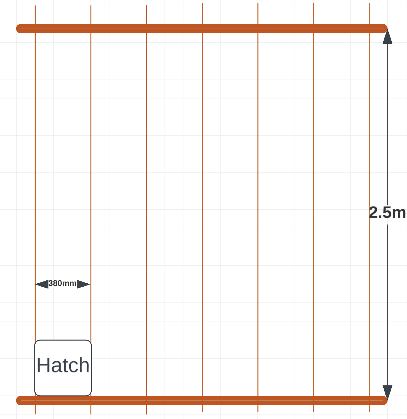

  24. We currently have a tiny loft hatch, approx 350 x 350mm (it's tiny), which sits between ceiling joists at 15" centres (380mm). The joists themselves look to be 3x2. I need to make it larger, if only to get the MVHR into the loft! I'm thinking the Dolle hatch + ladders are the best bang for buck - https://www.dolle-uk.co.uk/shop/loft-ladders-clickfix-76g - they come in 55cm and 70cm widths. 70cm would be preferred, the distance between 3x joists is 76.5cm which would mean I'd have 6.5cm to pack out between the hatch frame and the next joist, so I think I'd need a 3x2 double header on each end and a 3x2 trimmer to help pack it out, like this; Am I on the right tracks here?
