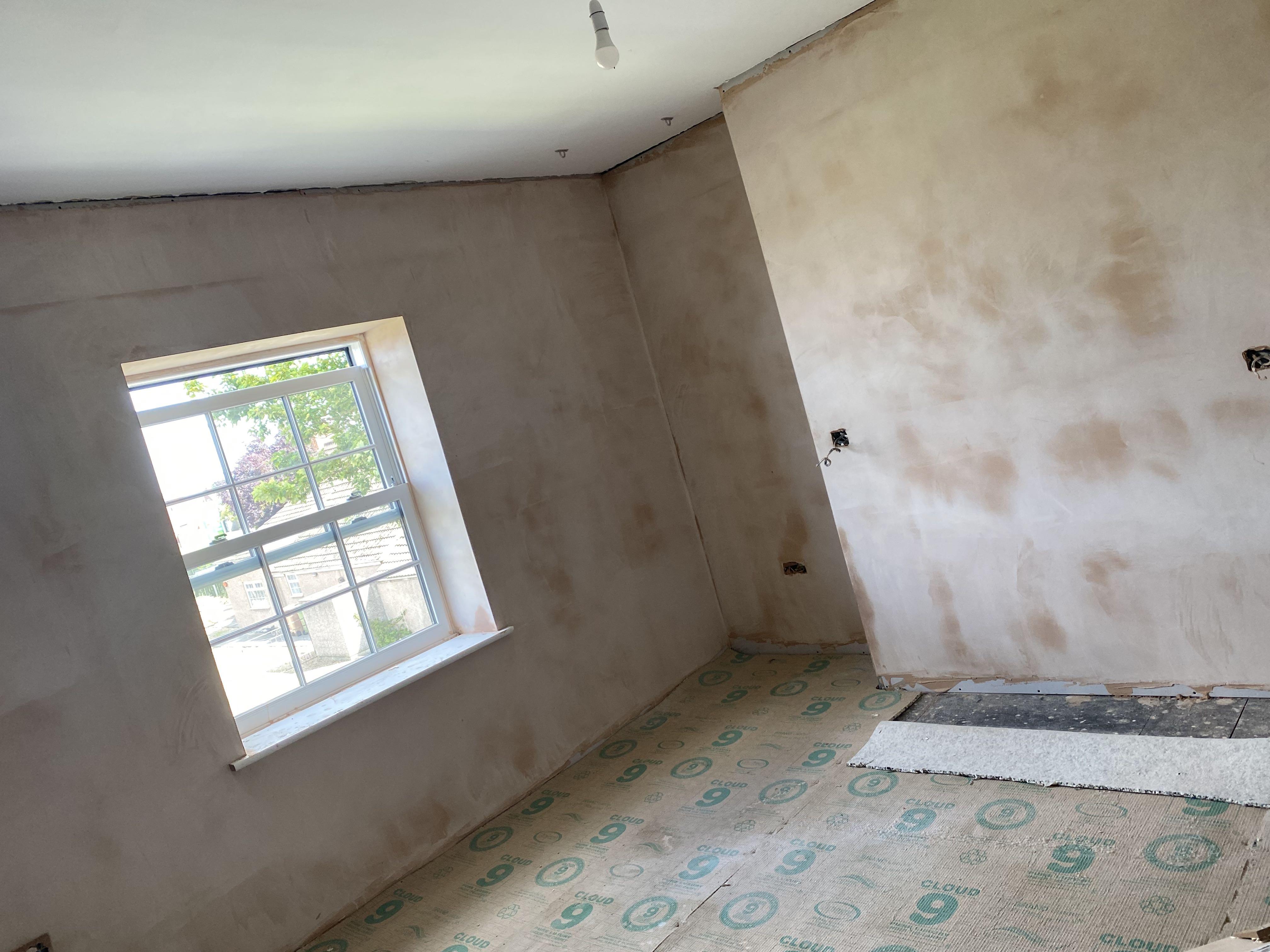

  16. That's my understanding too, but guidance online suggests anything between 4 and 14 days, not 48 hours. This is what ours currently looks like;
  17. Had a room skimmed yesterday, guy finished around lunch time and it's drying incredibly fast, it's pretty much turned a light pink already, just 24 hours later. We've had a couple of windows open to encourage a through draught and it's been pretty warm here - approx. 25c. Is it drying so fast OK? And, if it's entirely light pink tomorrow, I think it will be, only a couple of corners still dark as I type this, can I crack on and mist coat it?
