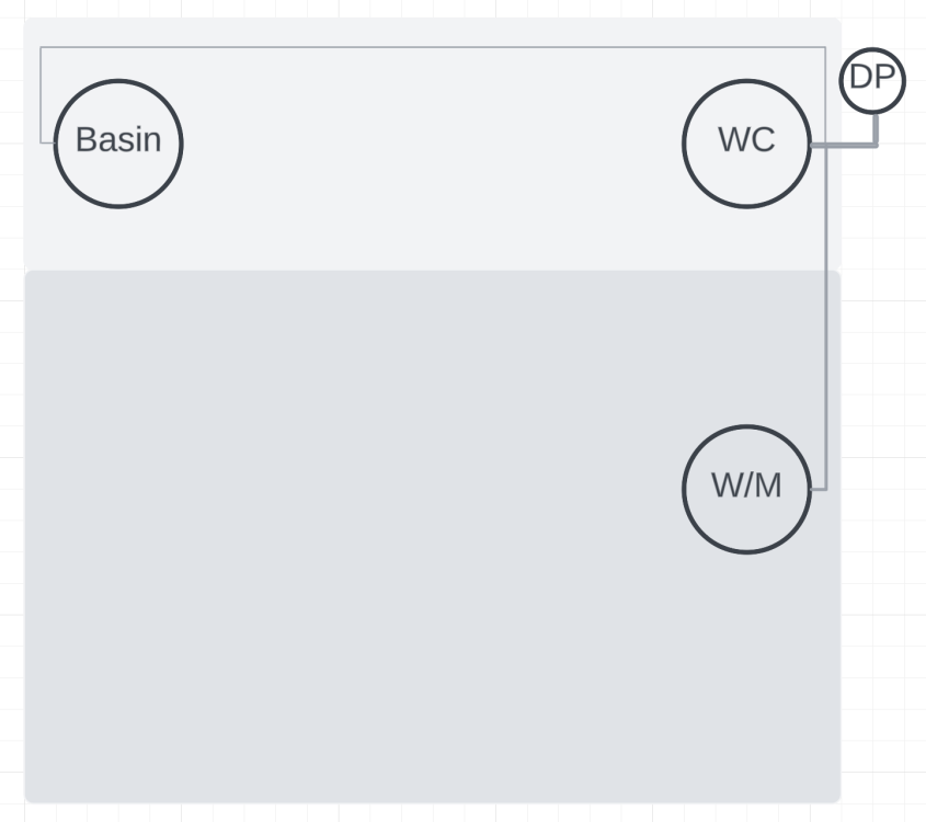

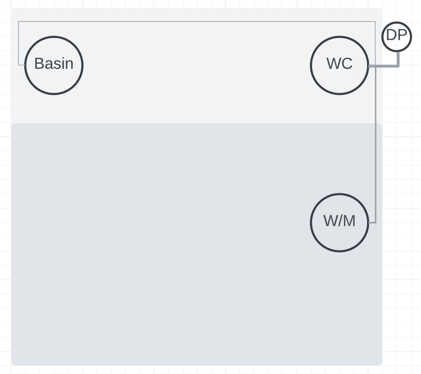

  17. So here's my plan of attack; 2x rooms; utility and W/C 32mm from basin waste 40mm from utility washing machine and sink 110mm from W/C SVP is directly behind the W/C location, so a straight run out the wall with a 92.5 degree elbow + branch should work fine there 2x boss straps on the 110mm on the internal side of the wall, one with a 32mm adapter and the other with a 40mm adapter, for the other basin/utility waste to connect to Utility waste to be hidden behind units Basin waste to be boxed in. Seems logical to me, does it make sense to everyone else? Is there anything I've missed?

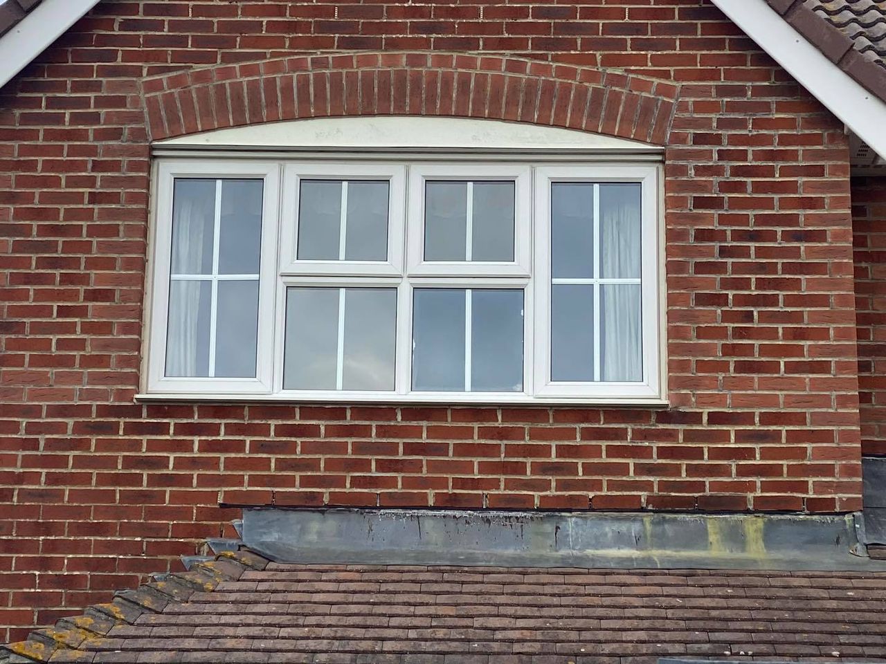

  19. Yeah. There's a wood lintel behind the arch course, so I plan on filling that void with PU foam prior to sticking the trim on. I just need to know what I should be asking for.
  20. What should I be asking for? Trim above window for an brick-arched opening?
  21. I'm no good with technical terms, I'm sure there was a shorter topic title to be had! I have a couple of windows that don't have any structural lintels, but the bricks are on ends and arched across the top of them, supporting themselves. This kind of thing; I'm going to replace them, but the windows I'll be fitting are square, I need a bit of trim that I can cut to follow the curve of the arch as an infill. Anyone know what these are called and what the best way of cutting them to follow the curve is?
