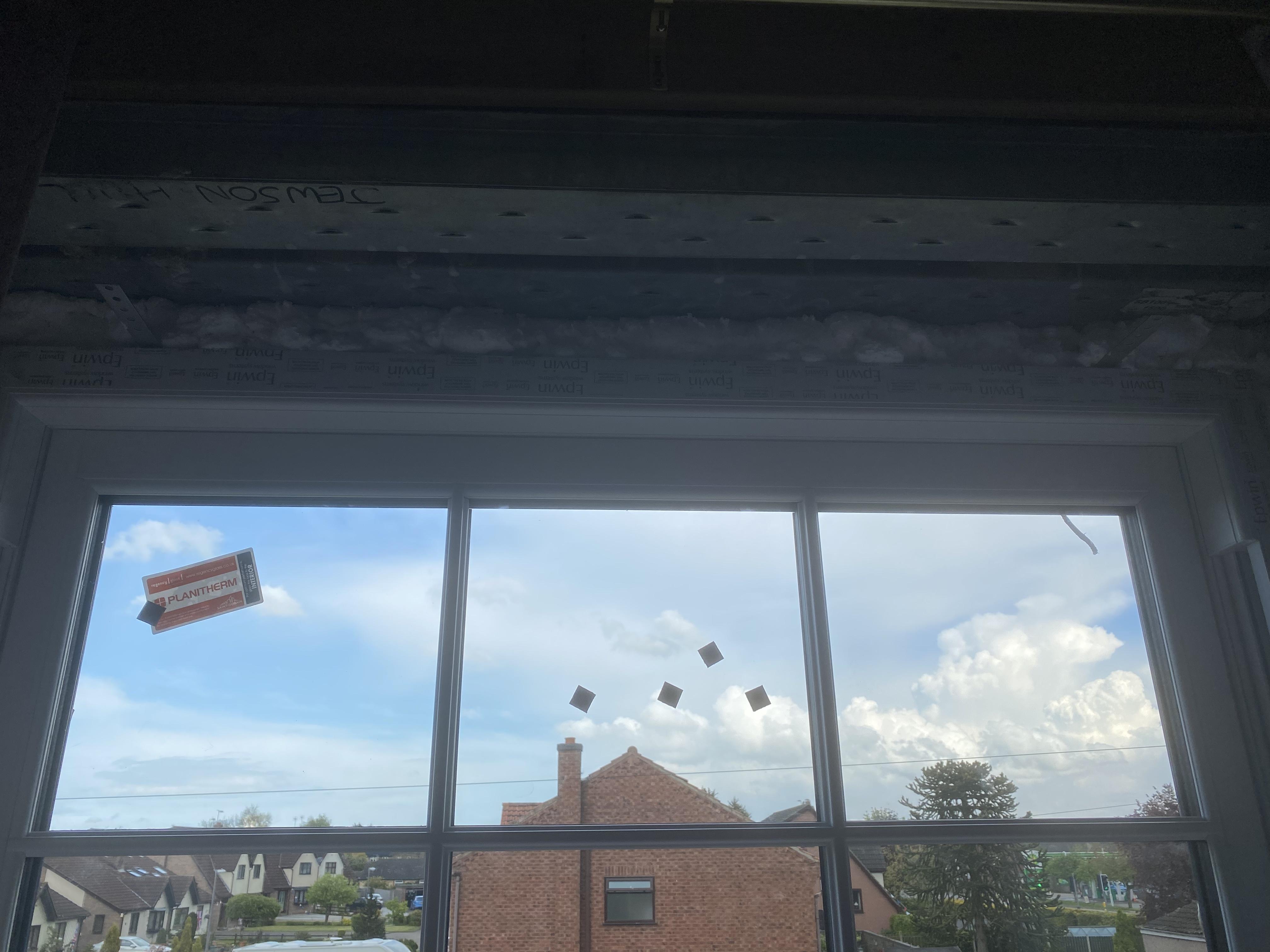

I'm using fixing brackets when installing windows, I unexpectedly had to install steel lintels over a couple of openings. I now have a ~ 30mm gap between the brackets and the bottom of the lintels to fill and secure. What's the best thing to do here? Screw a batten to the lintel and attach the brackets to that?

All sorted. With the old, wood, lintel, I was able to screw the window blinds directly into it. Now there's a chunk of steel there instead, which I plan to wrap 25mm PIR around, what's the best way to refit the blinds? -

Hit a bit of a snafu whilst replacing our windows. When removing the wood surround from one of the windows I noticed the internal cill was bowing downwards at one corner. Turns out; 1) The existing internal wooden lintel isn't long enough (only rests on the brick by approx 2" or 50mm) 2) 2 courses above the wooden lintel is the remains of the old timber sash frame 3) Between the two is a mix of nothing and rubble 4) And of course, there's no angled lintel on the external side of the wall either... From speaking with Catnic, I know that I need to replace the lot with a solid wall lintel on the external side and a box lintel behind it (internal face), but I'm worried that the remains of the old timber sash frame is reaching the top of the external wall, probably only 3x courses from the wall plate. The wall is load bearing, 2x king post trusses rest on it. Structural opening is 1200mm x 1500mm (WxH, so 1500mm box lintels needed), room width is 4.3m and height is approx 2.5m. Should I be trying to support the brickwork whilst replacing the lintel and building back up, or using acrows and some lengths of timber to support the ceiling whilst I do it?
