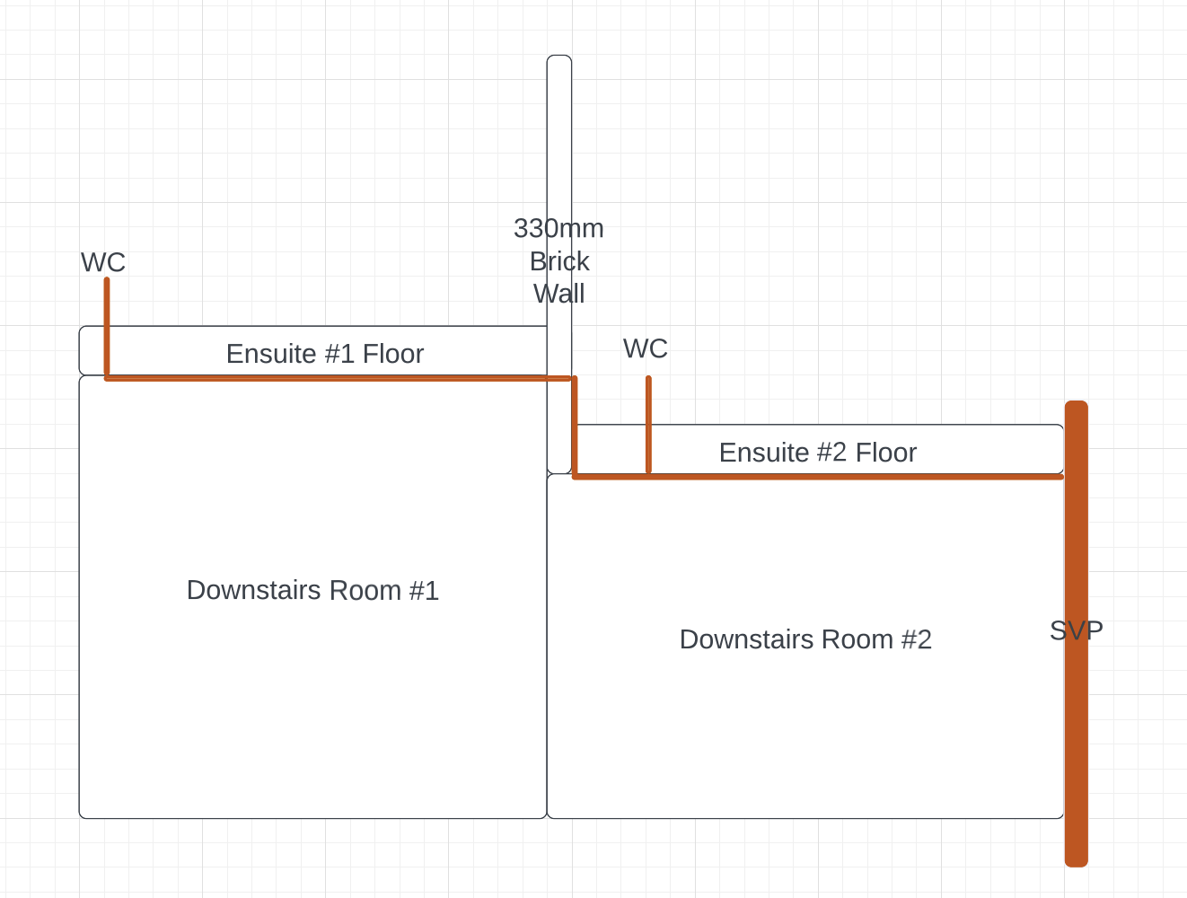

Ensuite #1 floor is solid joists, Ensuite #2 floor will likely be pozi joists. In both cases the joists will run the "right" way. I.e. left to right in the diagram. Neither have suspended ceilings below. I could probably box in within ensuite #2 to avoid anything in the rooms below.
We're going to have 2x ensuite's back-to-back, one stepped approx 200mm below the other. The lower void being the nearest to the SVP. I need to figure out the best way for the internal soil pipe to navigate this step down. 2x 90 degree bends might work (not sure if I have the clearance for that within the void), but are two bends and two changes of direction in quick succession suitable? Don't fancy any blockages! Any suggestions?
