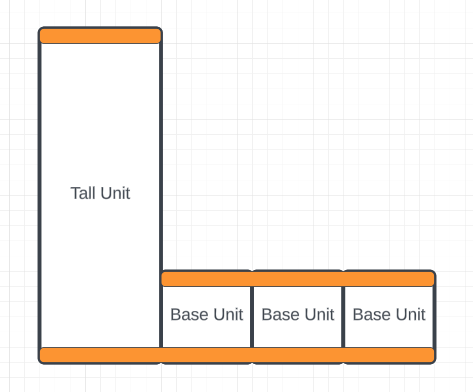

Our base units in the utility room will be stood off the wall by 100mm to accommodate for washing machine/dryer hidden in a standard 600 deep cupboard and a service void behind to run drain pipes etc. I need to figure out a way to secure them whilst maintaining the 100mm offset. Do I just use some 47x100 regularised timber battens screwed through the wall on their ends? Presumably I'd just run these top and bottom across each unit?
