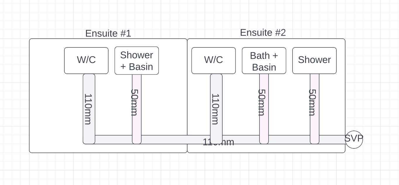

This is the sort of thing I was thinking; All internal plumbing is new, which I'd prefer to do in solvent weld, the SVP already exists and is push fit. I could probably run the single shower run in 40mm, but I'd have plenty of 50mm pipe left over, so why not!?
Third question - is 100mm solvent weld "a thing"? My BM is struggling to get hold of any, my plan was to have my bath/shower/basin drains all connect into the 110mm pipe using branches and reducers. I'm assuming 110mm solvent weld pipe is like 32/40/50mm pipe and differently sized to 110mm push fit pipe, so mixing the two wouldn't work? (I'd prefer solvent weld everywhere internally and somehow converting to push fit externally)

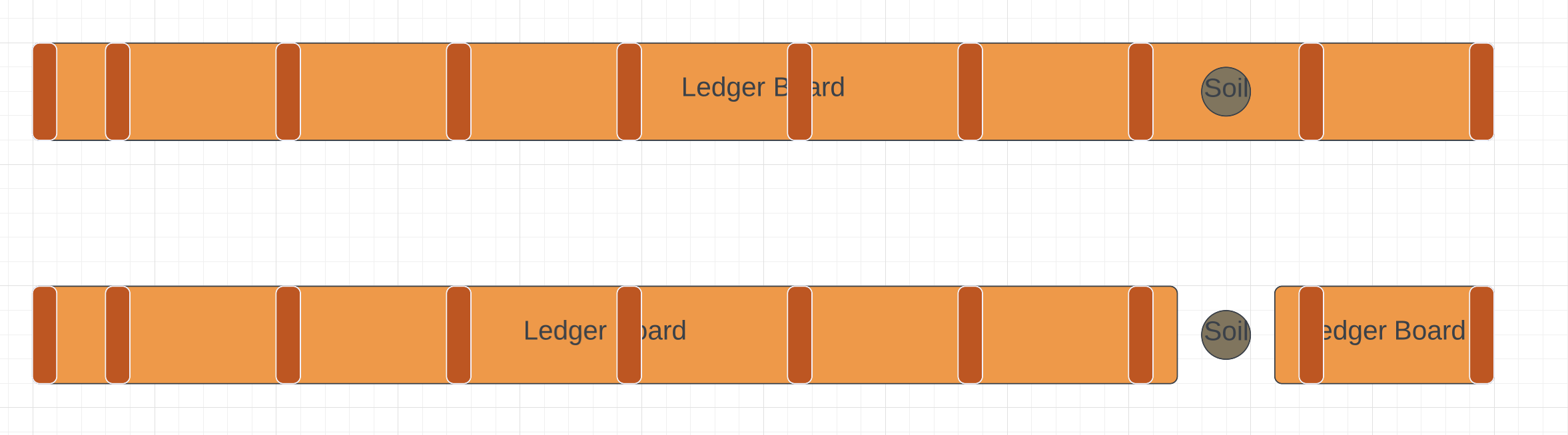

I need to fit new floor joists into a room which will become our ensuite. The old ones aren't suitable to support a bath and they're in the wrong direction to route the soil pipe. The room's 4.3m x 3.8m. I have two options; - 3.8m 97 × 202 posi joists secured to 4.3m ledger board. These will allow me to run the soil pipe through the webs and straight out the perimeter wall. Is more expensive and will take longer to be delivered. - 4.3m 72 × 220 solid timber joists secured to 3.8m ledger board. Would need to rotate the joists 90 degrees so I can run the soil pipe parallel to them, which means they'd have a longer span and I'd need to core through the ledger board (and wall behind) for the soil pipe to exit. I can get these delivered this week, to be fitted over the weekend. Given a 72 × 220 ledger board, could I cut a 110mm hole through it? Or could I effectively fit 2x ledger boards to the wall, with a gap where the soil pipe will exit the wall?
Secondary question, do I need any sort of AAV to the left of Ensuite #1, or is the vent on top of the external SVP enough? (The vent is already higher than any new W/C I'll be fitting)
