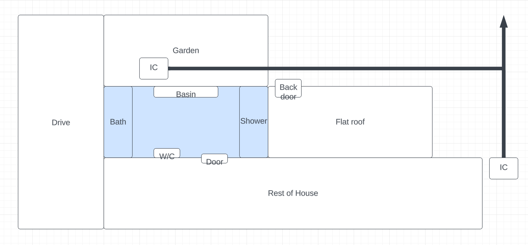

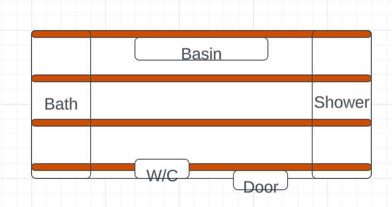

  1. Trying to figure out how I should best route the drainage pipes for our new ensuite. The layout, and ideal pipe route would be; The problem is I have sold joists running left to right across the room, like this; Which, as it happens, is great for supporting the bath, but not so helpful for pipework... For additional context, here's what the wider site plan looks like (Yeah, there's a missing IC at that outside junction...) I guess I could core the 32/40mm pipes through the final joist and rear wall, joining them to the SVP externally, but it doesn't help with the W/C soil pipe. I could route the soil pipe right, under the shower and out over the flat roof, but would then have to route to the ground somehow, and directly below it is our backdoor, restricting where the vertical pipe could drop down. I don't have a massive amount of head height in either the ensuite or room below to create some fake floor/ceiling to hide the pipework in, so short of ripping out the joists and replacing with posi's, I'm struggling to come up with a sensible idea. Any suggestions?
  2. From wall B to D, and they'll be posi-joists. Trying to avoid making too many penetrations in the external walls, the only one we currently have planned is a soil pipe.

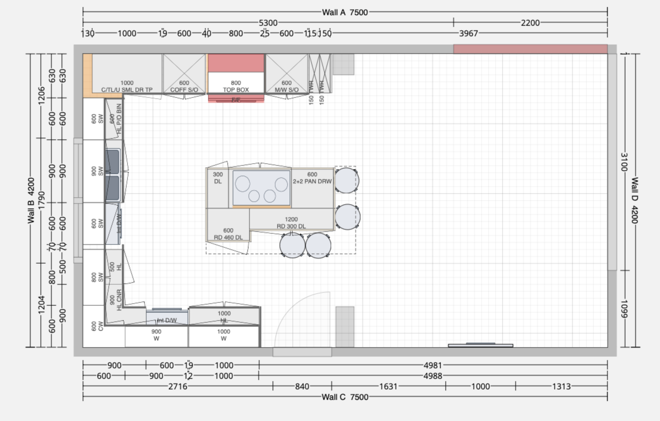

  6. Thought I'd have a stab at flipping the island around so that; - Cook can see out of folding doors across the garden - People won't be brushing past anyone sitting on stools at the island (unless they want to get into the drawers behind which will be for cutlery pots/pans etc) It keeps the triangle nice and tight and I think it works pretty well. Thoughts?
  7. Already on it

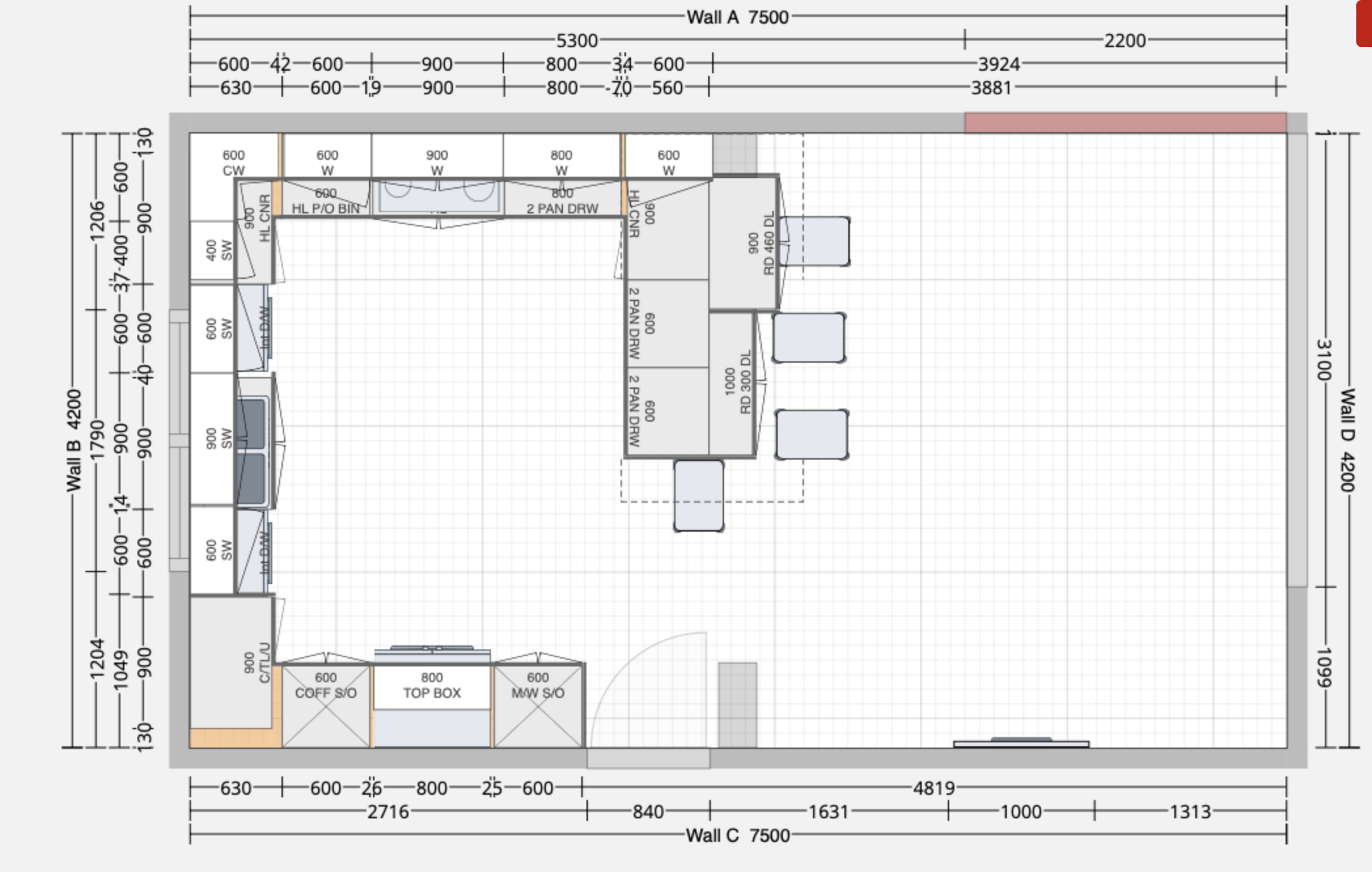

  10. Functionally, I think the island edges it; everything's in close proximity to the cook, which is great. In terms if usability I think it has to be the peninsula; it's certainly not terrible, but does move the hob further away from everything else (and reduces the larder size)
  11. Pretty much the same layout barring island vs peninsula. Biggest difference is the larger unit with an island is 1000 whereas it's only 800 with a peninsula...

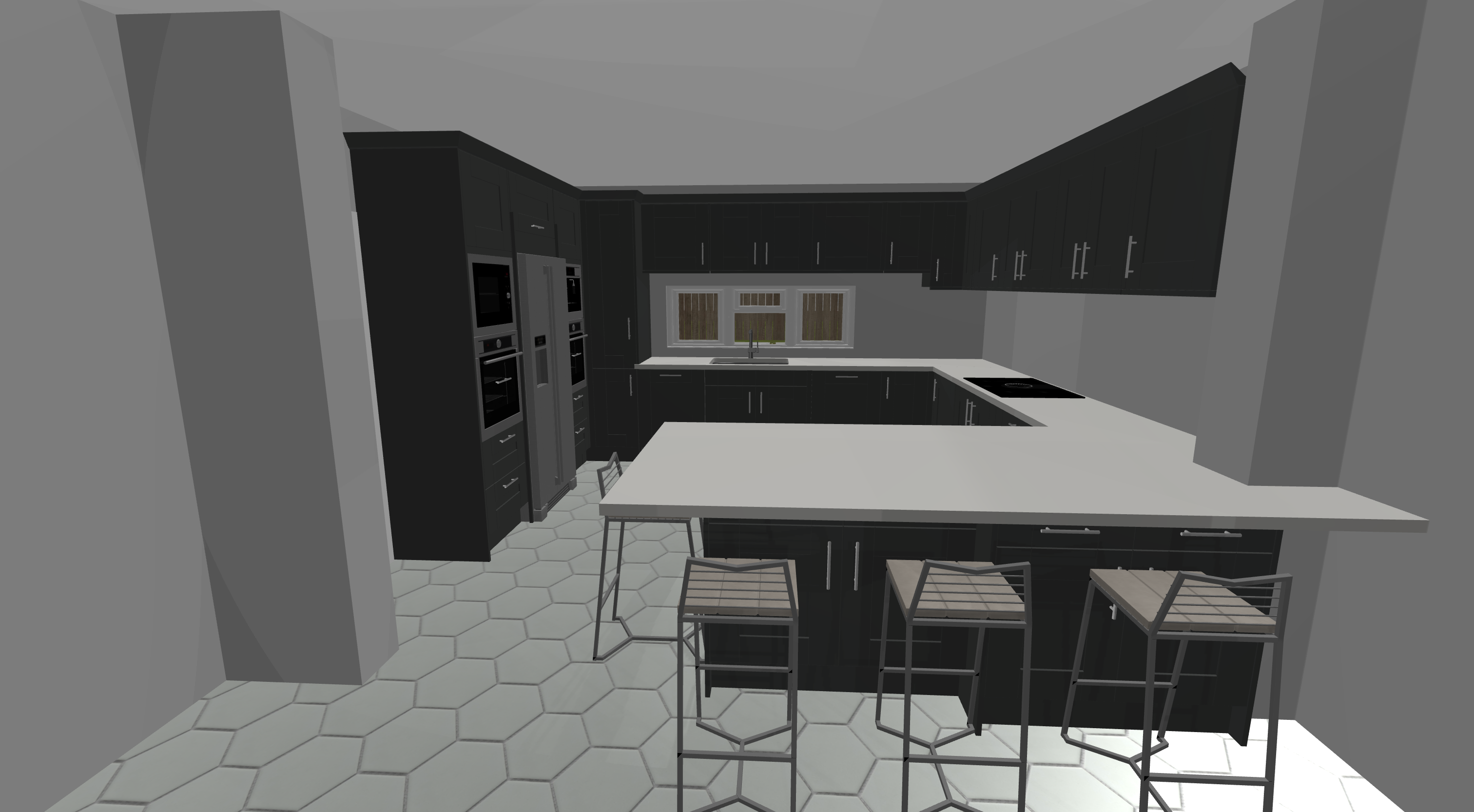

  12. Probably our "final" design to include an island. So far I think this is preferred, mainly because; 1) Anyone at the hob can be involved in conversations 2) Everything's easily accessible when cooking (i.e. fridge/microwave/larder just behind the hob) I'll take a stab at trying to get those requirements into a peninsula design too.

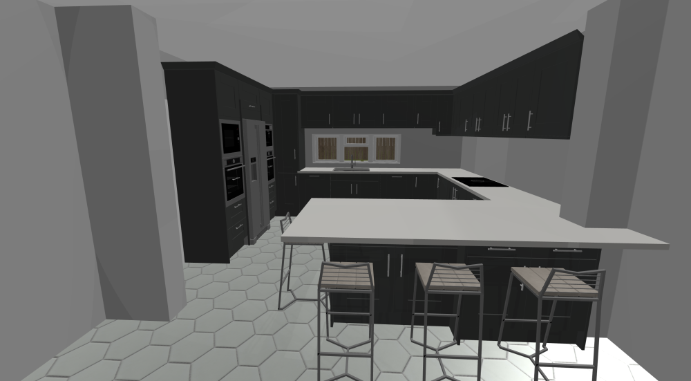

  17. Are you thinking something like this? I'm wondering whether an island is just a no go and we should be looking at a peninsular instead.
