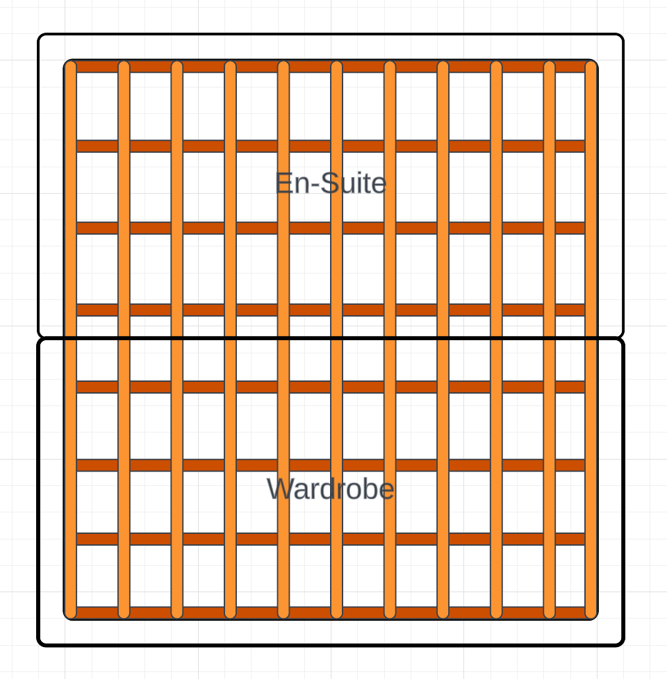

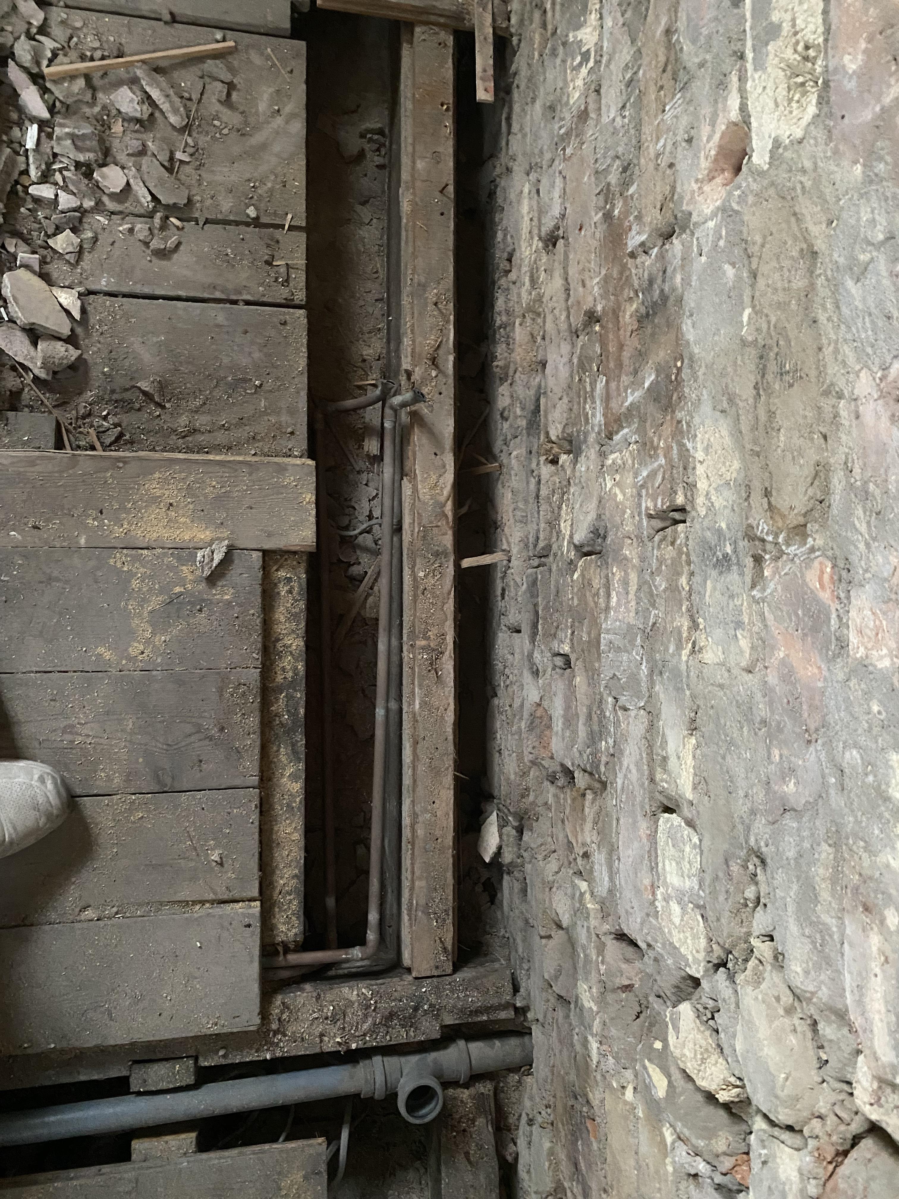

This is what I'm thinking. Dark lines are existing joists, running left to right, spanning approx 4m. Lighter lines are proposed new 8x2 timbers, running top to bottom, spanning approx 4.2m. I was thinking of just using truss clips at each end of the new timbers and noggins in between, but I could use clips at each intersection. Would noggins be a better solution mid-span?
If I was to replace the joists I think I'd need to go with 9x2 to satisfy current building regs, but given I'm overlaying on top of existing, I'm hoping 8x2 would be OK, and I'm only really going that large to raise the floor to where I want it (also gives me somewhat of a service void for my waste pipe too!) Would a truss clip at each end of the new timbers, plus noggins in between, say at 600 centres, perhaps 400 beneath the area to be tiled (room to be split into wardrobe and ensuite), be suitable?
We're still undecided on the tile format, it's likely to be large... The room's are pretty tall, nearly 3m, approx. 200mm taller than the rest of the first floor rooms (no idea why...), I was considering running some 8x2 timbers across the existing joists, fixed with truss clips and noggins, to bring it up to a similar height to the other first floor rooms. Span is approx 4.2m. But I assume deflection will still depend on the joists below these new timbers. If finished with 22mm P5, glued and screwed, would that add the required rigidity for tiling?
First floor I lifted a couple of boards from one side and the rest of the joists look "normal". I'll remove the lot regardless. I have some 22mm Caberfloor I could use... Acrylic, 102kg with a 205L capacity

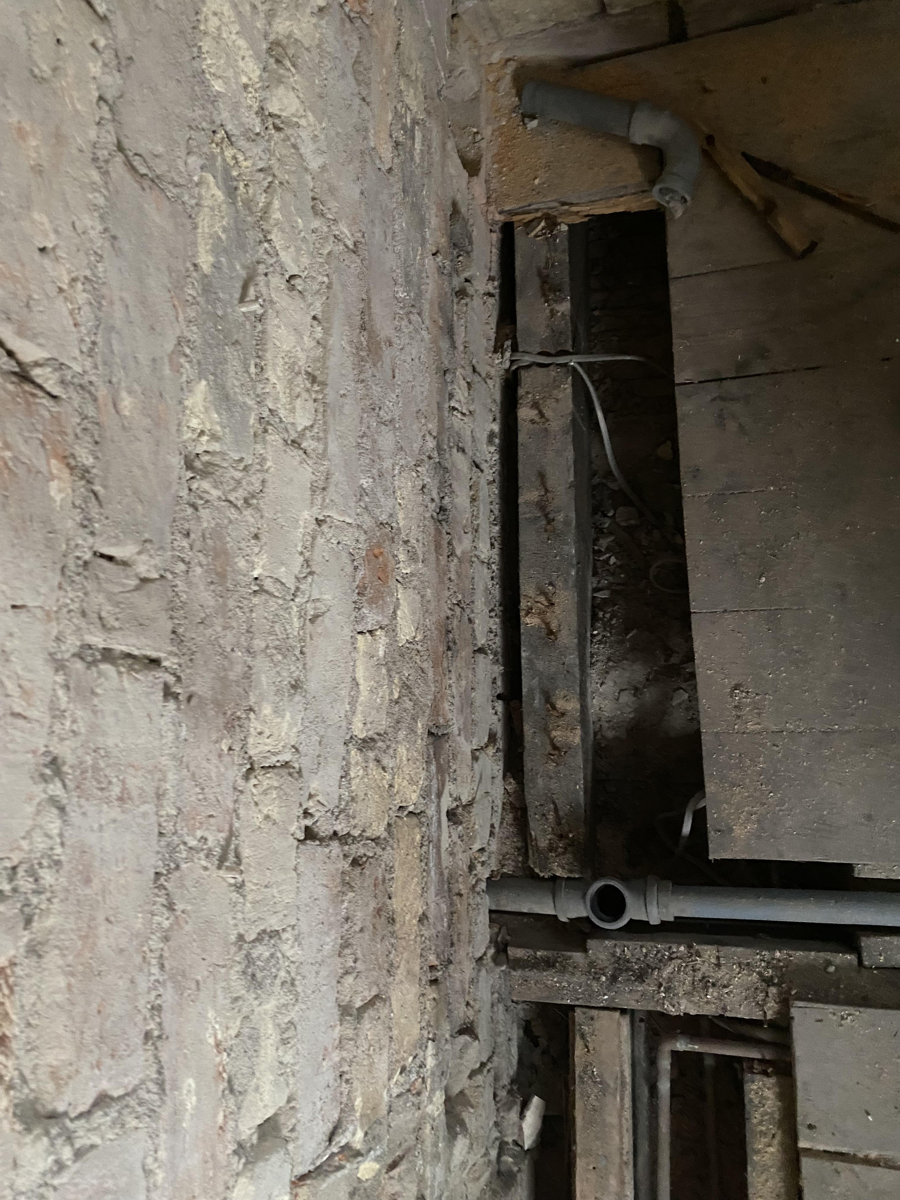

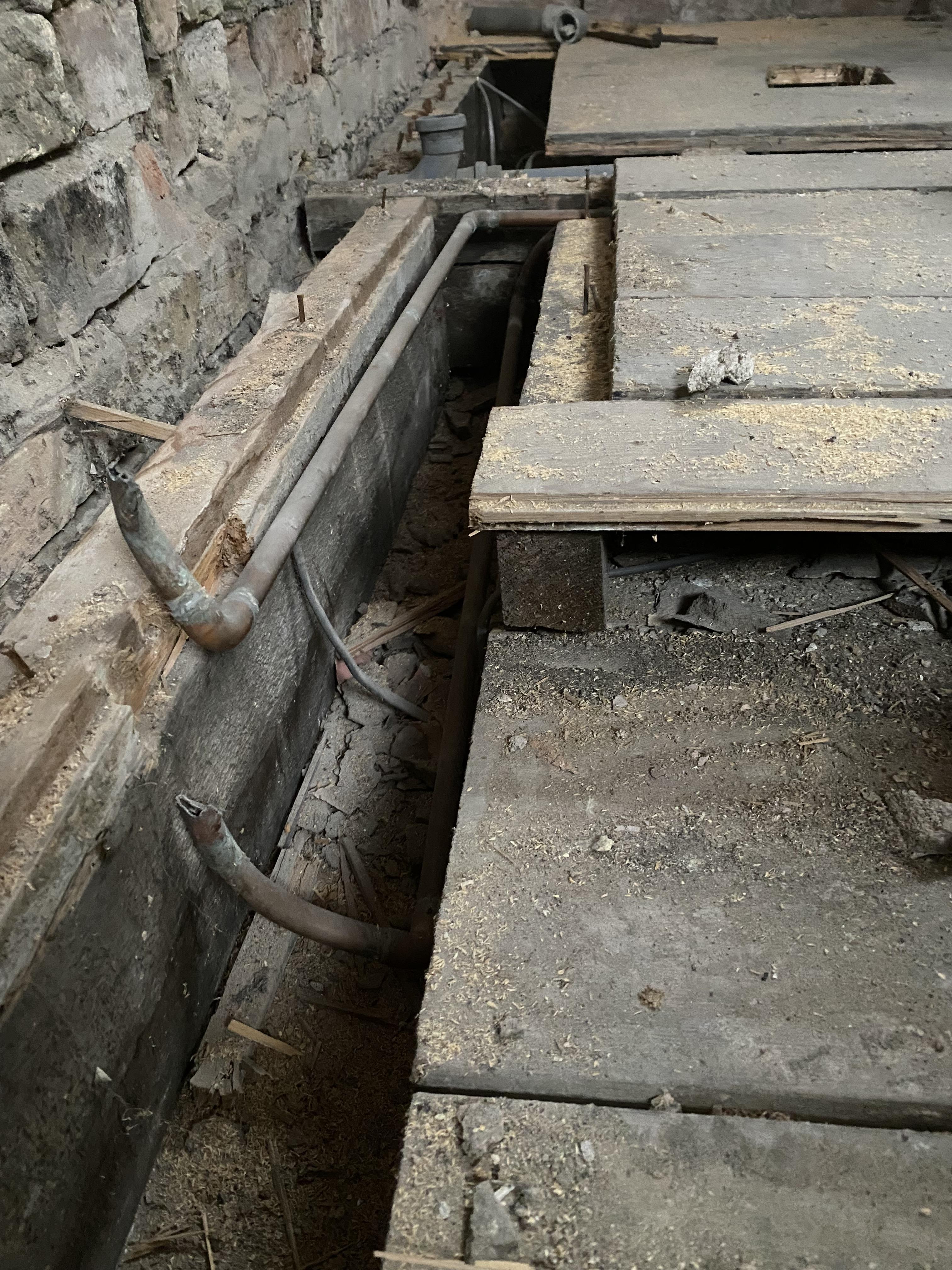

I’ll take some better pics tomorrow. The dropped area is certainly where if expect a hearth to originally be, but I have no idea why it’s dropped nor why there would be floorboards in its place now….
Started on our en-suite, lifted the boards to find this concoction of joists. Where it juts out looks to be where an old fireplace might have been. No idea what’s going on with the dropped flooring where the hearth once was… I can’t figure out how the centre part of the joists are actually supported and given I plan to fit a bath and tile this room I want to know it’s right. The floor was springy with the boards down so I was expecting to add some noggins, but not unearth this can of worms…

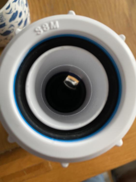

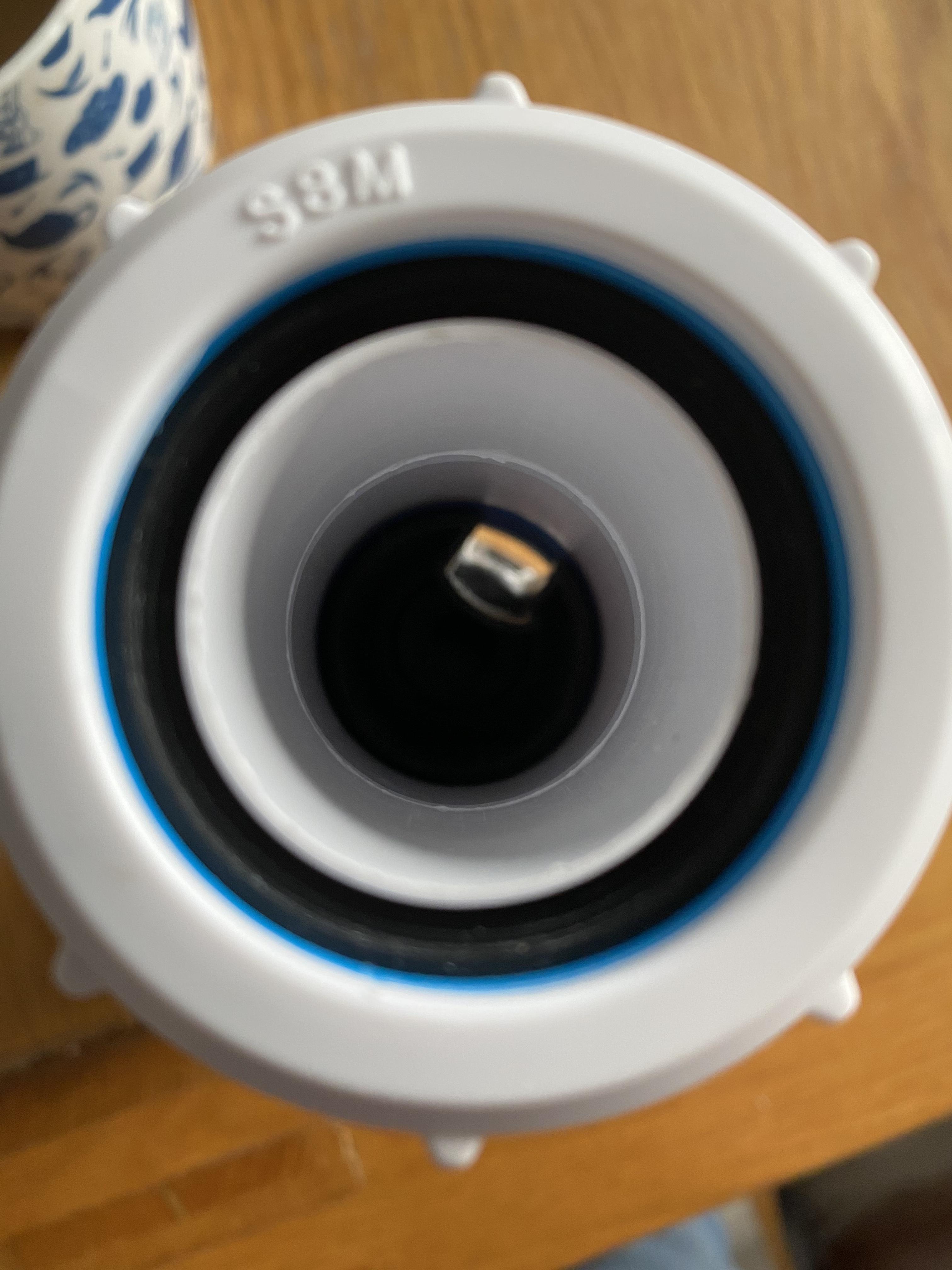

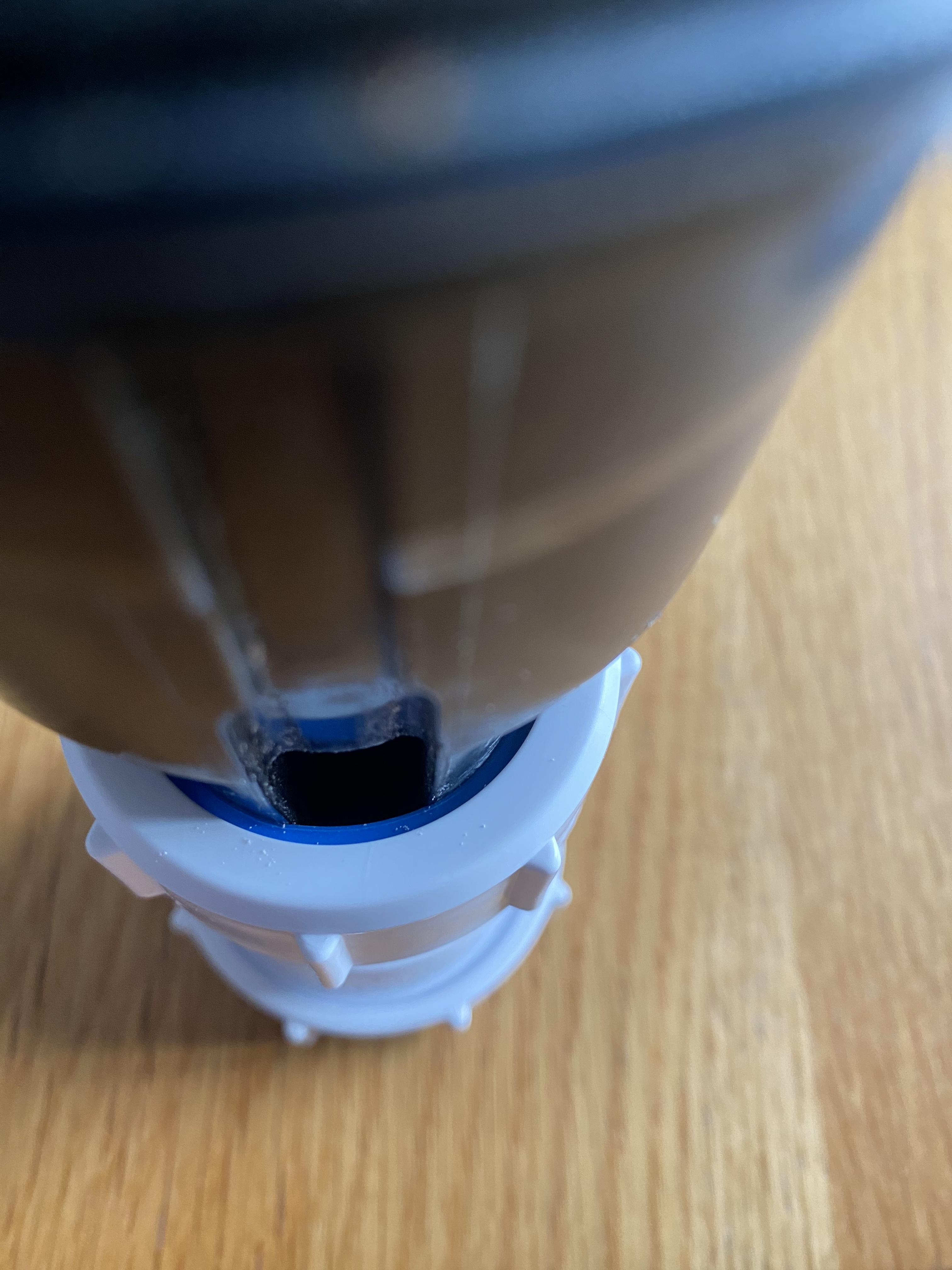

It fits but there’s a notch out the back of the drain itself. Is that just an air break? Worried any potentially back flow of waste could end up all over my loft… presumably a waterless trap helps avoid that? -

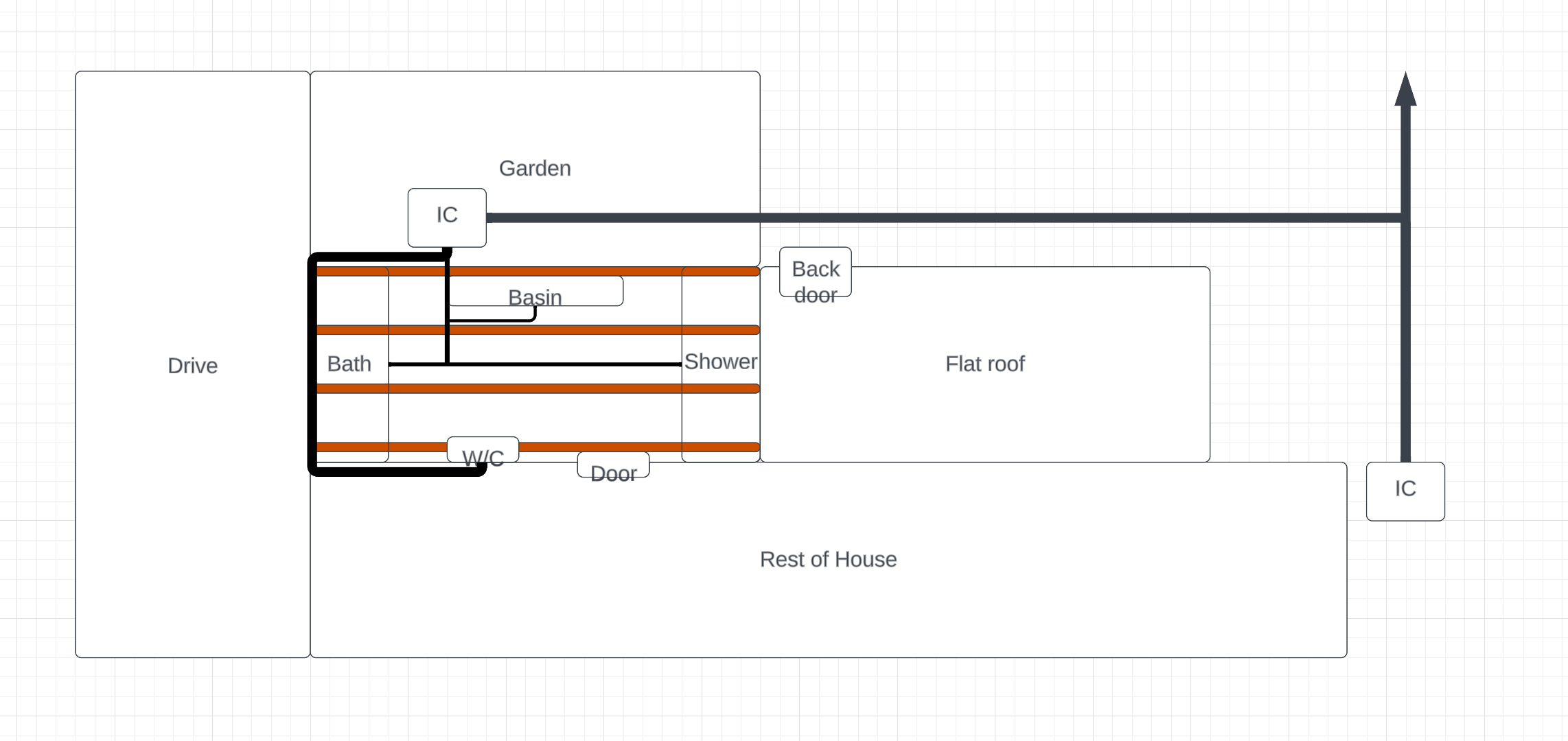

So a soil pipe boxed in running across the stud wall and down the returning wall to the outside - could I get away with hiding at least part of the run within the 6x2 stud wall? Then the bath/shower/basin waste running externally and then teed into the SVP? I was thinking 40mm from all three, teed into a 50mm that runs externally. Something like this;
Swapping the basin and W/C positions would allow me to run an internal stack in the top left corner of the layout, hidden behind tall units in the kitchen below. I think walking into the ensuite and being faced with the W/C, rather than basin/mirror/niches etc, kinda spoils the aesthetics, which I'd love to avoid.
Even thought about running the soil pipe horizontally through the stud wall and down through the room below, which is the kitchen, but where it would drop down is right above the damn kitchen window!
Sorry, some missing context. 3x external walls, all of which will be insulated and will be battened off the wall, expected to use 2x1 battens, but could go slightly deeper to accommodate pipework. W/C will be wall hung, so would be in a 6" stud wall, was considering building a staggered stud wall, mainly because I have a load of 4x2 left, but still not sure I could get the 90mm pipe horizontally through it, and convert up to 110mm once I reached to SVP? Shower tray is a linear wet room former so will be sitting directly on the joists, meaning the trap and pipework will already below the top of the joists. Room, uninsulated is 4.5m x 2m (was planning on 1800 finished width to match bath and shower tray size)
