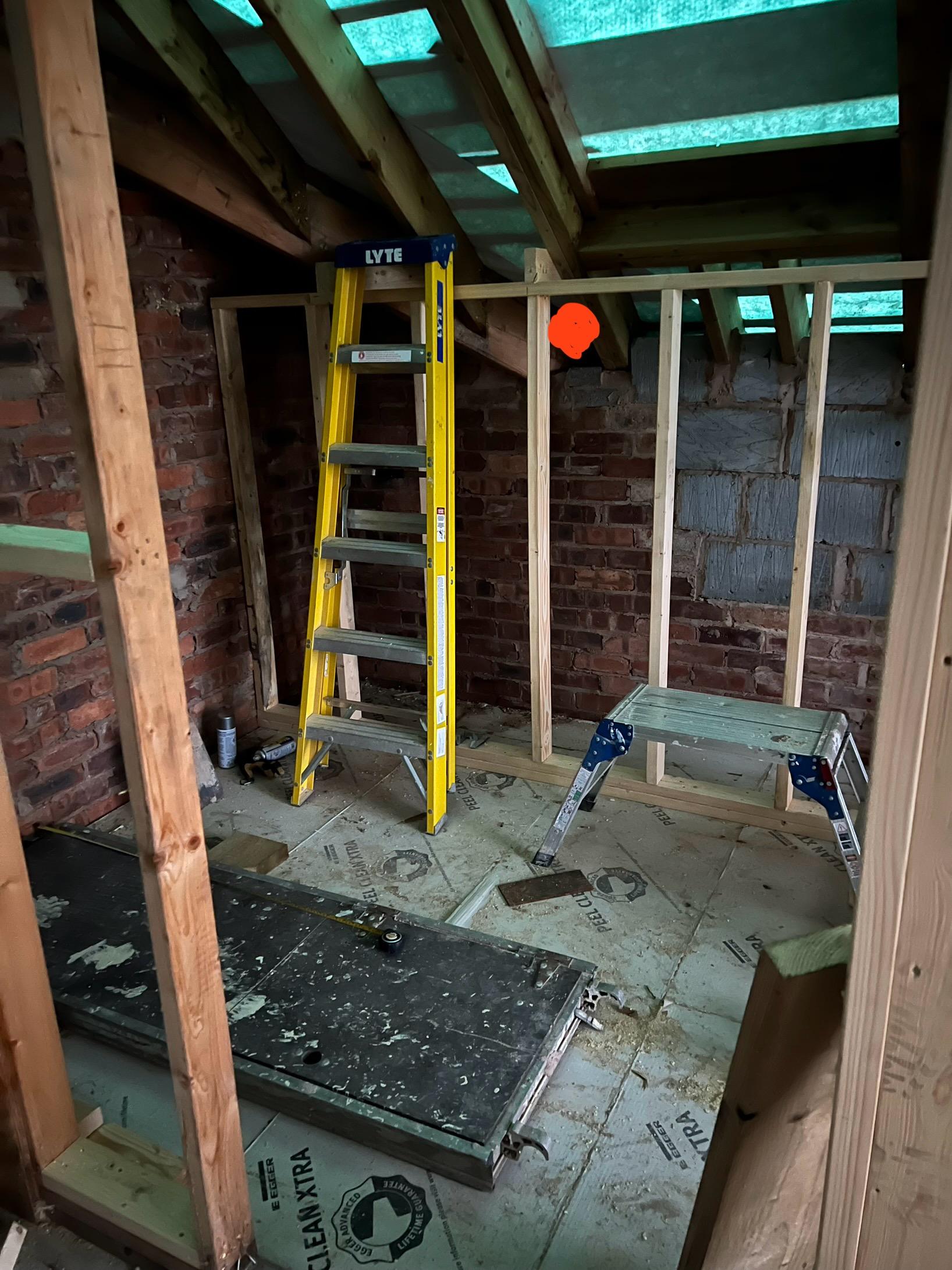

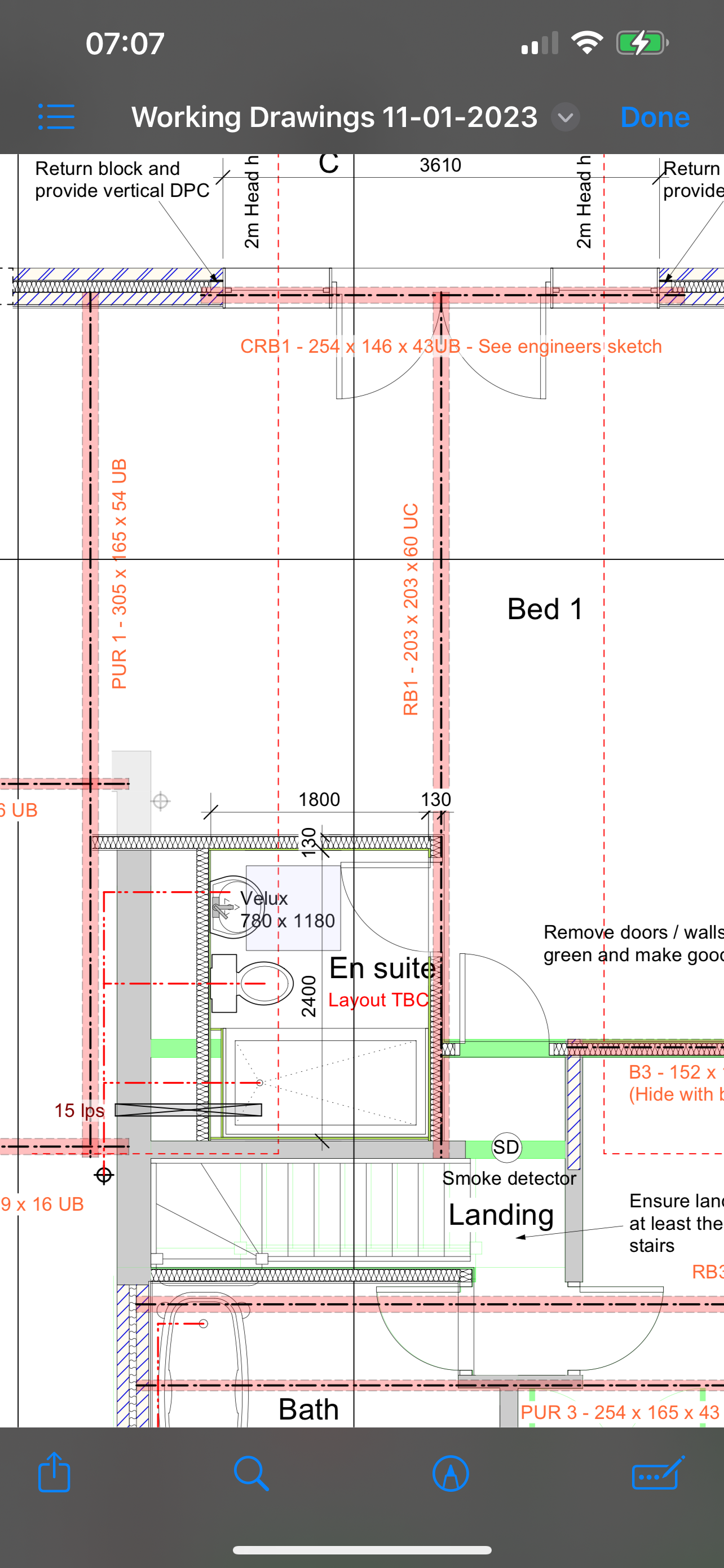

  11. Ignore the layout on the drawings, on the picture the shower is going where the scaffold board is, toilet is the ladder and sink is the hop up step. The red dot is where I’m thinking of putting the extract valve as the void behind is perfect with the MEV unit on the other side of the brick wall behind it. I could get some flat 51 duct and go further up the ceiling but I’d be compromising the insulation. I guess if it doesn’t work too well we can just open the massive Velux to clear the moisture! Maybe I'm just overthinking the whole thing!
  12. Thanks for the replies, I did consider a dmev but I really didn’t want roof penetrations and the brick wall backs onto the stairs. I do have another bathroom that I will probably use a dmev fan for as the duct run back to the MeV will be double the rest of the runs.

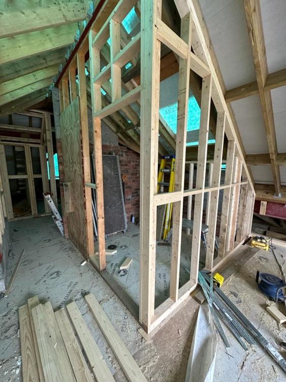

  13. Hi, I’m sorting out our MEV system but unsure what to do in our en-suite. it’s a vaulted ceiling with little space, would the position of the extractor in the picture below be OK or am I best figuring out how to get it as high as possible?
