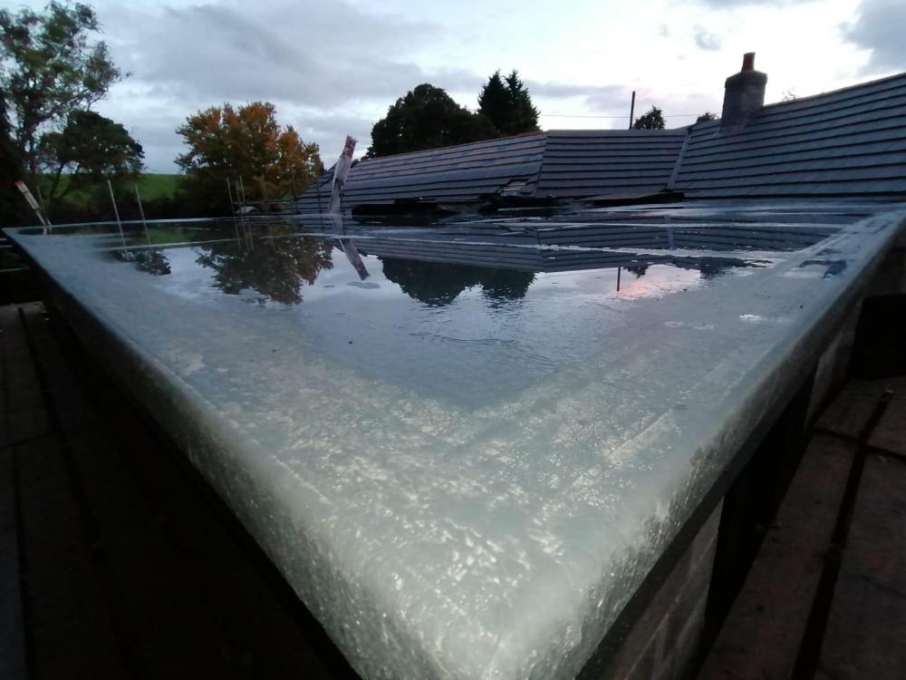

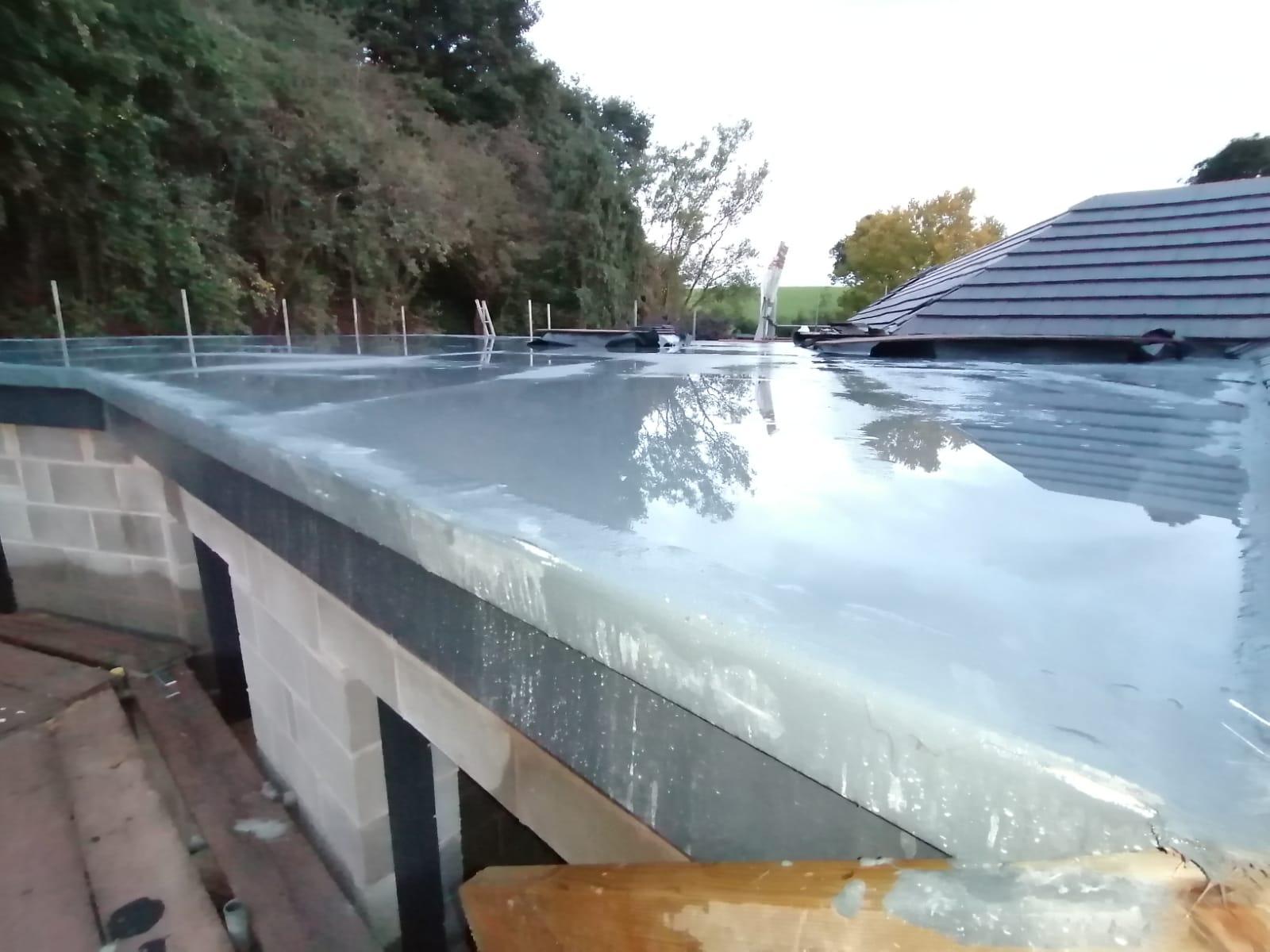

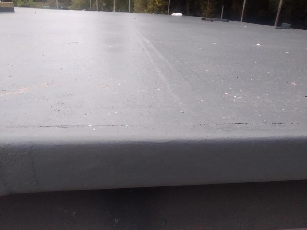

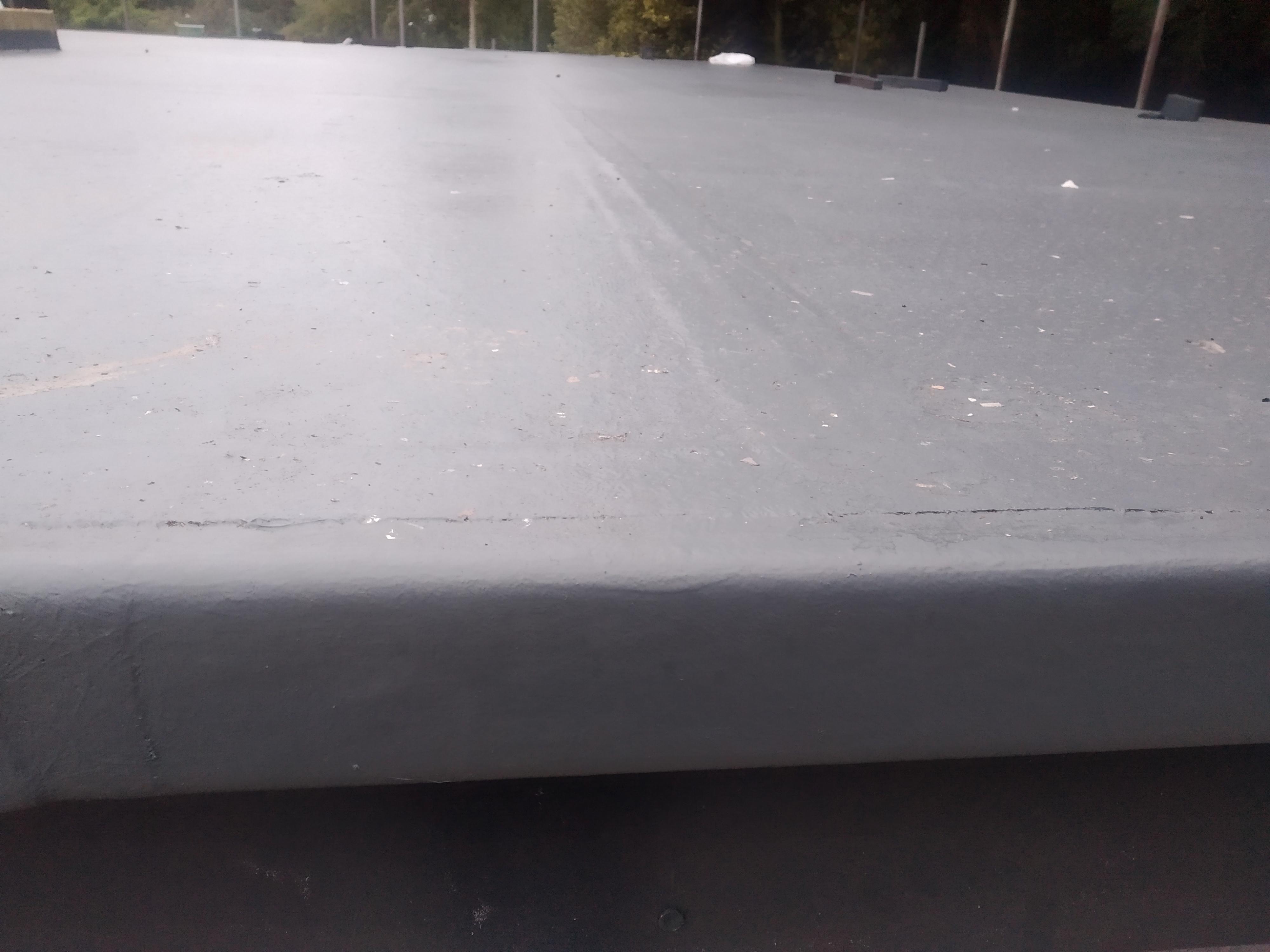

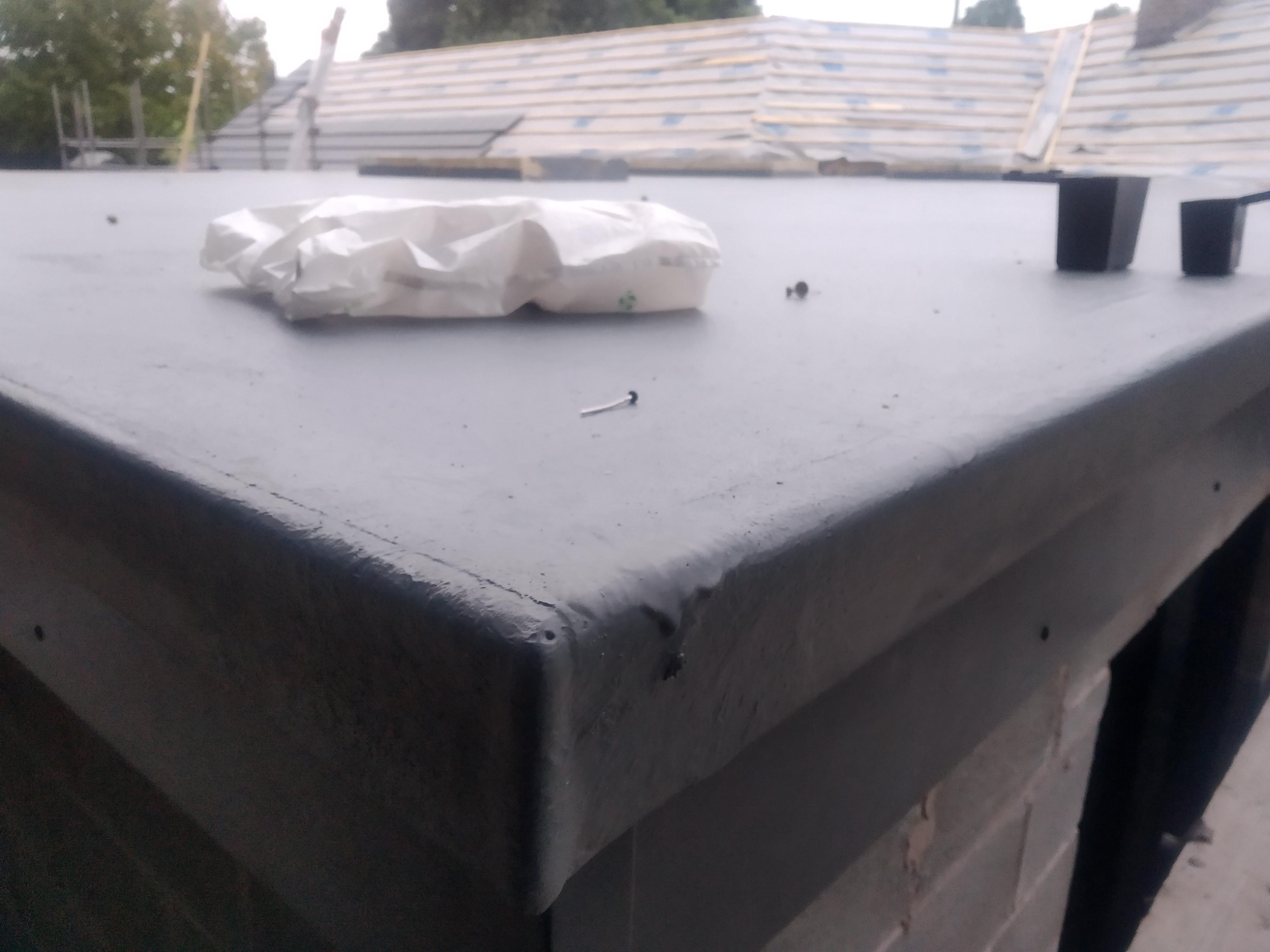

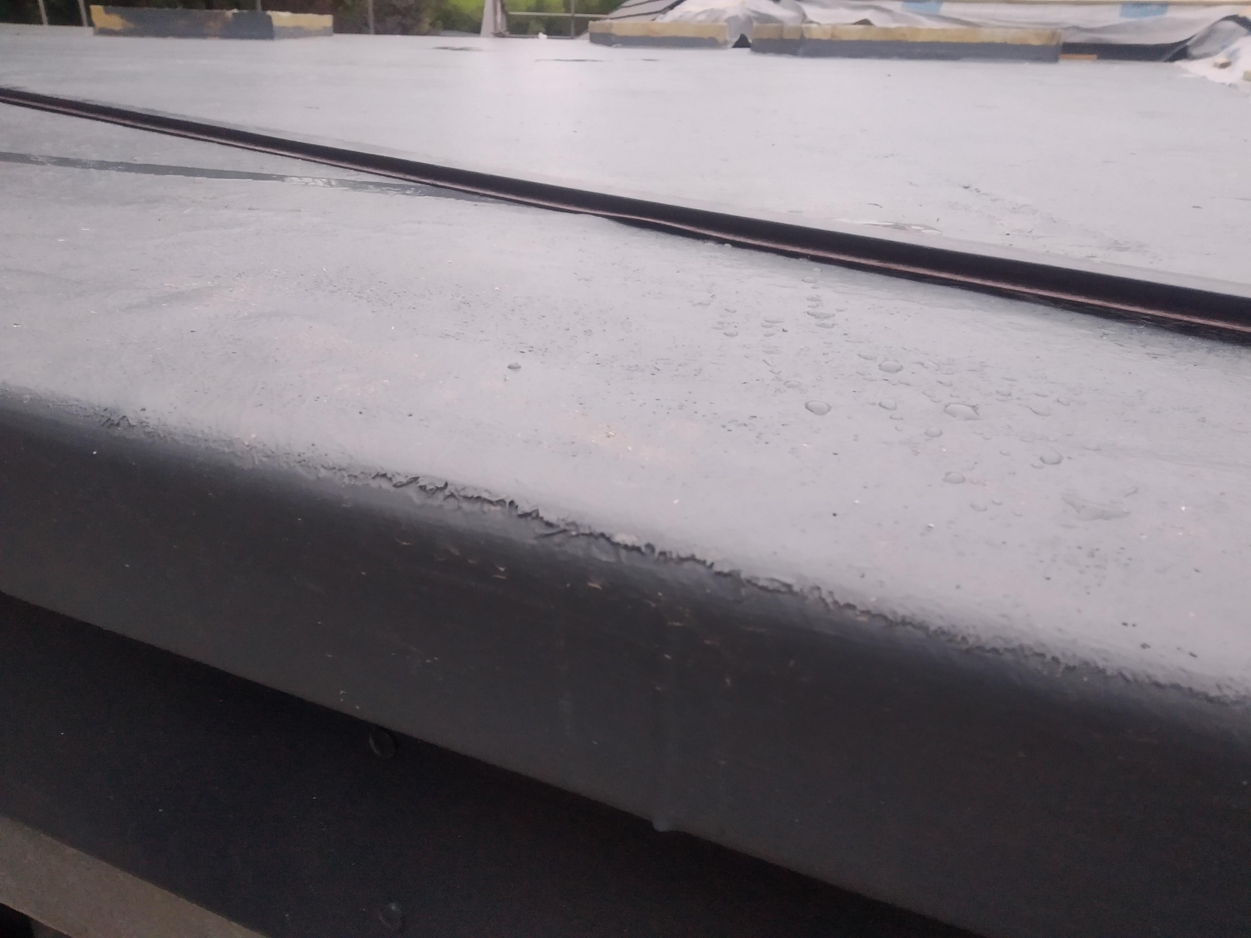

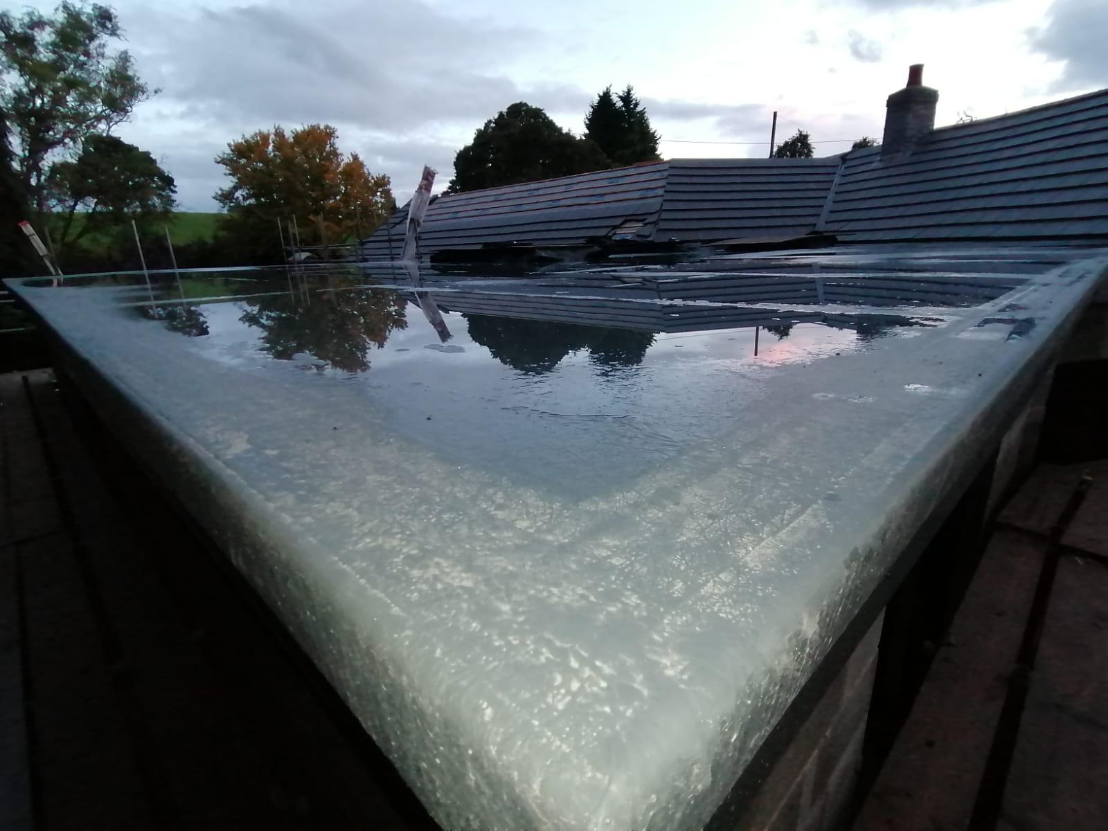

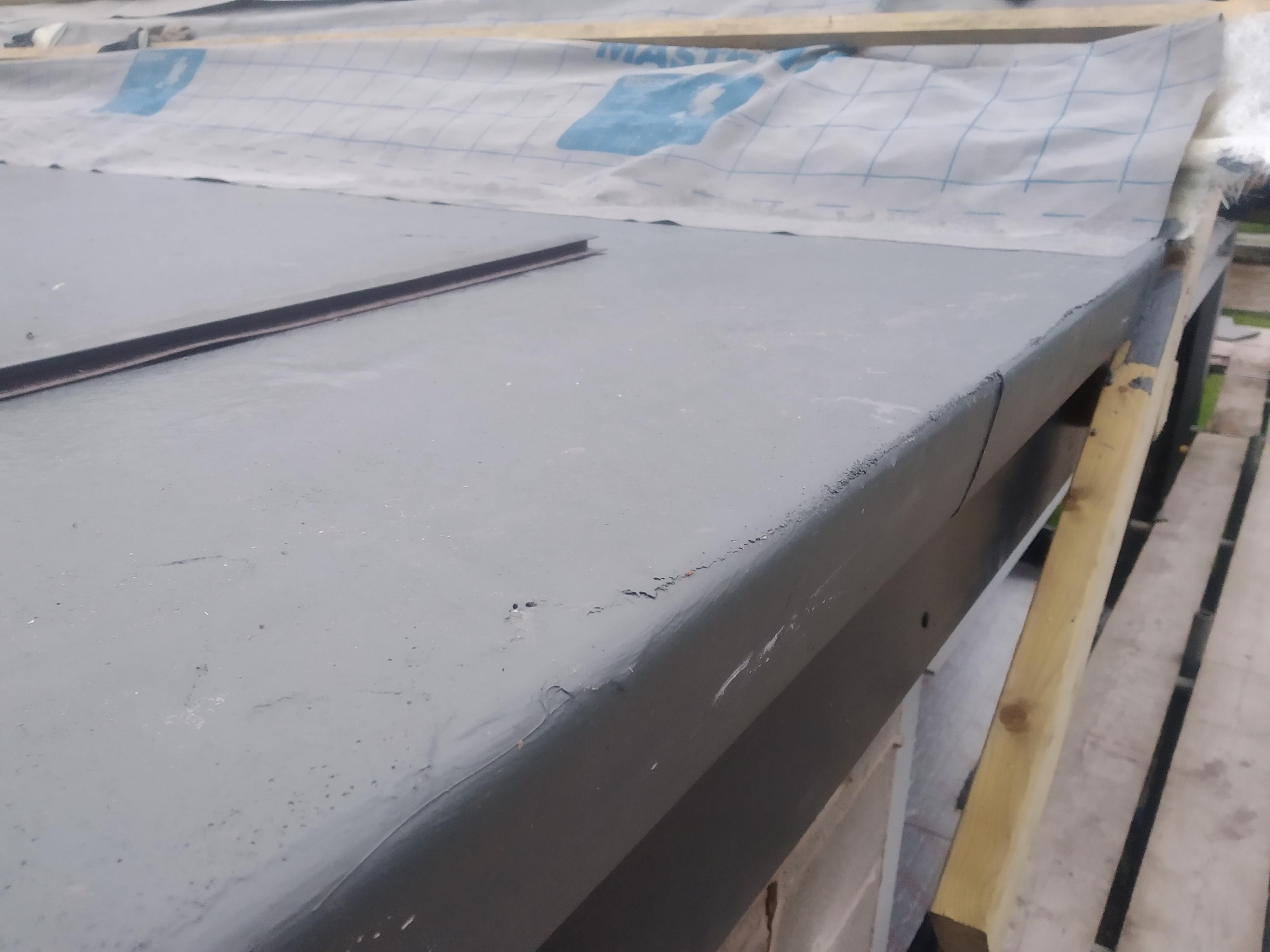

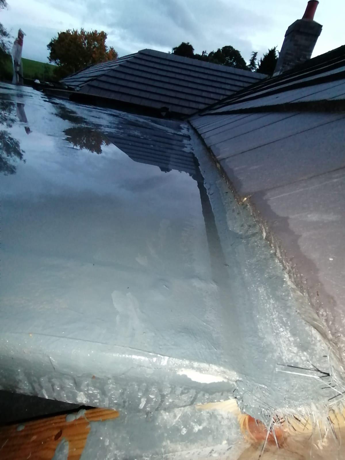

I'll start with the GRP roof but I'll dedicate this whole blog entry to which I will deem the God-awful Rubbish Period. This probably seems like I'm over exaggerating but there's just been a lot of things combined with work, personal etc and I have really been feeling the pressure.
Intially, as they started laying the fabric the GRP looked OK but, despite what I would say is perfect conditions for the GRP going on from what I know through reading on here we, were appalled by the quality of the work. Without bombarding this blog with pics unless you really, really want to see them, just take my word for it, it was bad! I believe I this was subcontracted but as we have not been on site I think it's been done by the builder themselves.
Needless to say I was not happy so met with the builder who muttered something about weather and acknowledged it was poor. There has been some improvement but I can't say I'm entirely happy but I believe this will be rectified, hopefully. I also raised the issue of the rooflight upstands not been GRPd to the roof and something is happening with lead flashing so I'm hoping that will be rectified too.
Here is the current GRP as it stands, comments welcome because I don't know if I'm being over picky but I want to be prepared for meeting the builder this week so please give me your opinions.
IMG_20200916_190512.thumb.jpg.cd83db8bc799ea0dcb9d047c78bde5d1.jpgIMG_20200916_190441.thumb.jpg.e21120d31843dc45b19abf8dc52254e0.jpg

10 minutes ago, joe90 said:
The pooling is not a problem but the “delaminating” from the trim is wrong, make sure you photograph every area where this has occurred. @SteamyTea will be along in a moment to suggest it’s remedy (that the roofer should do). Don’t know if it’s luck or judgement (hopefully the latter) I have never had that happen on a roof I have done.
Thanks. I was actually having a couple of days away but my wife just sent me these. I'll get photos and get on to the builder. My patience is wearing thin!

14 minutes ago, Big Jimbo said:
I know others are a fan of the old GRP. I could not live with that. I would be having that whole roof ripped off. I have built atleast 20 flat roofs, and i have never built One Flat, for the reason that, regardless of what you cover it with, it will look like yours. I am not saying that it won't be ok, but it looks dreadful. What do your drawings say ? have your drawings asked for a flat roof, or do they show a fall, constructed by perhaps firing pieces. If your drawings ask for a flat roof, then that is what you have got. If your drawings ask for a flat roof will falls, i would make him rip the whole lot off.
I must agree that I favour a slope of some sort if only minimal. If done properly GRP must be very waterproof as there are millions of boats made from it and some very old ones. This has not been done well!!
I've just had quick look at what I've got on my phone and it says;
INSULATION BONDED TO VCL ON 22MM EXTERNAL QUALITY PLYWOOD
DECKING OR SIMILAR APPROVED ON SW FIRINGS TO MINIMUM 1 IN 80
FALL ON SW TREATED 47 X 170MM FLAT ROOF C24 TIMBER JOISTS AT
400MM CTRS TO GIVE A MAX SPAN OF 3.22M OR AS STRUCTURAL
ENGINEER'S DETAILS AND CALCULATIONS.
To me this looks like there should be a fall on the roof. Is this right?
Link to comment
YES, looking at those photo,s there is no fall or not consistent. Are the ceilings up inside? If not you should see the firings (long wedges to create a fall. Time to call the builders and have this out with him.
Your roof should have a fall. 1:80 To explain, for every 80cm of travel, it should drop (be lower ) by 1cm. Your roof has no fall. I would make him rip it off and start again, or sling his butt off site. people keep going on about boats lasting forever etc. Now, i am not a boat builder, but i have built 1 grp boat. I started with a mold, and i laid in a couloured gel coat. This was followed by atleast 5 layers of matting. So overall the hull was about 7mm thick. That is not how grp roofs are done. They have no comparison with boats. Your roof might be ply, or osb. They have gone over the joins in the wood with One layer of 100mm wide matting. They have then laid matting (ONE LAYER) over the whole roof. They have then put on a top coat over that (no matting) This give it the colour. IT IS NOTHING LIKE A BLOODY BOAT. Get the crap builder to rip off the whole sodding roof, and start again. Unless he said to you up front "Here is your quote mate. It's very cheap. It will a lot cheaper than any other quotes you get, because i am a bit of a bodger. Don't complain if it don't look like Buck Palace" That is One large roof. Get it done right, or you will regret it forever. If you put your house on the market, and i came to see it. I would be telling you to knock 30k off the price, because i am going to have to rip that crap roof off......... And, forget about boats.

So, bit of an update we met with the builder earlier on, just us and no distractions as @Nickfromwales suggested.
I had worded a strong email last night as well as sent pics on WhatsApp. We were both ready to take no crap, luckily it didn't come to that. Builder straight away admitted it was bad and he had trusted someone against his gut feelings and said he knew it should have had a fall on it and had seen it earlier on in the day before we did and realised how bad it looked. He said he had been worrying about it and knows it looks bad on him. He said he could go on but it's his responsibility and won't make any excuses and it's a bad job so first hurdle ☑️
 In terms of putting it right, this is what I want to check. Interestingly it mirrors what @SteamyTea mentioned about a secondary roof over the original one. His proposal to do this with new OSB with filings so creating a fall. The fall will then sort of be either side of the middle of the roof, almost like a pitch but obviously very slight, not like a pitched roof! Then the whole thing GRPd again, this time properly and getting the ideal weather
I think the issue in taking the whole roof off is that our UFH has been laid, flooring base is coming on Wednesday and it's all progressing because in 3 weeks Internorm are coming for the windows so I am presuming this is a way of not losing any time.
Anything I should be worried about fitting a roof over a roof if it's done properly with a fall?
