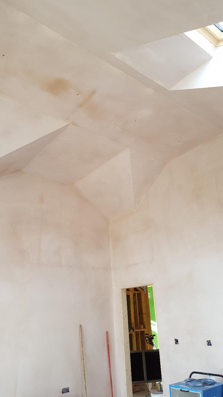

The boarding started in earnest before Christmas and so the plasterers were in bright and early in the new year.  We've got through an astonishing amount of board of various types - I thought I'd calculated reasonably well and had a mahooosive delivery of the stuff a while back, but it all seemed to disappear and the building was hungry for more.  I bought all the board from Sydenhams as I found their price to be competitive.  I've used standard 12.5mm plasterboard on all external walls, 15mm acoustic on all ceilings and internal walls, moisture board for bath/wet rooms, and pink fire board for the garage walls and ceiling.  The garage is attached and so building regs require a fire door (FD30, sourced from Enfield Doors, though I've since found cheaper suppliers when looking at other stuff) and fire board throughout the garage, but only a single layer as there is no habitable space above it.

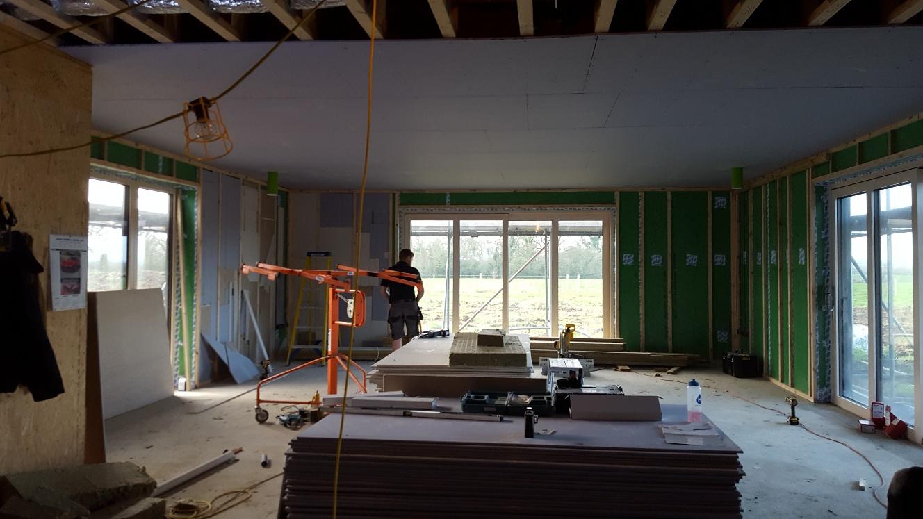

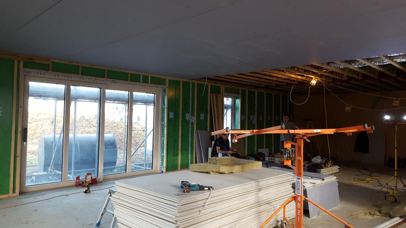

I've had a board lifter on hire as it really helps the team position the boards up onto the ceilings without dropping anything on themselves or damaging either themselves or the boards.
Here is the board going up on the lounge/dining area towards the kitchen area.  The orange frame is the plaster board lifter.  The black thing outside the window is my sewage treatment plant tank, which will be installed in a couple of weeks(ish).

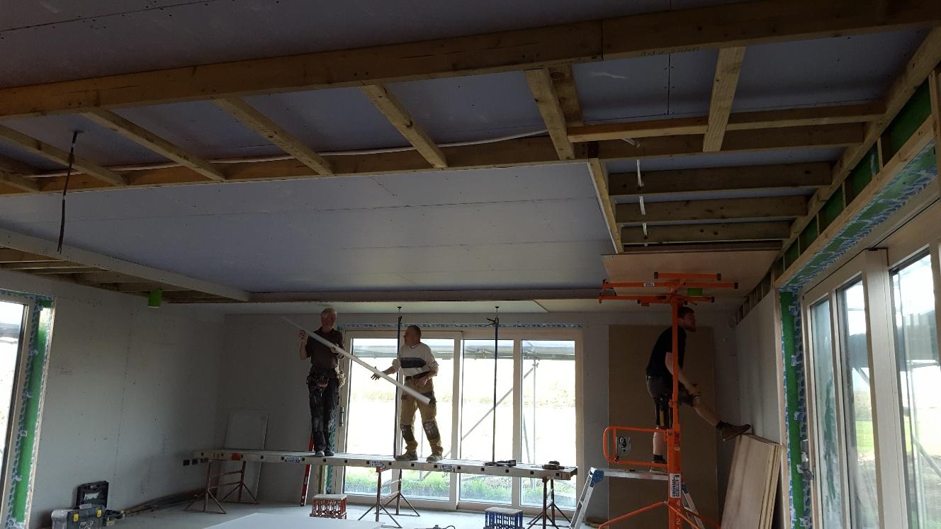

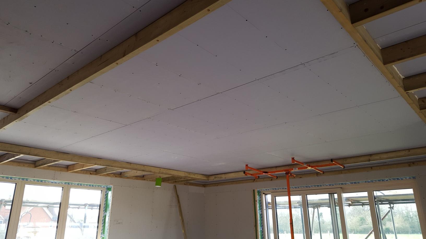

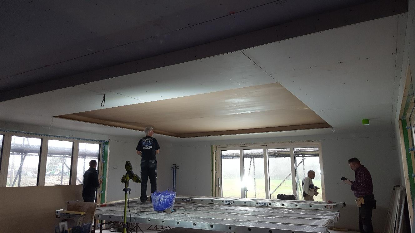

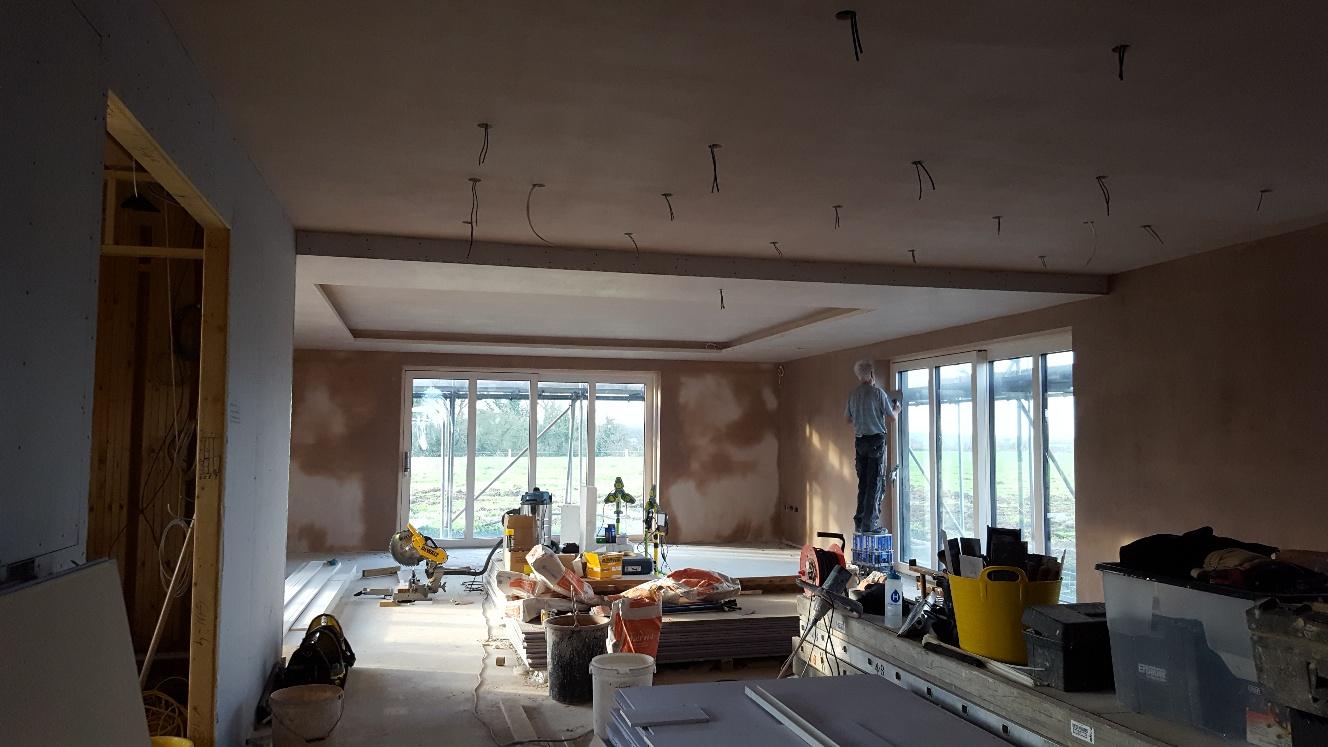

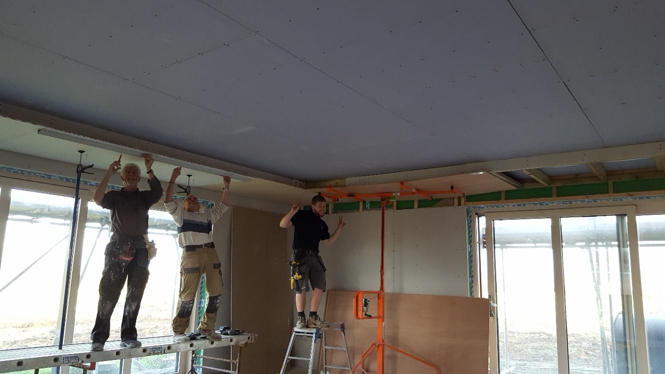

The room that forms the greater part of the ground floor is the kitchen/dining/lounge area and it's a very large space.  From the outset, I've wanted to achieve some form of visual separation of the living area but without putting physical barriers in the way.  It seems a waste to have gone to such great effort to create a lovely large space like that to then chop it up and close it in.  I had inspiration for the solution from a couple of sources, the first of which is a tiny, crappy image on Pinterest when I was browsing cinema rooms.  The second came about from chatting to another BH member, @Dreadnaught and a suggestion someone made to him to vary the heights of the ceiling throughout his proposed build.  From this, I decided that I wanted a dropped section, like a frame, on the ceiling above the lounge area, with lighting recessed into the inner lip of the dropped section.  Everyone pulled together really well to meet the challenge, and worked out what was needed from the carpentry, boarding, plastering and electrics contingents.  The full ceiling was boarded out first, then the studwork frame put over it.  The electrics were run through, then the frame was boarded and eventually plastered.
Here's the completed framework and the first of the plasterboard going up.
They're a cheerful bunch in their work!
One thing I haven't skimped on is hire equipment to make the job of the plasterers and others easier.  I figure it's a false economy to not get equipment like platforms and board lifters in as it will just cost me extra labour as the guys won't be able to work efficiently and possibly, not as well either.  We had scaffold towers upstairs in the bedrooms for plastering and downstairs, we had a really big platform.  I wouldn't do it any other way as the quality of the boarding and plastering is second to none.

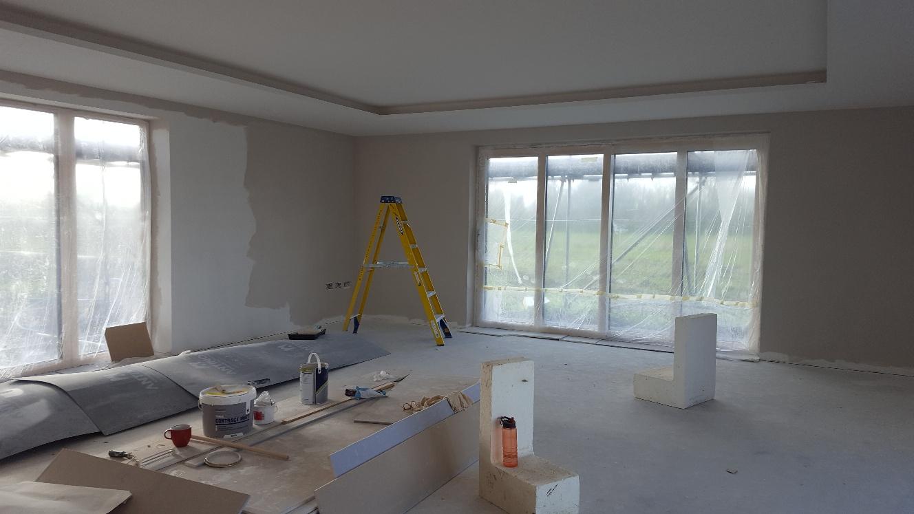

Once the studwork was boarded out, the inner ceiling section was plastered.  The inner lip of the frame had an upstand added to it to make it appear more substantial and to hide the rows of LED lights behind them.  We're going for a range of lighting intensity here, achieved by increasing amounts of lights, rather than dimmers.  There will be 3 rows of LED lights hidden up there and we've used a car headlight analogy for want of better descriptions - the selection is dipped lights, main beam and rally lights.  These are the only ceiling lights in this area as we plan to have floor lamps for specific task or reading lighting.

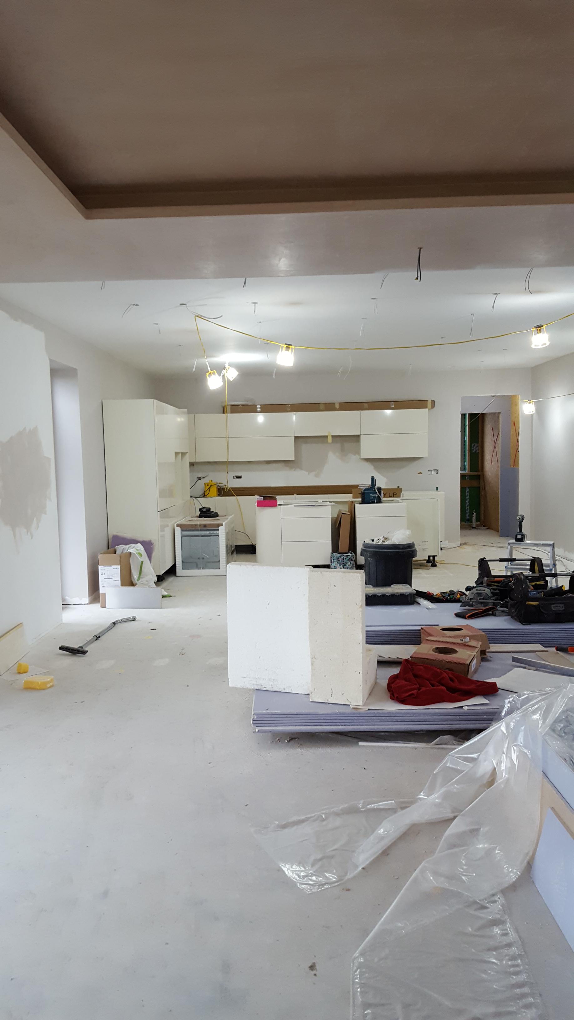

Once the inner ceiling was plastered, the framework itself was done the following day.  This photo is some way on from that, as you can see.  By this stage, the whole of the downstairs main room has been done and recesses formed for the spotlights at the other end of the room.
Not too long after this, the kitchen arrived from DIY Kitchens.  Lovely quality units and everything is going together well.  It did mean, though, that I had to get on with the painting up the kitchen end so that a start could be made on installation.

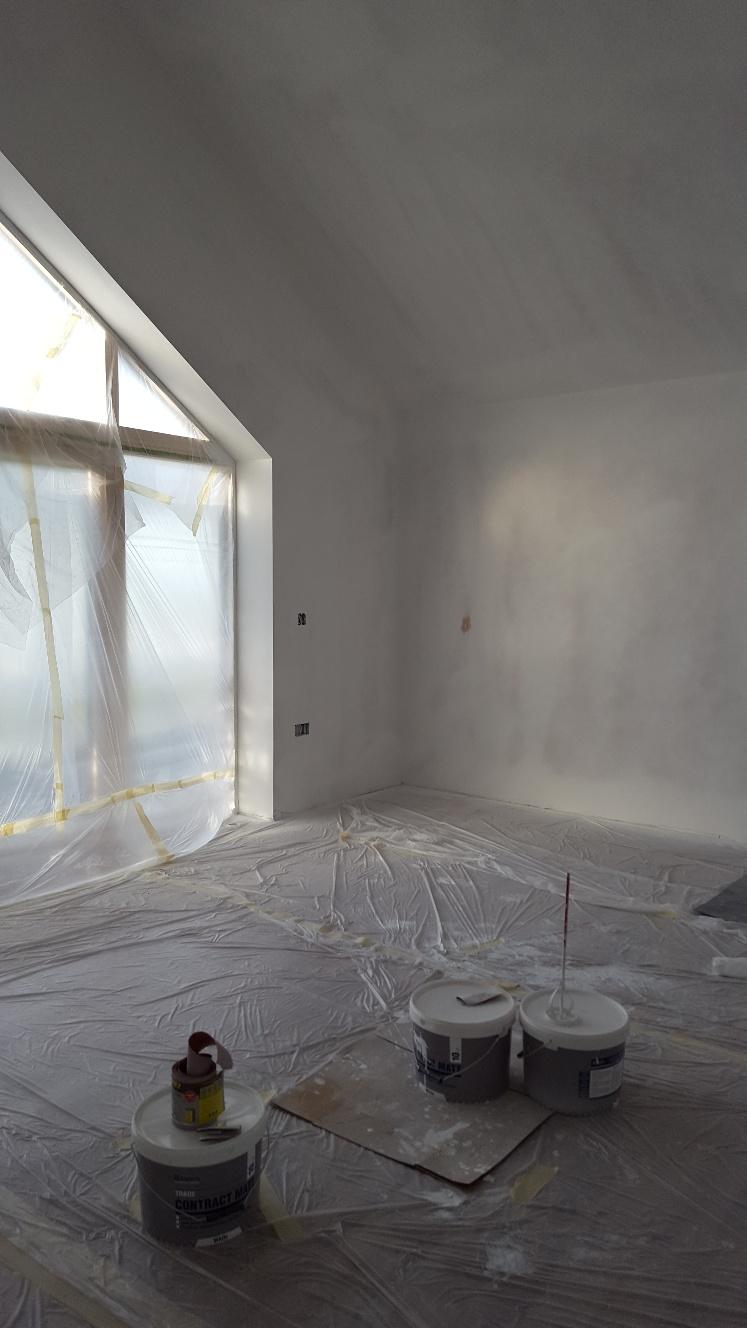

Here's one of the bedrooms, masked up and sprayed.

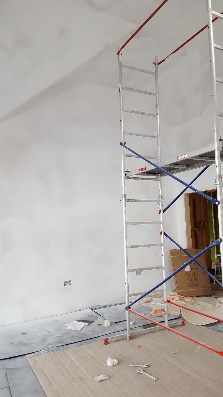

Here's another bedroom with that ceiling.  My scaffold tower came into its own for reaching up to those heights.

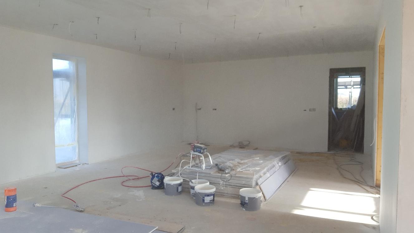

Then, finally, the kitchen area with its mist coat.  The sprayer is the little beastie sitting on the plasterboard.
I popped over on a weekend to also put the first colour coat on over at the kitchen area, whilst I could still get in easily before the kitchen started going in.  I'm having splashbacks between the wall and base units, hence the odd looking finish level with the paint.

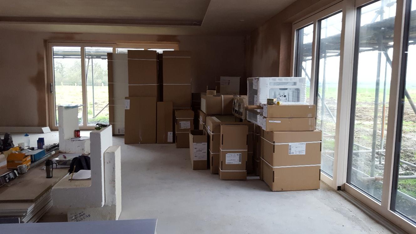

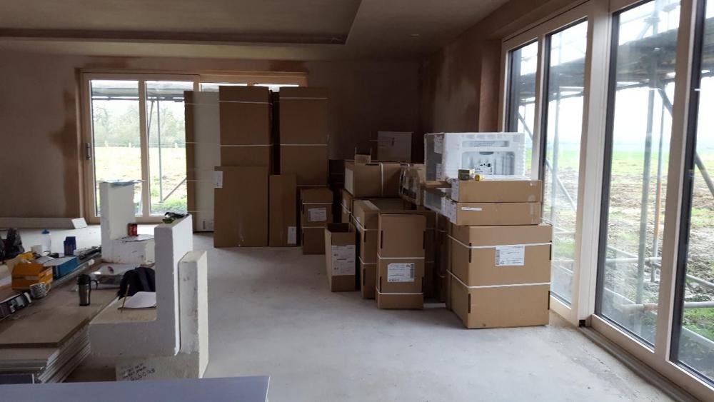

These were all the kitchen units as they arrived, prior to painting.
Everything was really well packaged and came with the doors on and drawers in.  The delivery crew were pleasant and efficient, so all in all, a good experience.

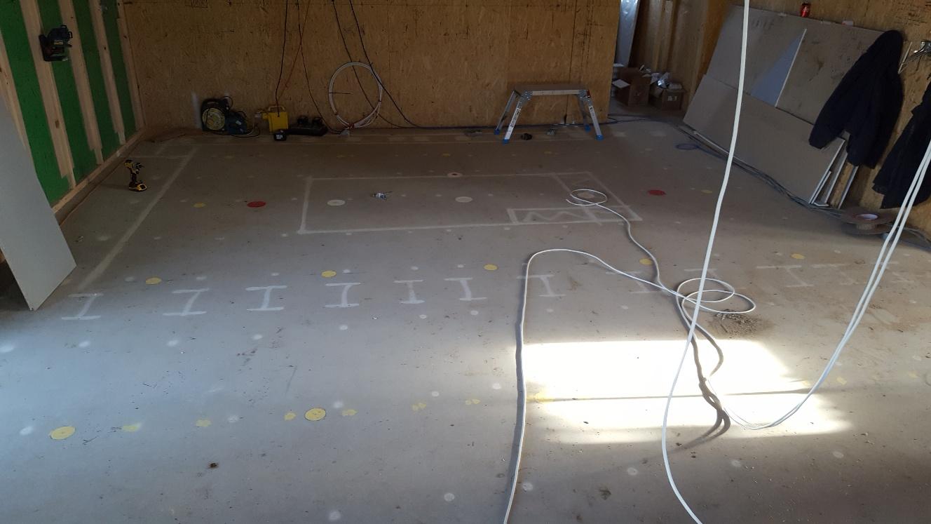

Moving away from painting and plastering, the ceiling plan for the lights was marked up on the floor, along with speakers and smoke detectors before the boards went on so that there was no guesswork involved in what was running where.  Here's the marking plan:

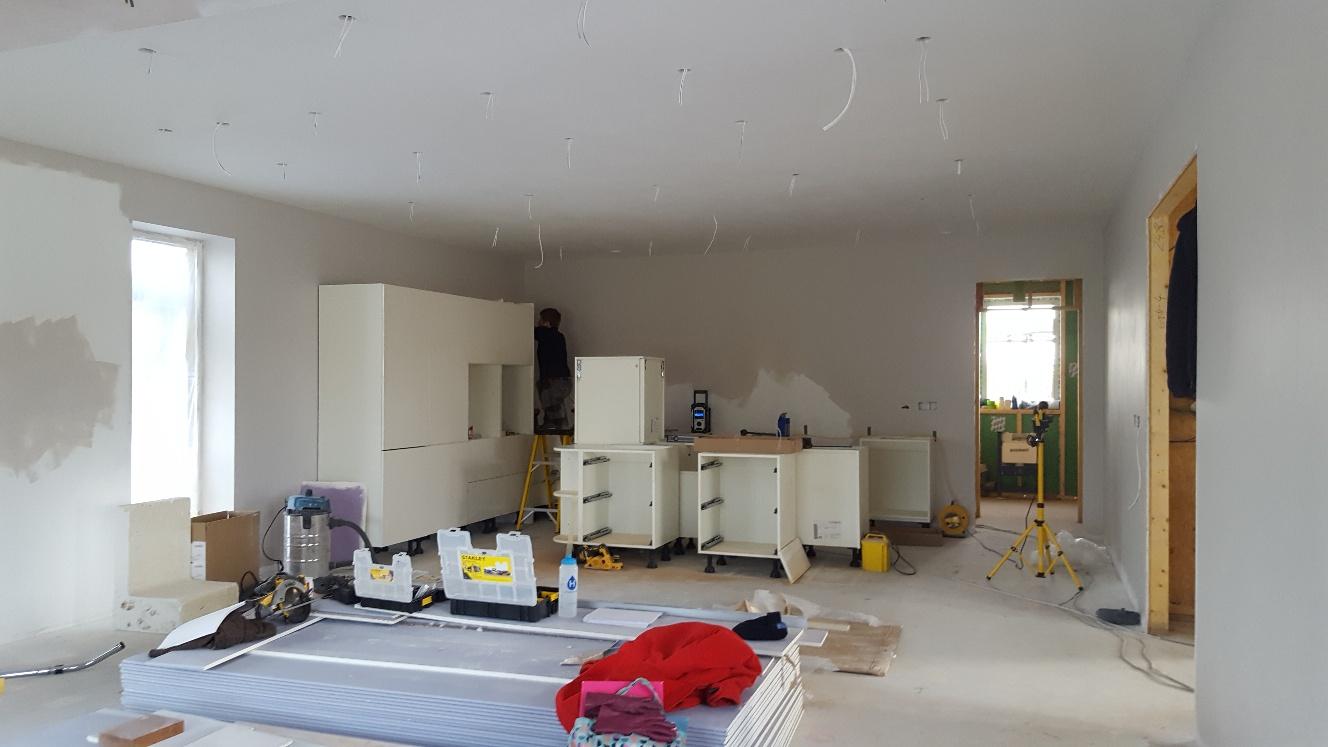

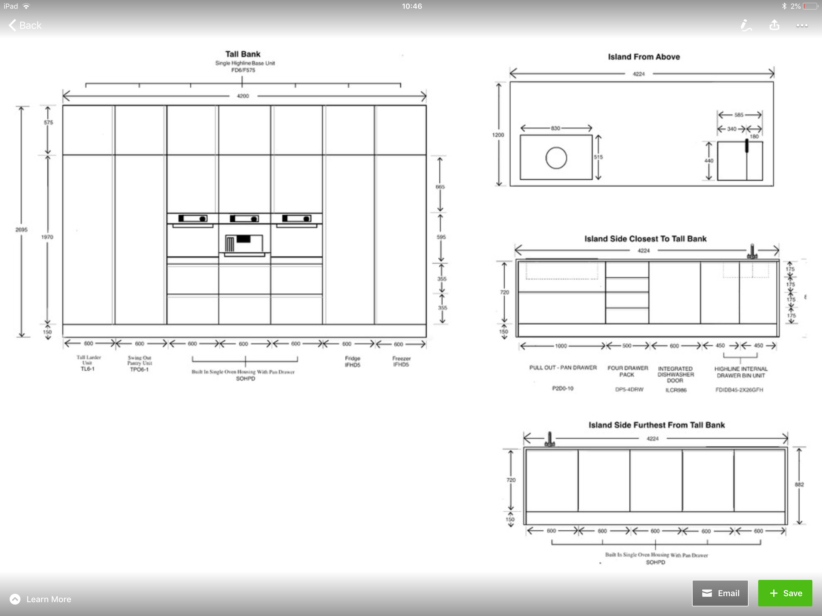

This is what the kitchen units look like at the moment.  I made a cock up in ordering, purely out of ignorance, and I'm waiting for a few end deco panels to arrive.  These didn't even occur to me as they will go between units and appliances to give a better appearance from face on.  It made perfect sense when it was pointed out to me, so things have halted temporarily until those and my worktops arrive shortly.  In the meantime, it's looking good:

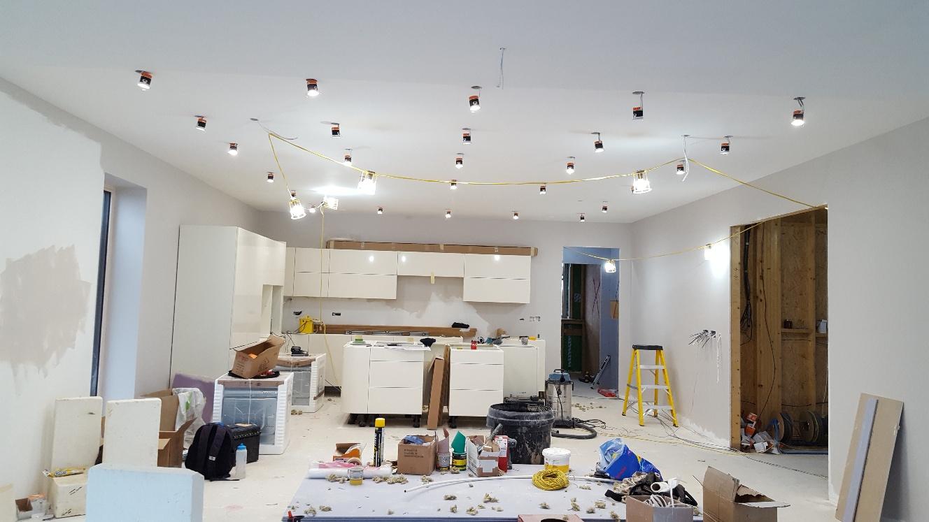

We also now have spotlights in place:

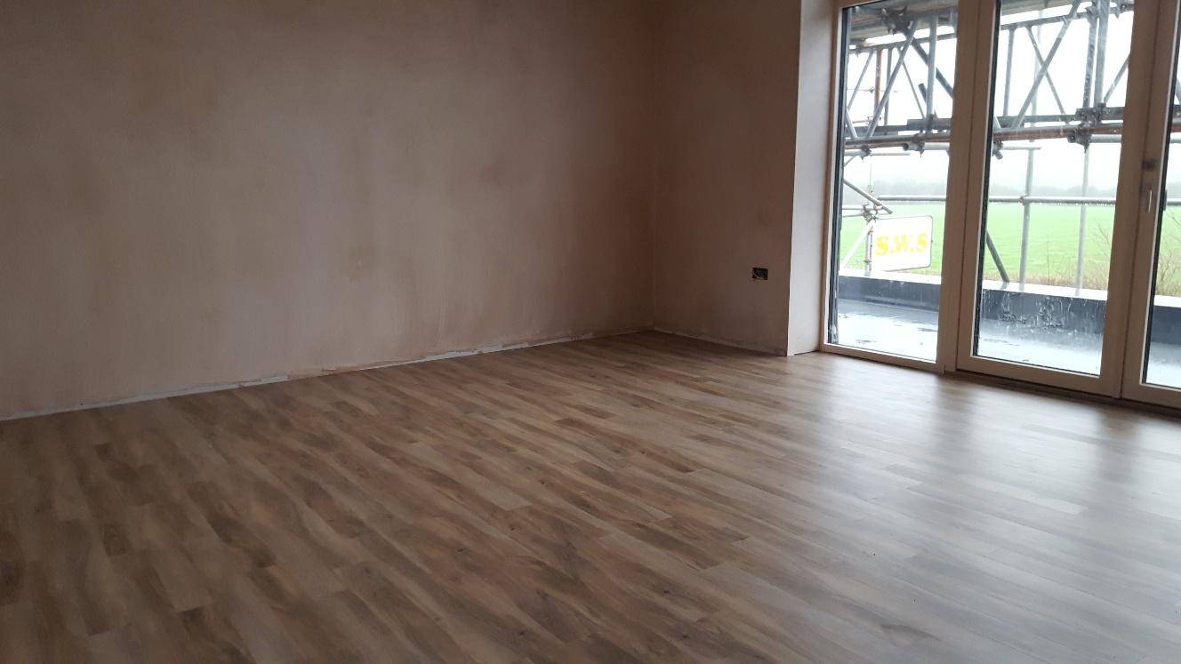

Finally, for the curious, this is what karndean flooring looks like.  It has been laid upstairs and the downstairs will be finished in a couple of weeks.  Upstairs, it was all laid on ply that was feathered in at the edges and downstairs will have a latex feathering coat to level the floor and provide an even base.

As always a really interesting read. How did the plasterers do the overhang for the led lights? I can see what looks like ply going up, then plasterboard and then a corner bead. Are there two corner beads to cover the depth of the combined ply and p/board or something different as I cannot make out from the photographs?
Thanks
vivienz
Posted
The front edge of the frame has a narrow upstand made from ply, which is what gives it the appearance of depth.  This was then beaded along the bottom edge and the whole thing was plastered.
Nickfromwales
Posted
Yup. Two beads abutting to give a decent 'chunky' appearance and create uber-sharp and arrow straight lines / edges. Plasterer was a demon for detail, and that's obvious in the quality of the final product. In all the vaulted junctions / intersections stop beads were used and skimmed in to for some of the straightest lines I've seen in a very long time. Top crew.

on the Karndean, what is the floor build up in mm on the ground floor slab?
vivienz
Posted
Oh dear, sorry for the top tip delat, Weebles.
The karndean will have a latex feathering screed put down first. Thus and the flooring itself will only come to about 6 or 7mm. Not much depth at all.

The scaffold tower is mine - about £250 as I recall and incredibly useful. I shall be keeping hold of that. I can assemble and dismantle it by myself and the variable platform height is useful. The PB lifter is on hire from Sydenhams but I would have bought one if I had known how useful it is but it's a bit late now.
