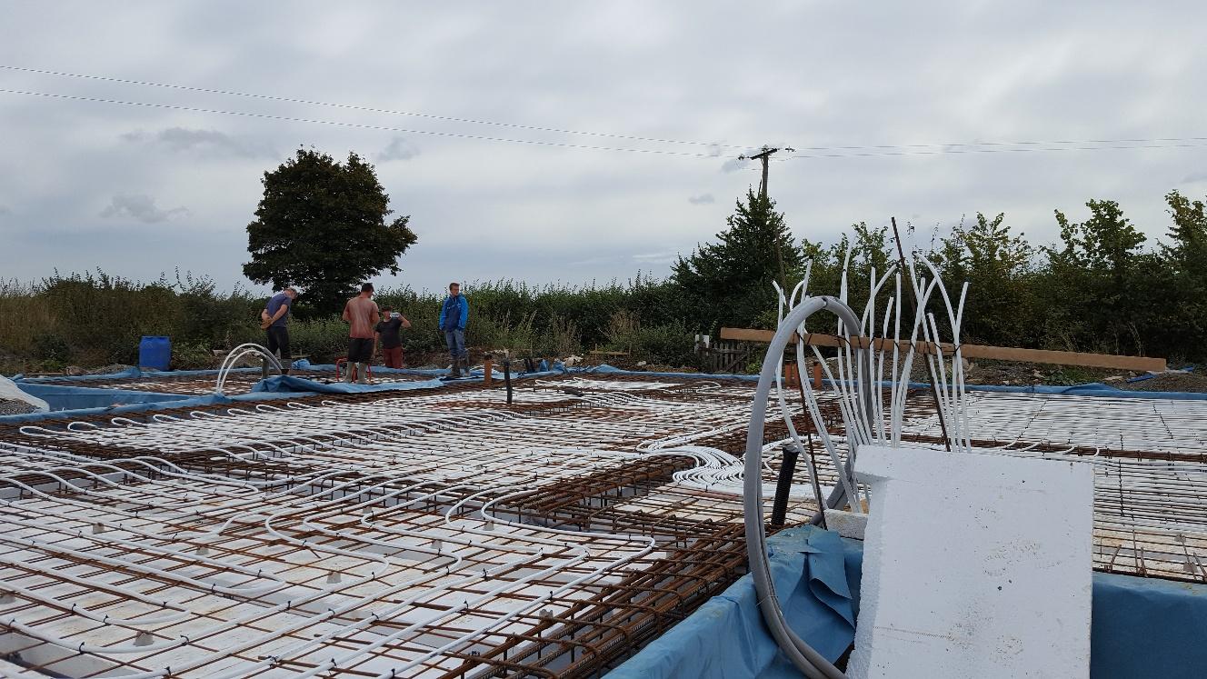

So, let's start at the beginning.  The slab team worked like frenzy yesterday morning to get all of the EPS down, followed by the mesh which then got tied into the ring beams.  After that, they put all the underfloor heating pipes in (there are several zones and many, many pipes to come into the manifold).  The building control officer turned up just before 6pm last night and gave everything the okay for the pour today.

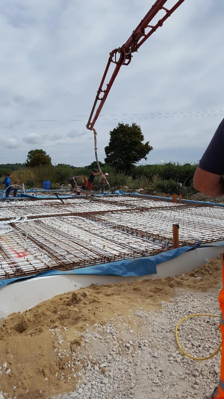

Here's the slab with everything on it first thing this morning, just waiting for the concrete, at shortly after 8 this morning.  On site already is the pumping lorry and one mixer of cement. Very exciting, so far, so good.
They started with the furthest part first, and the first lot of cement went onto the garage area, where the chaps are standing in the above photo.

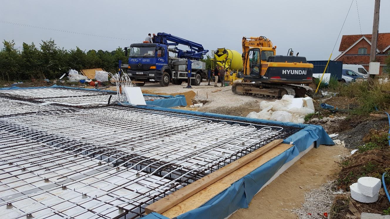

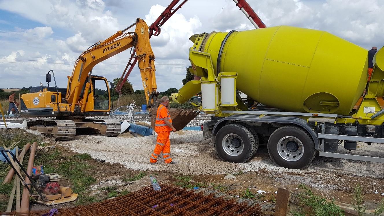

Here's the pump, concrete lorry and plenty of other equipment all good to go.
Except, it wasn't good to go.  Well, it was, because that's what it did in the end. Go, that is.  The concrete pump packed up and after a good while of trying to fix it, nothing was happening so off it went.
All wasn't lost, however, as one of the drivers was also a pump operator and offered to get a fairly old pump out of retirement and use that.  Brilliant!

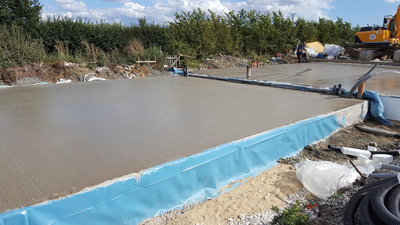

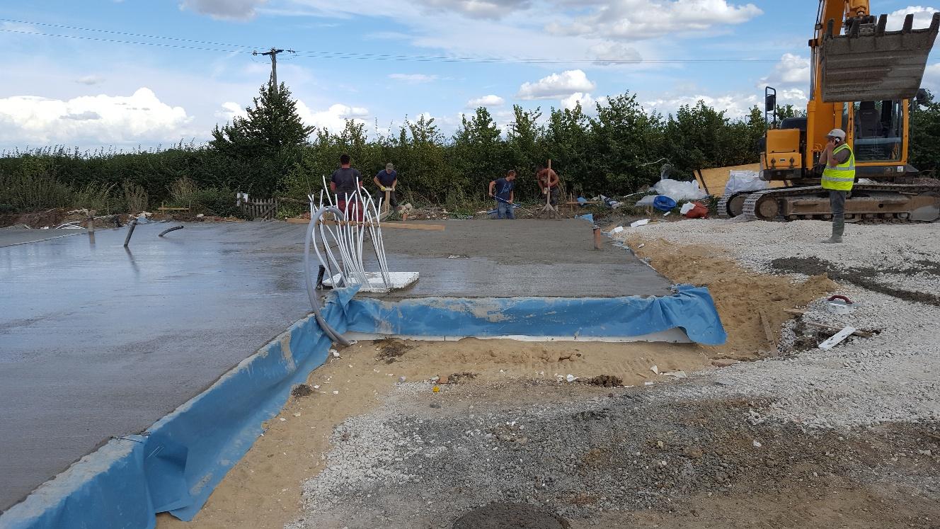

This is the ageing pump putting the concrete over to the garage.  Meanwhile, several hours have passed and after a bit of grumbling earlier in the morning about the concrete lorries not turning up on time, suddenly, they're coming thick and fast and are all parked up our narrow country lane.  Then the second pump got blocked and couldn't be cleared.  A very large man with a very large mallet did all he could to clear it, but it wasn't working. By now, it was nearly 2pm and the slab should have been poured a good few hours ago and power floating started.
Left with no other choice, Harry, who was heading up the team, got the bucket onto the whopping great digger and ALL of the rest of the cement got dumped onto the slab by digger, and then the guys had to drag it over to wherever they needed it.  This was for a floor area of about 180 sq metres.
Fortunately, there were 5 on the team today as they had brought in an extra guy to cover for one who was late back from holiday, but turned up straight from the airport to the site so the numbers were beefed up, and boy, did they need all of them today.

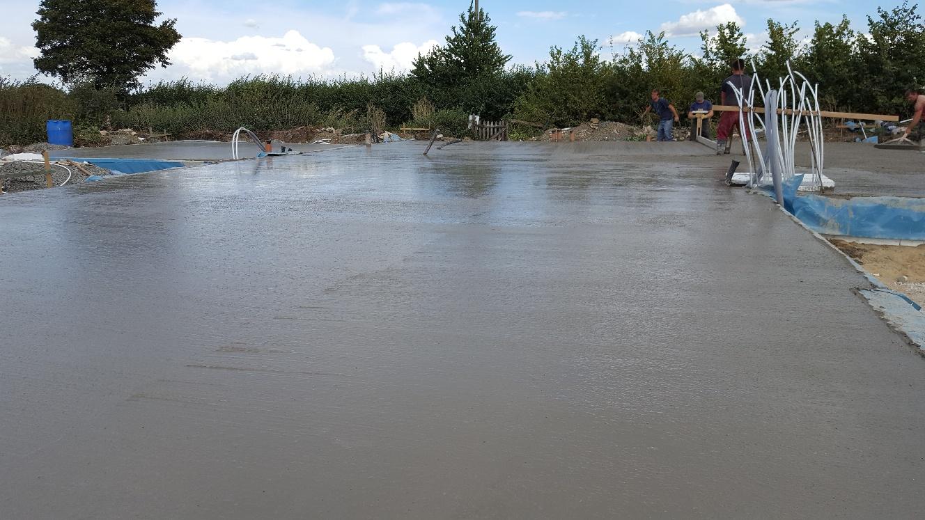

The garage slab was screeded (is that actually a verb?  Dunno, it is now), and was looking fine.
Eventually, the rest of the concrete got where it was supposed to be and the lane finally emptied of concrete lorries - there were 5 on or around the site at one point this afternoon.

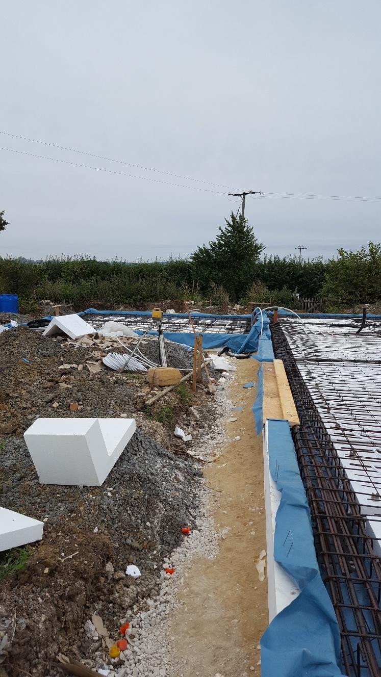

One final photo from earlier in the day has something of interest, as it shows the shuttering that was put in place on the threshold for the lift and slide doors that are going in the living room area.

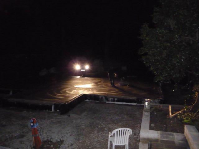

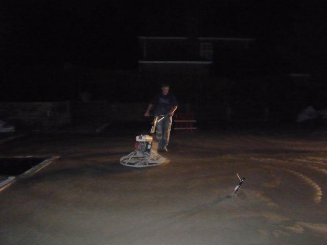

Been there, got the tee-shirt.
Our floodlit powerfloating experience was caused by concrete turning up late and the weather conditions. No floodlights, just the headlights of a MBC van. Brendan, MBC  working at 2200hr on a Friday, kept going with fish & chips
I delivered a curry to Brendan at about 10:30 on the night ours was done. He was just sitting there in the cold waiting for the concrete to go off so he could power float it. Unfortunately, it was the next morning until that was possible, and we didn't get a decent power float because of it. Cold weather and unexpected rain didn't help.
Link to comment
....the machines were turned off at 11.45pm on mine when the batteries to the mountain bike head torches ran out....
  • Sad 1
Link to comment
There's a theme here...
Our concrete arrived late and Brendan was still power floating the slab will into the night.  The problem seems to be that the power floating  can't start until the concrete has partially cured, so it only takes a bit of a delay or bad weather to mean that they have to work on into the night to get things finished.

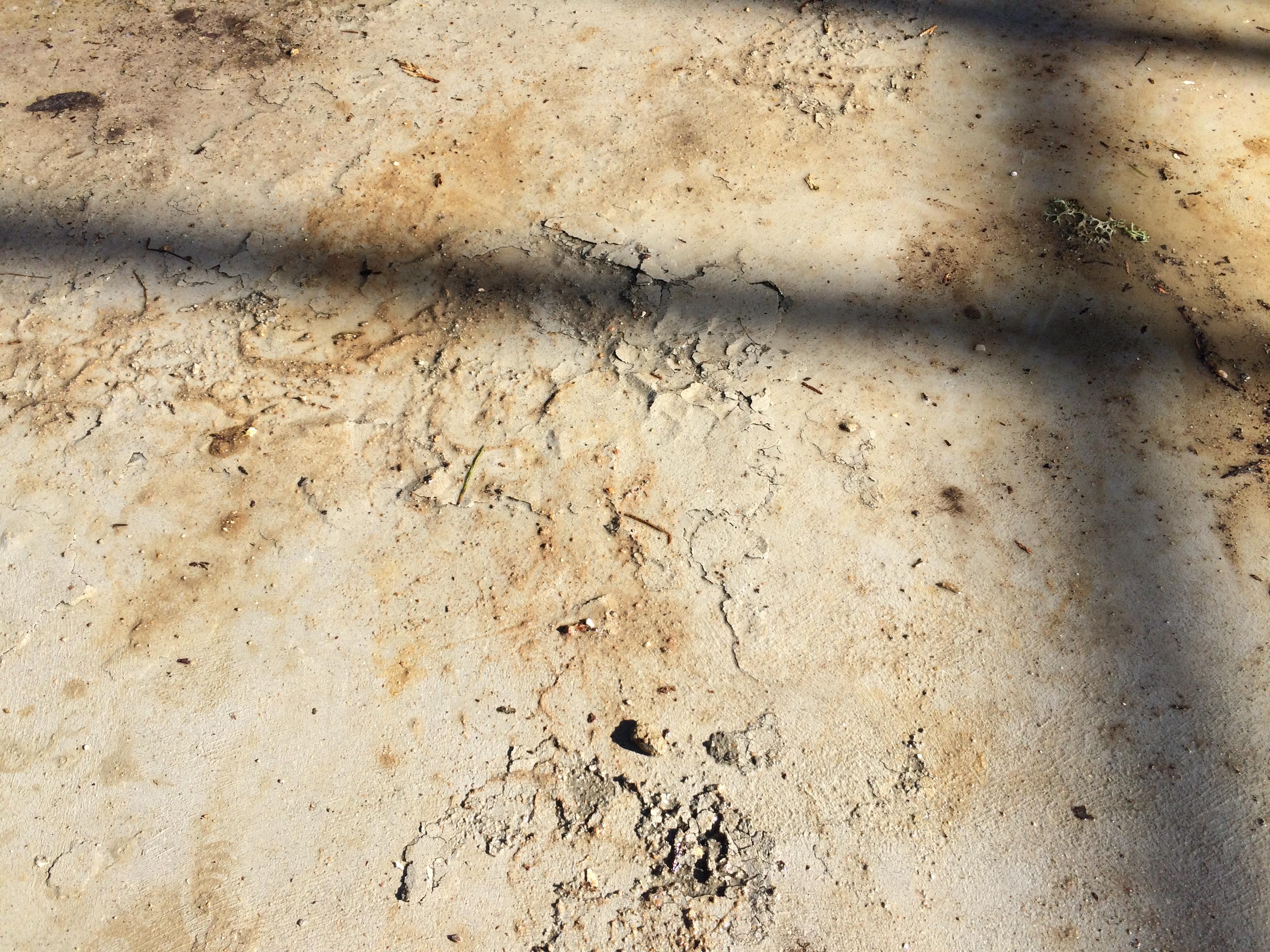

Our concrete arrived on time - literally started at 8 in the morning from memory, but the concrete just didn't want to go off.
I have a theory that the concrete in some sections of the slab contained far too much water (the concrete was mixed onsite by a truck then pumped via a boom). There were repeated calls from the MBC guys to the guy on the concrete truck reduce the amount of water being mixed in, especially earlier in the pour, but it kept creeping up. The worst areas seemed to be the earlier parts of the pour where this was happening, but that's completely unscientific speculation on my part.

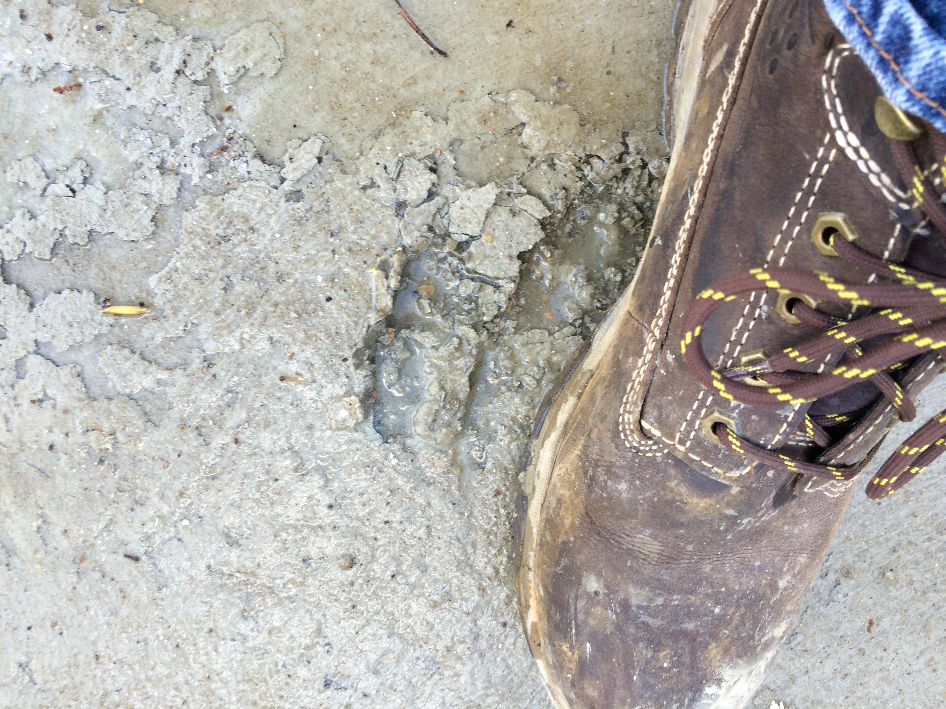

Despite all the efforts, our slab was a mess in the end. This was the worst bit, a week or two after the pour, I think:
You can see that the fat has just disintegrated from the top (possibly not helped by frosty nights in the days following the pour).
To his credit, Joe (MBC's owner) dropped by when I raised the issue and immediately offered to raise the frame by a small amount and pay for a liquid screed. In the end we decided to go with a concrete floor instead, so offered to hold back some of our final payment to make up the difference, which Joe was happy to do.
