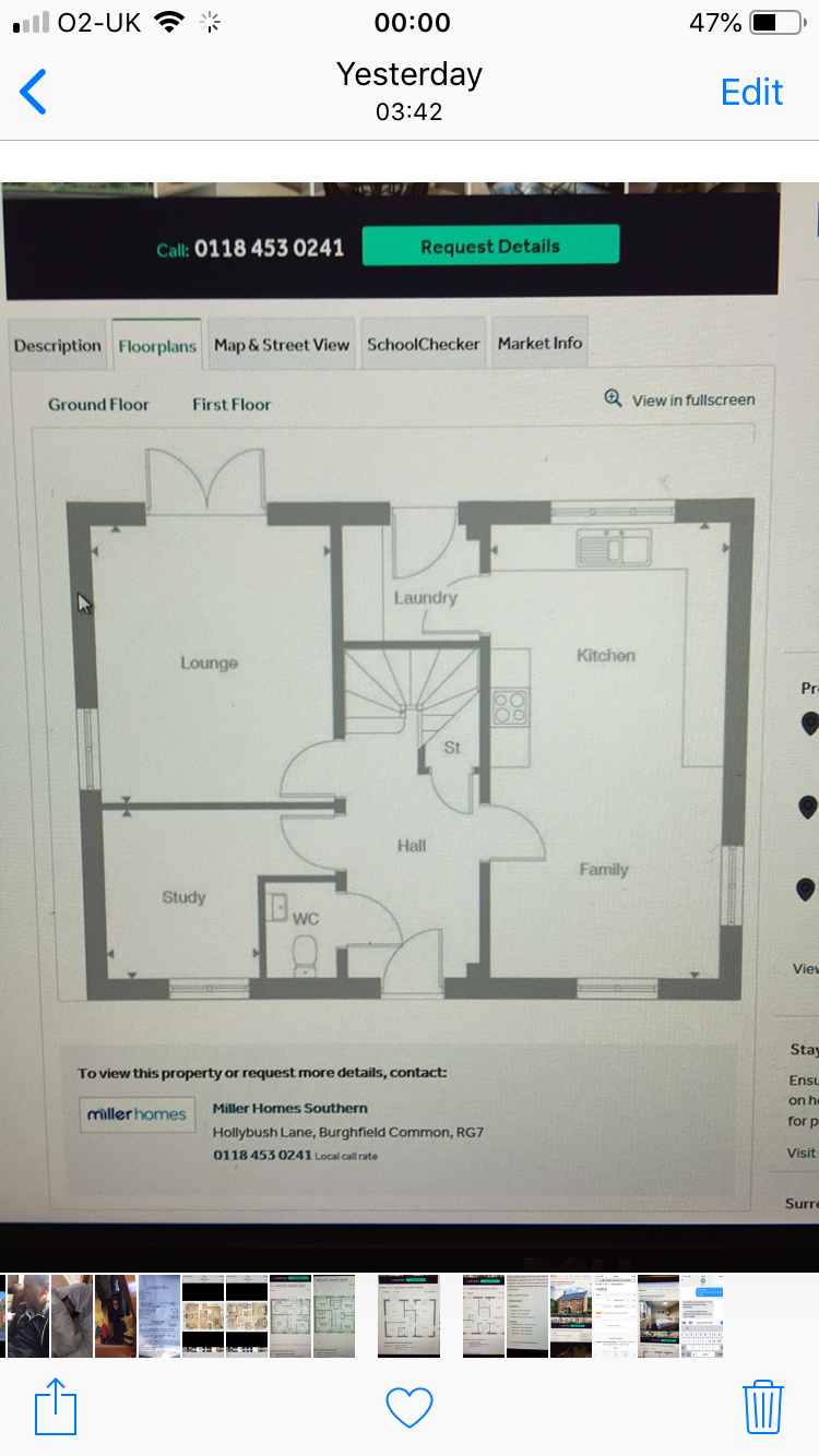

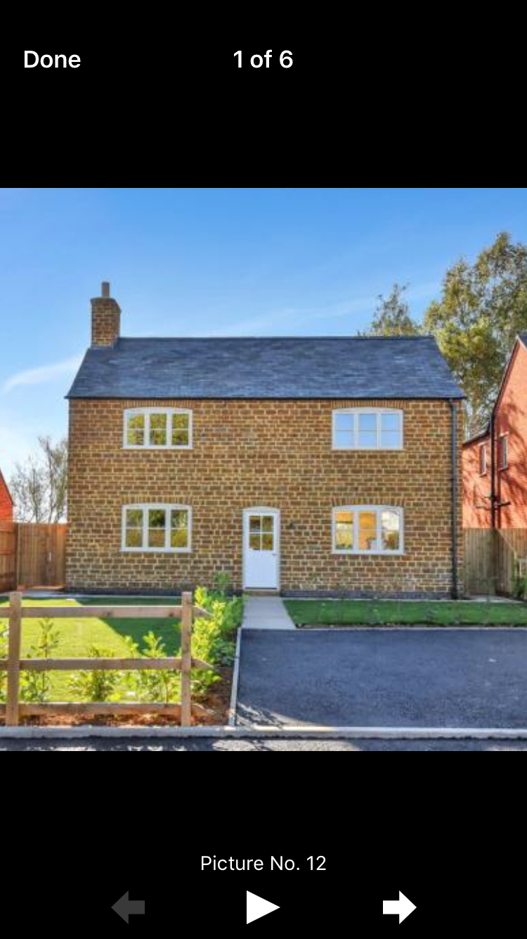

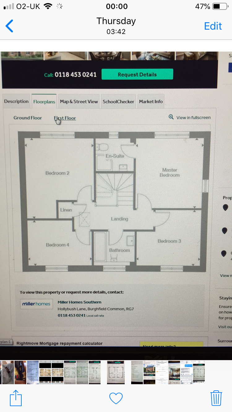

Dan1983 Posted June 3, 2019 Share Posted June 3, 2019 Evening all, Just looking to further my knowledge from my introduction post if possible before we commit to a build. We have had a slightly off putting experience with extension plans so abit cautious at the moment with submitting plans vs final cost etc. Looking to submit plans for a 137m2 house build with 68.5m2 foot print. The site is on a slight slope but the present bungalow has a larger foot print than the new build so hopefully would not require much mucking away after demolition. We are in Salisbury so in the south of England. We really don’t want to waste £1500ish on plans and regs again if budget is going to be out or tight again. Will be wanting a main contractor do do all the work to a fair/ good standard nothing flash, happy with howdens kitchens and bathrooms etc. The plot all ready has all services as existing bungalow here. Any advice would be great, we know it’s difficult to estimate as every build is different, we have a maximum budget of 240k for a build. Below would be the floor plan we would submit, brick built with slate or slate composite type roof tiles. Changes to the plans would be an oak porch and swap kitchen around to allow bi folds out the back. Thank-you for any extra input Link to comment Share on other sites More sharing options...
