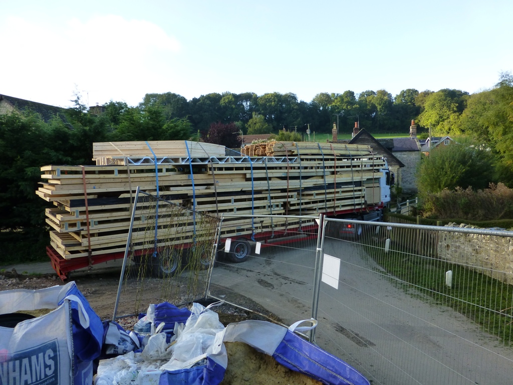

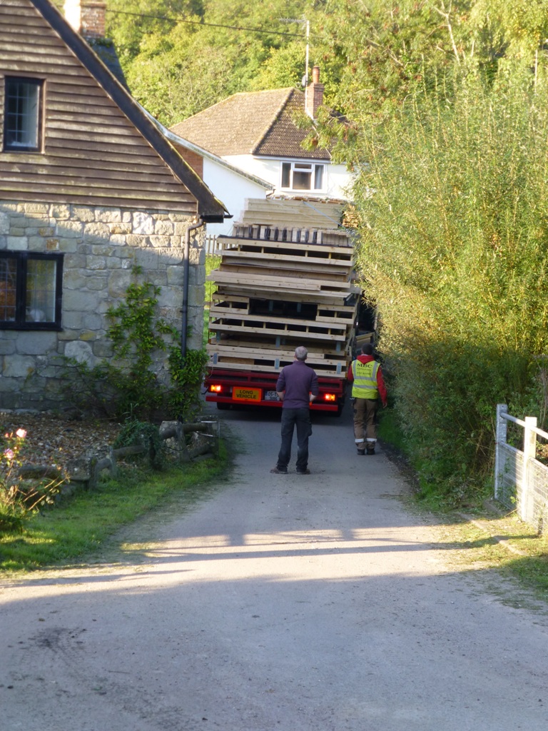

Jeremy Harris Posted May 25, 2019 Share Posted May 25, 2019 FWIW, I would have said our plot was pretty inaccessible. The lane is a single track, with a narrow bridge over a stream right by the entrance to the plot. The plot has a steep slope, too. However, our timber frame came all the way from Ireland and the truck "just" managed to back up through the 9ft 6" wide space in the lane: As well as that big truck getting to the site, we also had around fifty muckaway trucks, plus a dozen or so readymix concrete trucks, and a 100ft jib crane. Space was damned tight, but we learned early on that some drivers (notably not concrete truck drivers) seem able to do the near-impossible when it comes to manoeuvring in tight spaces. Link to comment Share on other sites More sharing options...

Mrs S Posted May 25, 2019 Author Share Posted May 25, 2019 3 hours ago, JSHarris said: FWIW, I would have said our plot was pretty inaccessible. The lane is a single track, with a narrow bridge over a stream right by the entrance to the plot. The plot has a steep slope, too. However, our timber frame came all the way from Ireland and the truck "just" managed to back up through the 9ft 6" wide space in the lane: As well as that big truck getting to the site, we also had around fifty muckaway trucks, plus a dozen or so readymix concrete trucks, and a 100ft jib crane. Space was damned tight, but we learned early on that some drivers (notably not concrete truck drivers) seem able to do the near-impossible when it comes to manoeuvring in tight spaces. Wow, I will pass this onto my hubby, thanks for this. We have a tight corner, and our architect and the builders have said TF and sips are out- but maybe there is a way. I think it’s also because we use our nearest neighbours road to access our plot and I believe they aren’t the most accommodating. Link to comment Share on other sites More sharing options...
