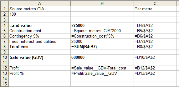

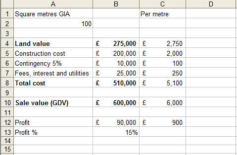

Mr Punter Posted May 24, 2019 Share Posted May 24, 2019 (edited) I use Excel's goal seek feature to obtain the residual land value based on the required developer profit. In the example below I use the feature to set the value of B13 to 15% by changing B4. Edited May 24, 2019 by Mr Punter Link to comment Share on other sites More sharing options...
