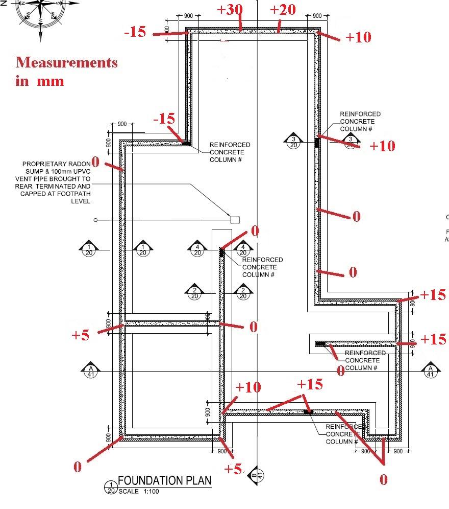

magnethead Posted May 15, 2019 Share Posted May 15, 2019 (edited) ok, So now I know foundations should be +/- 5mm . It is a bit late Can you tell me please how I would fix the problem below...at the top of the Strip, you can see where it goes from -15 to +30mm , 45mm over about 3M in length Can this be rectified? with some kind of Concrete grinding machine? I take it a kango hammer cannnot be used on a strip foundation. I have one week, before the ICF builder is back onsite, to start the rising walls. Thanks for any advice Edited May 15, 2019 by magnethead Link to comment Share on other sites More sharing options...

Mr Punter Posted May 15, 2019 Share Posted May 15, 2019 With some ICF systems it is possible to cut the blocks or chock them up a little. You could also consider a levelling screed. Ask your ICF people what they would suggest. Link to comment Share on other sites More sharing options...
scottishjohn Posted May 15, 2019 Share Posted May 15, 2019 (edited) lay a mortar bed to get it right FIRST ROW NEEDS TO BE PERFECT you have to get it perfect if you want rest of job to be easy some types of icf -like isotex /durisol its the way they tell you to start anyway if poly type you could mess about with packers +foam under first row to get it right if raising up height by 30mm is a problem --then trim first blocks down by an amount and then lay on mortar bed to get rest of it right thats what iwould do give the contractor that option --he lays first row to correct height ? Edited May 15, 2019 by scottishjohn 1 Link to comment Share on other sites More sharing options...
magnethead Posted May 15, 2019 Author Share Posted May 15, 2019 Hi, Yes, it was a contractor... I'm sure he'll come back saying I never specified that it had to be +/-5mm. With standard blocks you can level each course as you go up and I'm sure that's what he's used to. I'll give it a go anyway. @dpmiller yes the rising walls are ICF. Does anyone know what kinda equipment or procedure you would use/do to recify this? Link to comment Share on other sites More sharing options...
willbish Posted May 15, 2019 Share Posted May 15, 2019 I wouldn't want a 45mm mortar bed on the low spots. I think you need to take the high spots down by grinding grooves and then chiseling out the excess. Are you using stater track for your first course? The track I used was about 30mm deep and I put shims inside the track to level to the mm. Link to comment Share on other sites More sharing options...
scottishjohn Posted May 15, 2019 Share Posted May 15, 2019 yes on second thoughts --cut and grind down to zero as @willbish says , any other mods could leave you with funny size blocks further up the build . or just trim blocks where its too high so the height from zero level on foundation ends up same all way round at top of first row --all mods done in first row of blocks that might be quicker ,should be easy with a laser line set to hit 10mm from top of block ,so you can see it on block polystyrene cuts with a knife Link to comment Share on other sites More sharing options...
ToughButterCup Posted May 15, 2019 Share Posted May 15, 2019 1 hour ago, magnethead said: [...] Can this be rectified? [...] Yes, I am sure: from experience (with Durisol) , I know it can be done in one of four ways Grind the concrete Shim the blocks Trim the blocks Lay a 'correction' mortar bed during the build of the blocks A combination of all three (should have said five above ?) I gulped when I saw your numbers: my sincere commiserations 's not funny. Can I ask before I make any further suggestions, which ICF are you using? Link to comment Share on other sites More sharing options...
magnethead Posted May 15, 2019 Author Share Posted May 15, 2019 (edited) Thanks Lads, for the excellent replies. Yes @willbish there will be starter track I'll get the grinder out now and do my best to level a track for the ICF (300mm) in width thanks @AnonymousBosch , yes it's a bit of a disaster , the brand is Thermohouse. Edited May 15, 2019 by magnethead Link to comment Share on other sites More sharing options...
magnethead Posted May 15, 2019 Author Share Posted May 15, 2019 I just spoke to the contractor and he says he can work up to 15mm out.....so it will just be the very top foundation strip that i need to correct. Link to comment Share on other sites More sharing options...

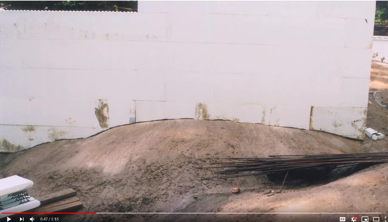

Alexphd1 Posted May 15, 2019 Share Posted May 15, 2019 I remember a bit on a nudara icf installation video of them doing big cuts for uneven surface. Link to comment Share on other sites More sharing options...

magnethead Posted May 15, 2019 Author Share Posted May 15, 2019 This gives me hope Maybe ICF can get me out of this hole. Link to comment Share on other sites More sharing options...
