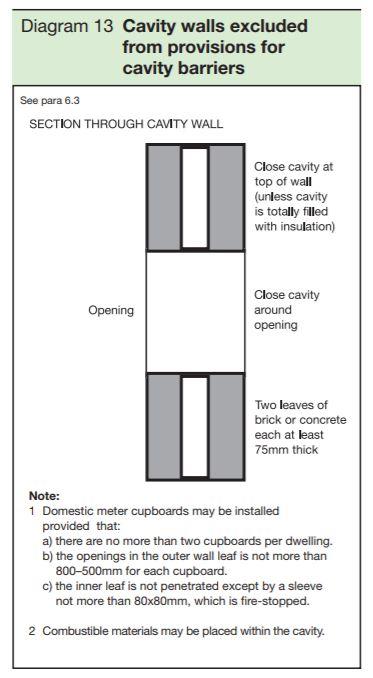

Ian Posted May 3, 2019 Posted May 3, 2019 (edited) On 02/05/2019 at 01:39, Triassic said: Following on from the discussion about poor build quality? Can we discuss fire barriers in timber frame houses, what are they, where do they go and what are they made of? I'm not sure why you would need fire barriers in a normal 2 storey detached house unless you have an attached garage. In England & Wales they are not required unless you are building more than 2 storeys or building terraced or semi-detached housing where fire separation is needed on the party walls. Timber frame houses are no different from masonry ones Edited May 3, 2019 by Ian

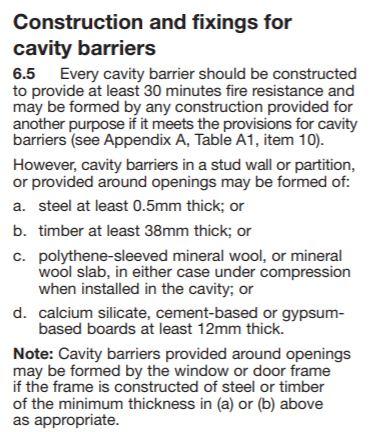

Ian Posted May 3, 2019 Posted May 3, 2019 (edited) 30 minutes ago, Mr Punter said: They are when a fire gets into the cavity, because timber is flammable and masonry is not. The only requirement in the Building Regs is that the cavity is closed at areas such as windows & door positions. The regs list a wide range of suitable materials including timber that can be used to close the cavity at these positions. Edit to show extract from English building regs AD Part B Edited May 3, 2019 by Ian
ADLIan Posted May 3, 2019 Posted May 3, 2019 Above diag only refers to masonry leaves not timber frame. 1
Visti Posted May 3, 2019 Posted May 3, 2019 As Ian says, it can be any material listed of the appropriate thickness that'll stop the fire progressing for at least 30min. I think the issue is less with Timber Frame vs Masonry construction, but rather more to do with how you clad it: Fire resistant material or render - you're ok. Timber - got to have a ventilated cavity It's the ventilated cavity that causes the added requirements, because you can't seal it off 100%... it's got to be ventilated right? At that point you've a cavity between the external wall and your cladding that will need a barrier around the structural openings (doors and windows) as per 6.3, but can't span the whole cavity due it needing ventilation. That is why we're using those barrier strips. If you're using fibre cement rather than timber cladding you should be fine as there'll be no cavity to consider.

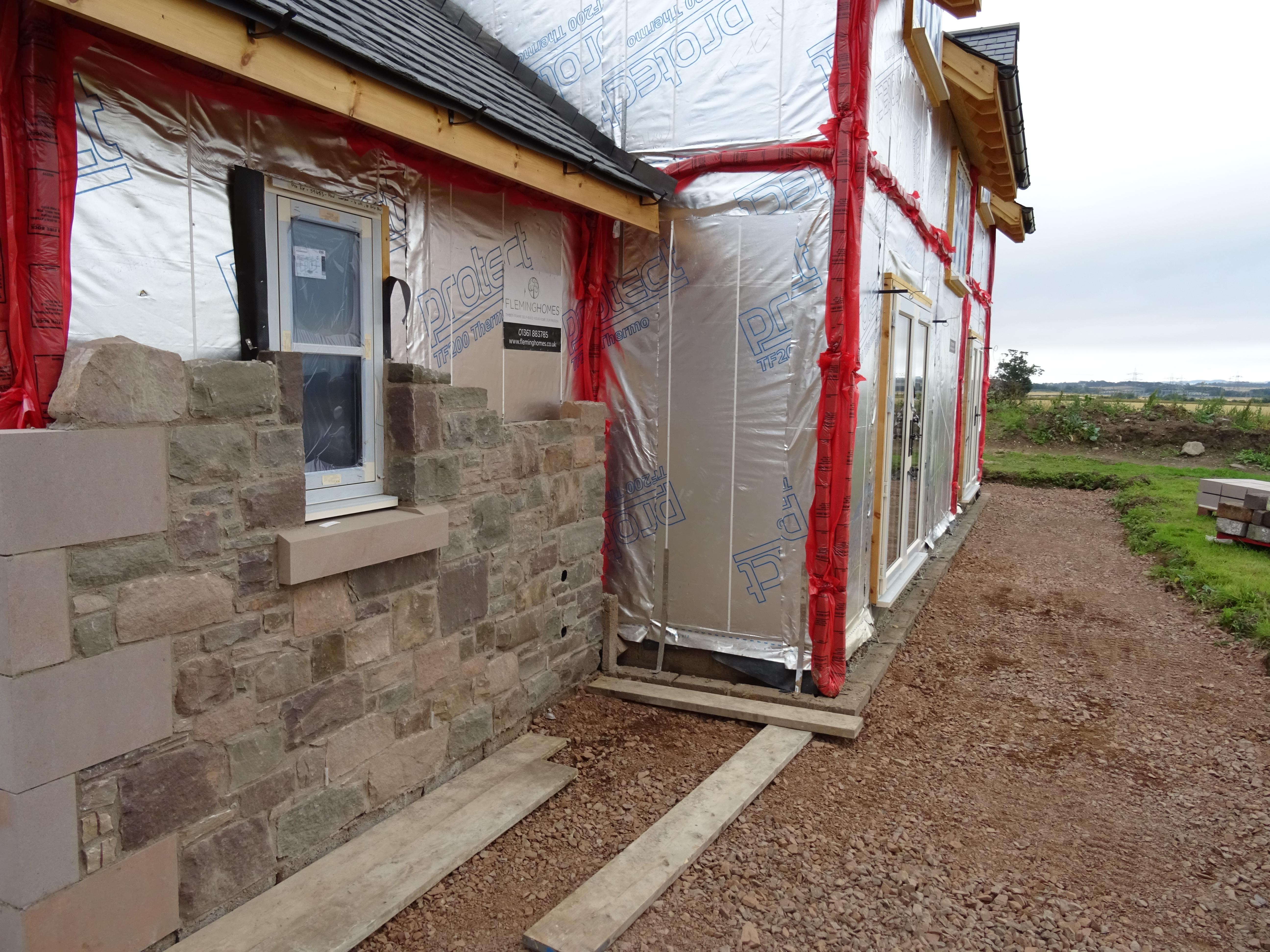

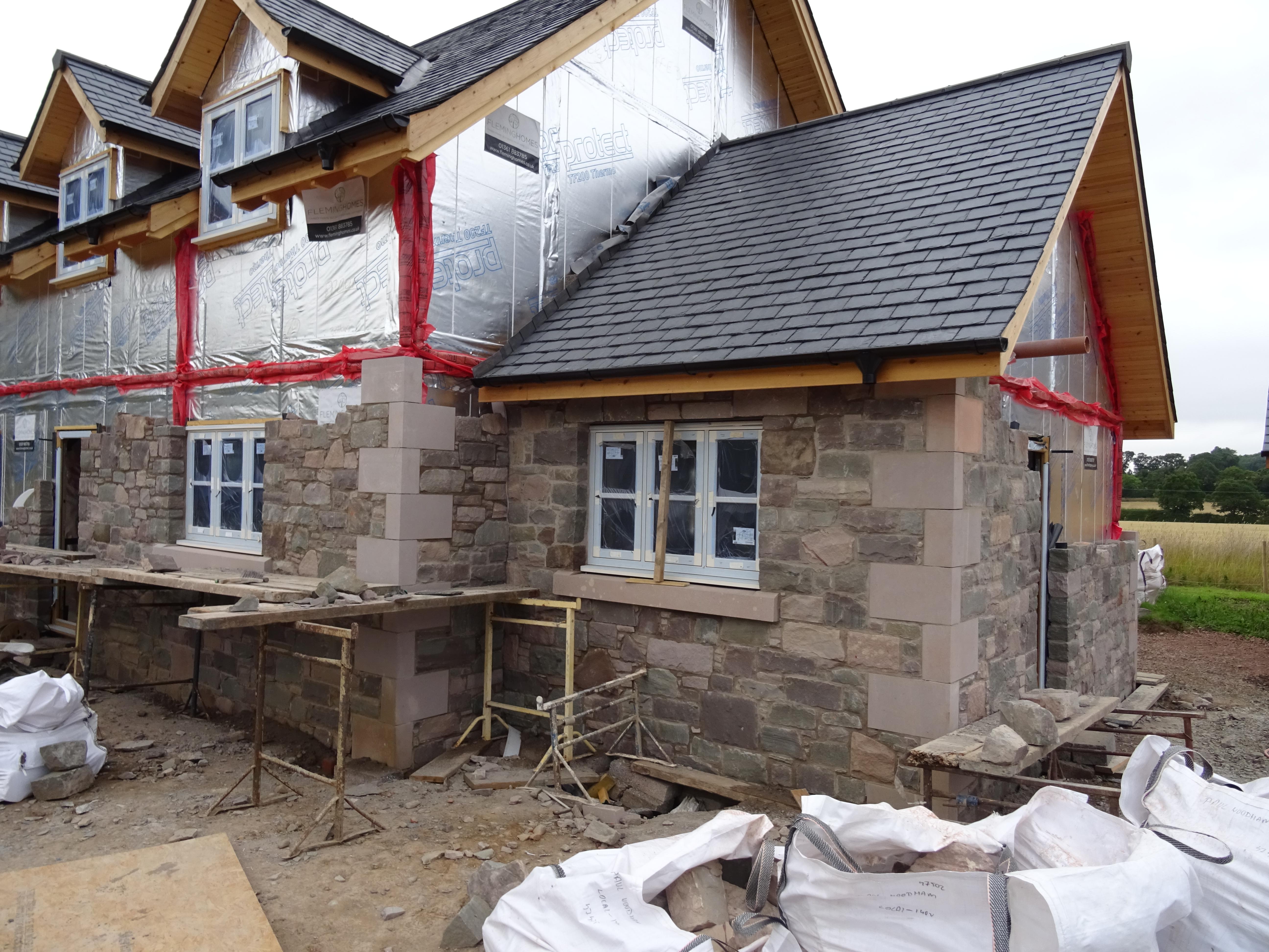

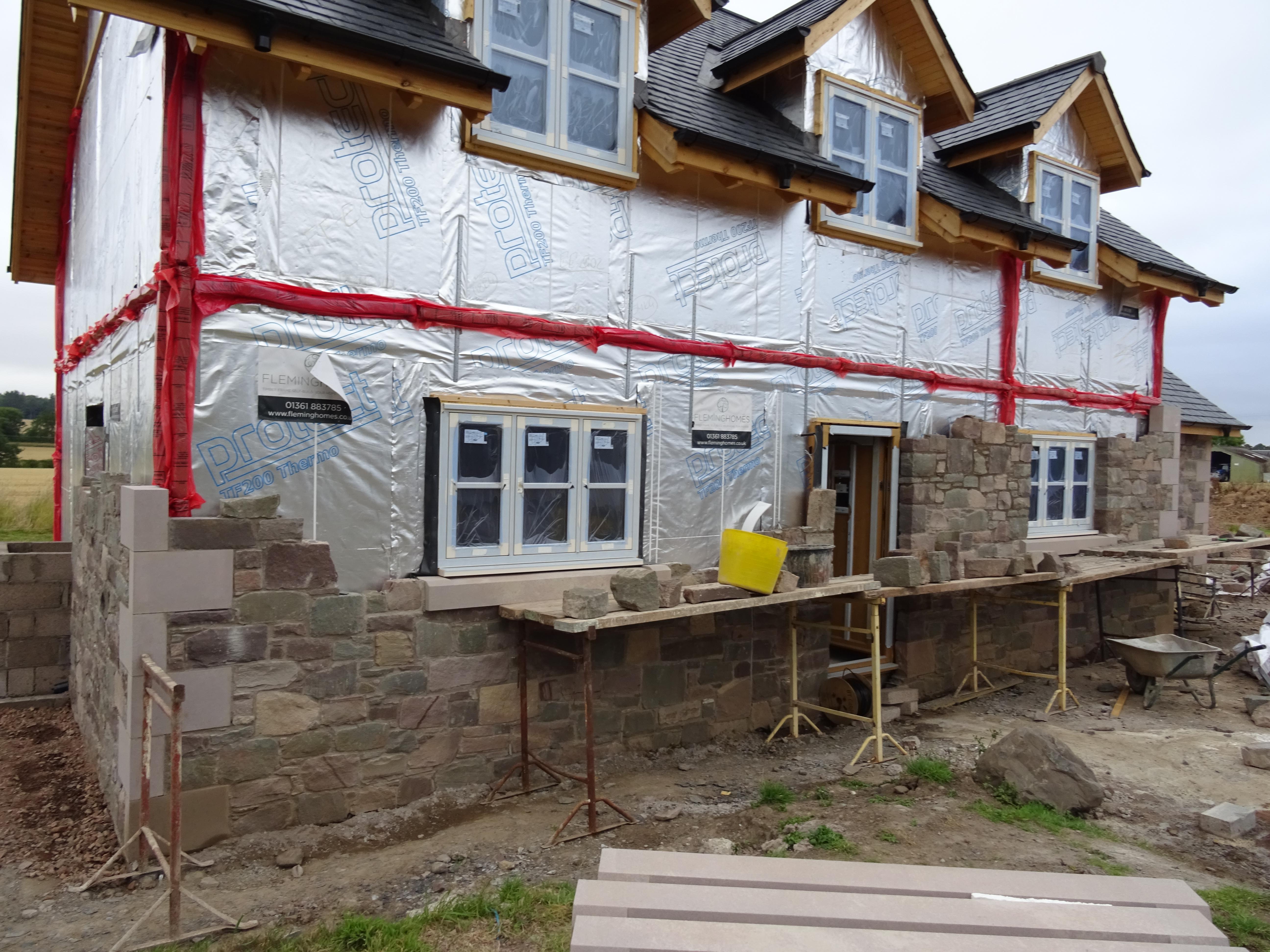

Redoctober Posted May 3, 2019 Posted May 3, 2019 @Triassic - We built with a TF and they supplied the fire battens which were really what as been described as above - we called them "socks". See the photos for where they were positioned. We used wooden battens to go around the window and door openings. I hope this helps. 1
scottishjohn Posted May 4, 2019 Posted May 4, 2019 @Redoctober thank you a very nice example of where to fit fire stops + good looking house and I presume they are nailed to the frame not stuck to the house wrap,cos if that caught fire they could fall off never seen any on houses built up here when under construction and certainly my own house built( 1978 Tf) does not have any . when I moved in and started looking for savings i found the air bricks were not ducted to the sub floor area --just a grille through outer brick and then a hole in the inner sub wall, force 9 gale up the void between outer brick and TF ,and definately no fire stops around penetrations like the bog pipe going from top floor to sub Floor. and top of the cavity wall open where it meets the loft. when did the requirement for firestops come in? 1
Redoctober Posted May 4, 2019 Posted May 4, 2019 16 minutes ago, scottishjohn said: @Redoctober thank you a very nice example of where to fit fire stops + good looking house I presume they are nailed to the frame not stuck to the house wrap,cos if that caught fire they could fall off when did the requirement for firestops come in Thanks - yes nailed on and as for when the regs changed, I have no idea. Sorry.
