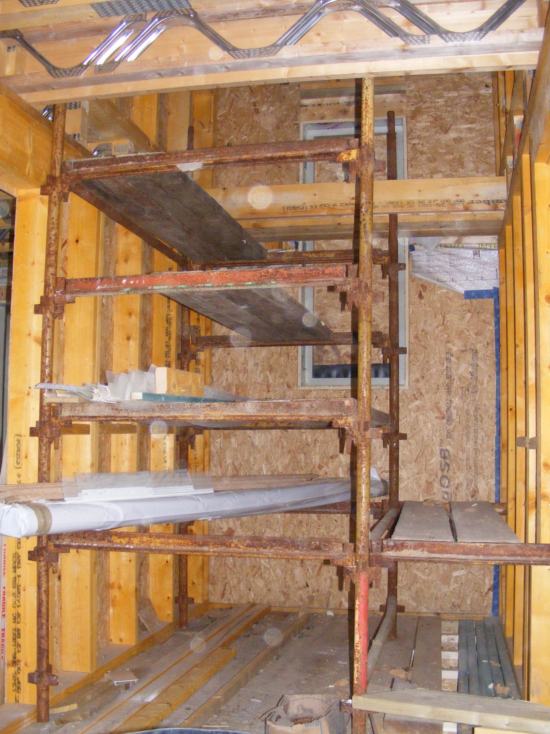

ProDave Posted August 27, 2016 Share Posted August 27, 2016 I have a "scaffold staircase" 6 "treads" each 2 scaffold boards wide, and 0.5m rise per "step" So it's big steps put perfectly do able to walk up them, and big items can be lifted up a "step" at a time. That's how all my windows got up to be fitted from inside. I'm out all day but I'll try and post a picture this evening. 1 Link to comment Share on other sites More sharing options...

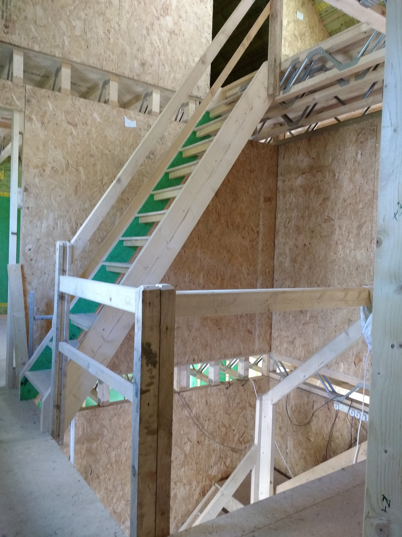

TerryE Posted August 27, 2016 Share Posted August 27, 2016 (edited) I used a couple of unused roof rafters as stringers and made up 13 stair cassettes in a jig again out of some left over floor board and OSB. Cutting the bits was trivial, given that I have a table-saw and chop-saw. The design, cutting and jigs were my work. Each cassette was made of two parallelograms of OSB, a floorboard tread with under brace. Jan assembled the cassettes (screw and glue), and then screwed them into the stringers one-by-one from the bottom working to the top. When she got to the top, all that remained was to add the rails. Here is the final result below. It's pretty steep because the final stair will include a ¼ turn, and this was a straight span. Still, a damn sight easier to go up and down than a ladder or the like. We added rails and the 1st staircase was going to be used a lot more so I did do this as a ¼ turn. OK, I am a pretty handy carpenter, but doing this is easy and the cost for me was a box of wood bolt fixings, so about £5 IIRC. The rest was leftovers from the frame erection. The stairs are designed to be taken apart for plastering and reinstalled until we fit our permanent stairs after we've painted the halls. I personally take a different view to Dave and Peter. If you are anything like us, then you'll be going up and down the stairs 100s off times carrying kit. You need proper stairs and banister rails, even if temporary. If you aren't confident making your own then do as Nick suggests as buy a cheap flight on eBay or whatever. My only regret is that if I'd realised that we were going to use the stairs for a year then I'd have built a ¼ turn upper stair as well (to bring the pitch under 45%). Edited August 27, 2016 by TerryE 2 Link to comment Share on other sites More sharing options...

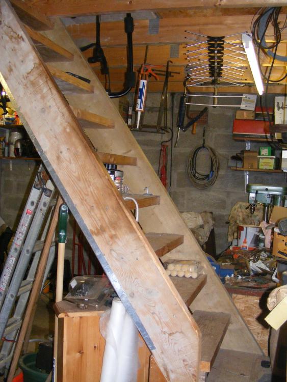

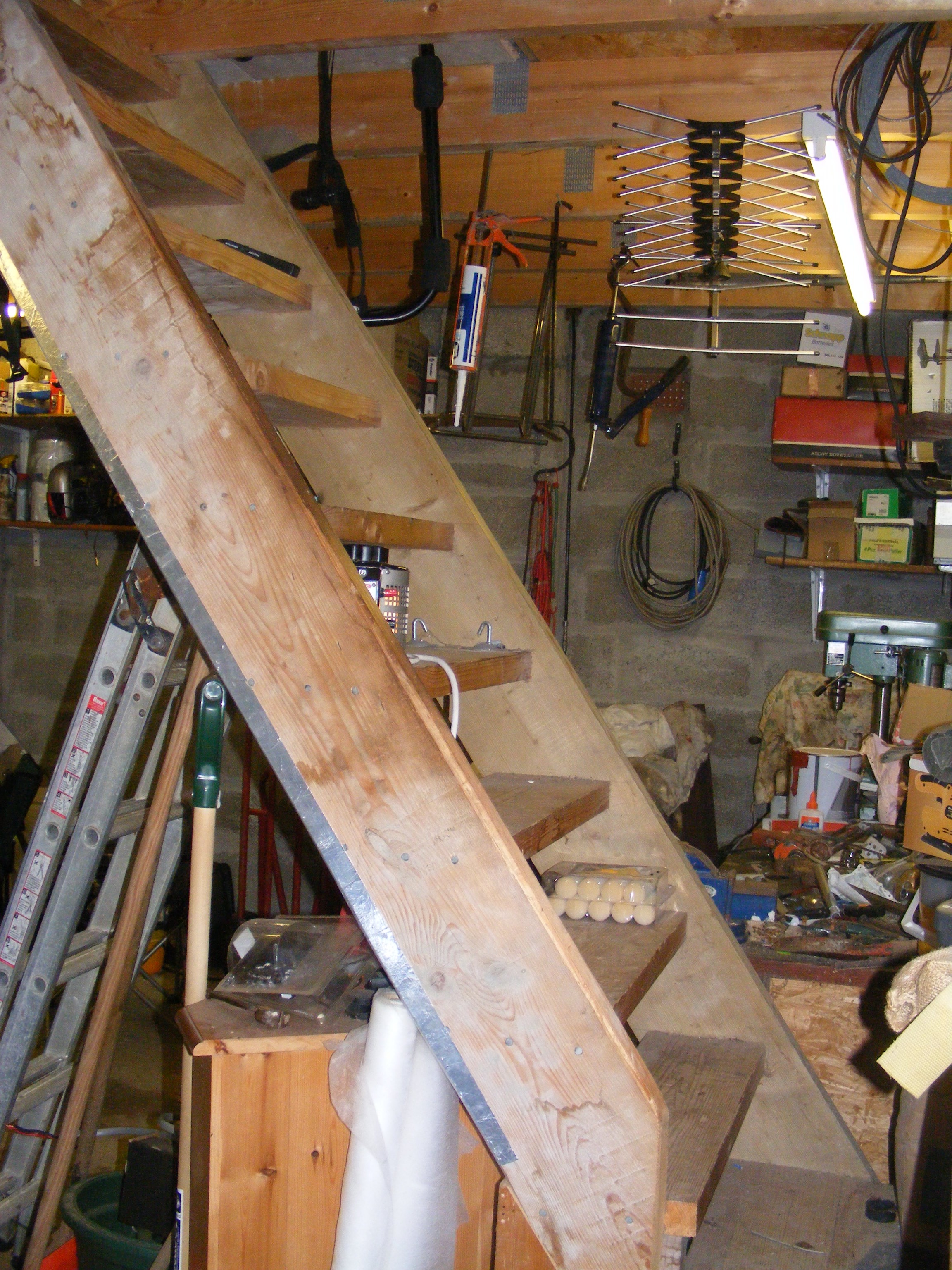

ProDave Posted August 28, 2016 Share Posted August 28, 2016 Here's my "scaffold stairs" that are serving me at the moment. I think part of the reason for me not wanting to fit a temporary set of real stairs, is mine will have a half landing and return, so it's a lot more complicated than just bang in a cheap set of mdf stairs. But here is what you can make cheaply. These are my garage stairs in my present house. the upstairs of the garage is technically only a storage platform so these are not meant to comply with regulations. they are in effect a permanent ladder. they are made from leftover bits of 8 by 2, and (you can tell I am not a joiner) each tread is just fixed to the stringer with three 6" nails. 1 Link to comment Share on other sites More sharing options...

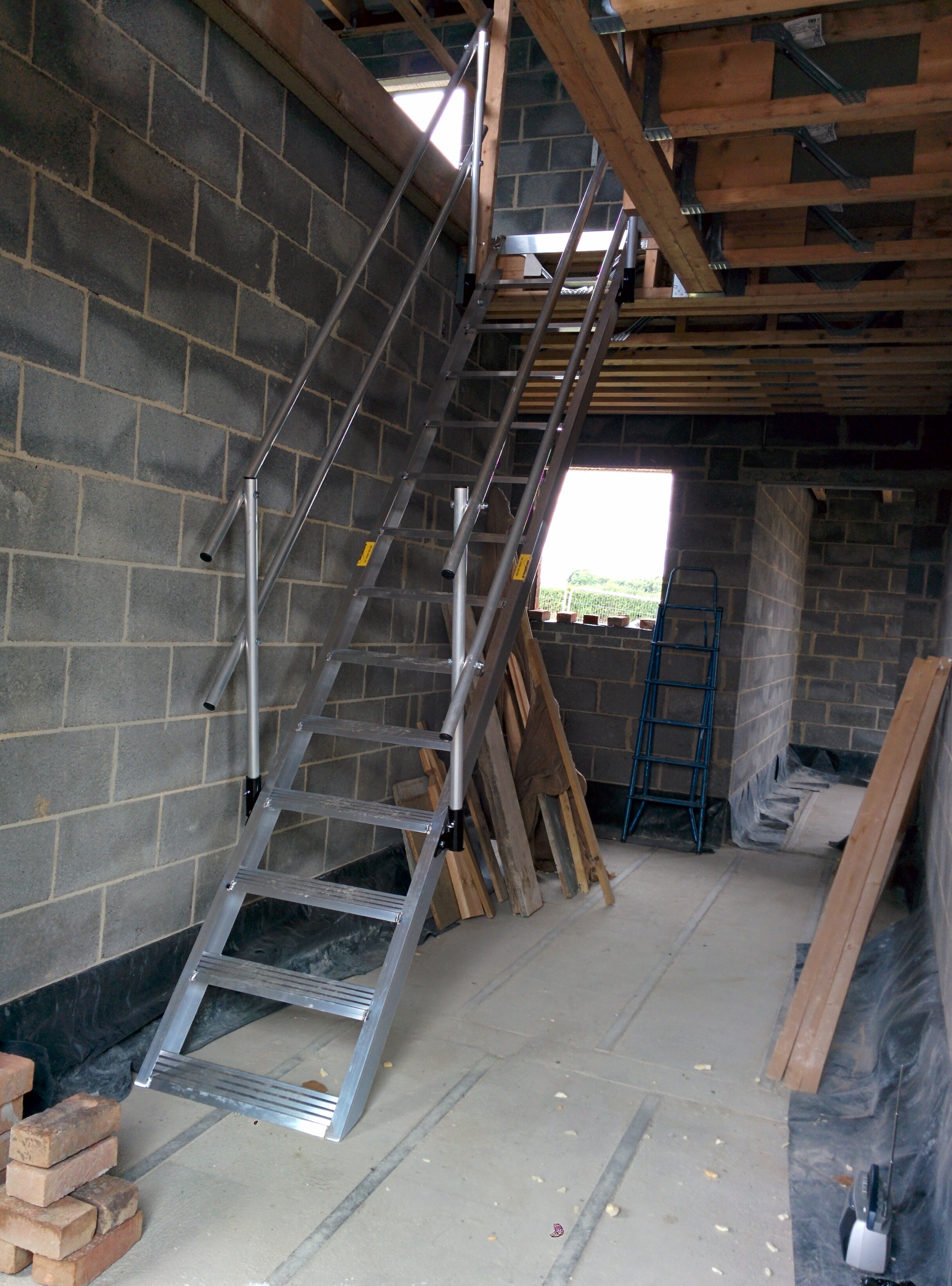

readiescards Posted October 8, 2016 Author Share Posted October 8, 2016 In the end I went with a Speedistair from Ladders999, really pleased with it. Hope to sell it on afterwards too 2 Link to comment Share on other sites More sharing options...
ProDave Posted October 8, 2016 Share Posted October 8, 2016 How much did that cost? Link to comment Share on other sites More sharing options...
readiescards Posted October 8, 2016 Author Share Posted October 8, 2016 £550 + VAT + free 2 day delivery Link to comment Share on other sites More sharing options...

readiescards Posted April 27, 2017 Author Share Posted April 27, 2017 Link to comment Share on other sites More sharing options...
Nickfromwales Posted April 28, 2017 Share Posted April 28, 2017 Job done ? . 1 Link to comment Share on other sites More sharing options...
TerryE Posted April 29, 2017 Share Posted April 29, 2017 Nice ladder Almost as good as my approach at a price of £0.00 (+ £0.00 VAT of course)! 1 Link to comment Share on other sites More sharing options...
Nickfromwales Posted April 29, 2017 Share Posted April 29, 2017 All depends on how you valued the time it took to make yours 1 Link to comment Share on other sites More sharing options...
TerryE Posted April 30, 2017 Share Posted April 30, 2017 Not really, it took less than a day to make and fit the stair. I am sure that it took some time to fit the metal stair. I don't cost my time at anything like £600 a day. Link to comment Share on other sites More sharing options...

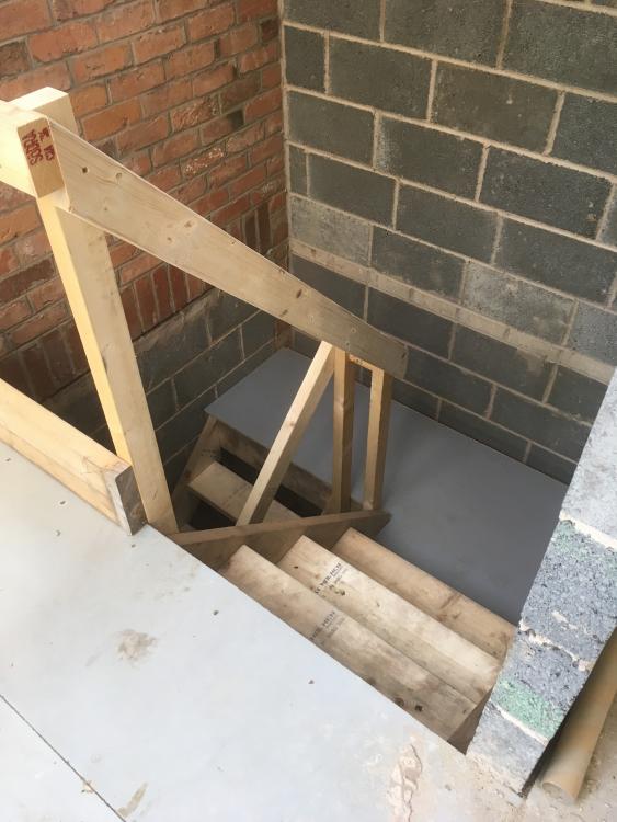

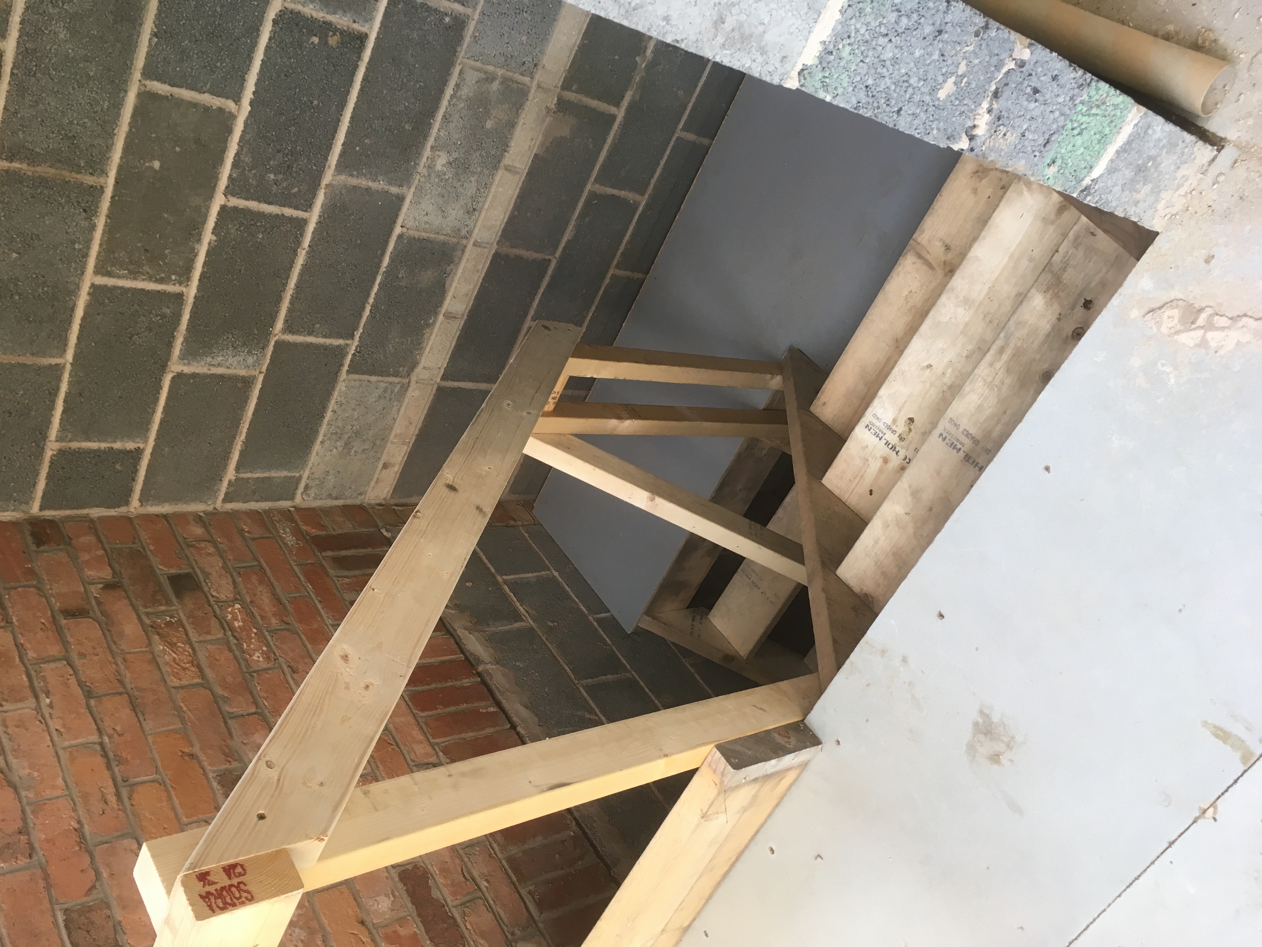

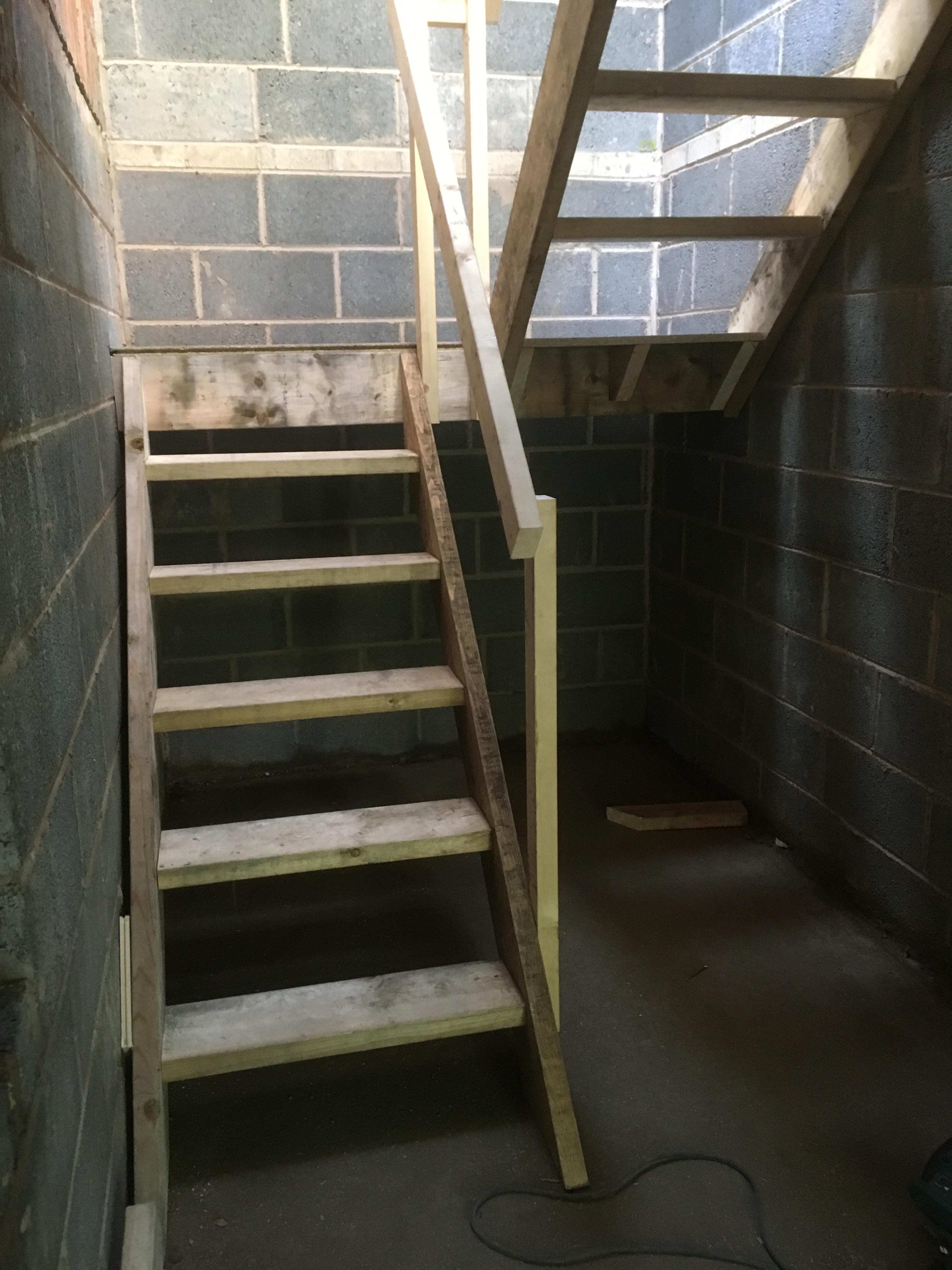

PeterW Posted August 4, 2017 Share Posted August 4, 2017 So like @TerryE we have made some temporary stairs. Downside is we need a double winder as the permanent ones and I'm not up to building one of those but given it's only an off cut of Egger and 4 pieces of spare 8x2 and some rails I'm pretty pleased with it ..! I've got a joiner on site who usually does 2nd fix but he's been worth his weight in gold as he happily cut this lot from a quick sketch - no it's not to building regs but it doesn't half make it easier to get things up and down stairs ..!! 3 Link to comment Share on other sites More sharing options...
