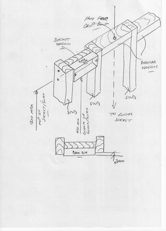

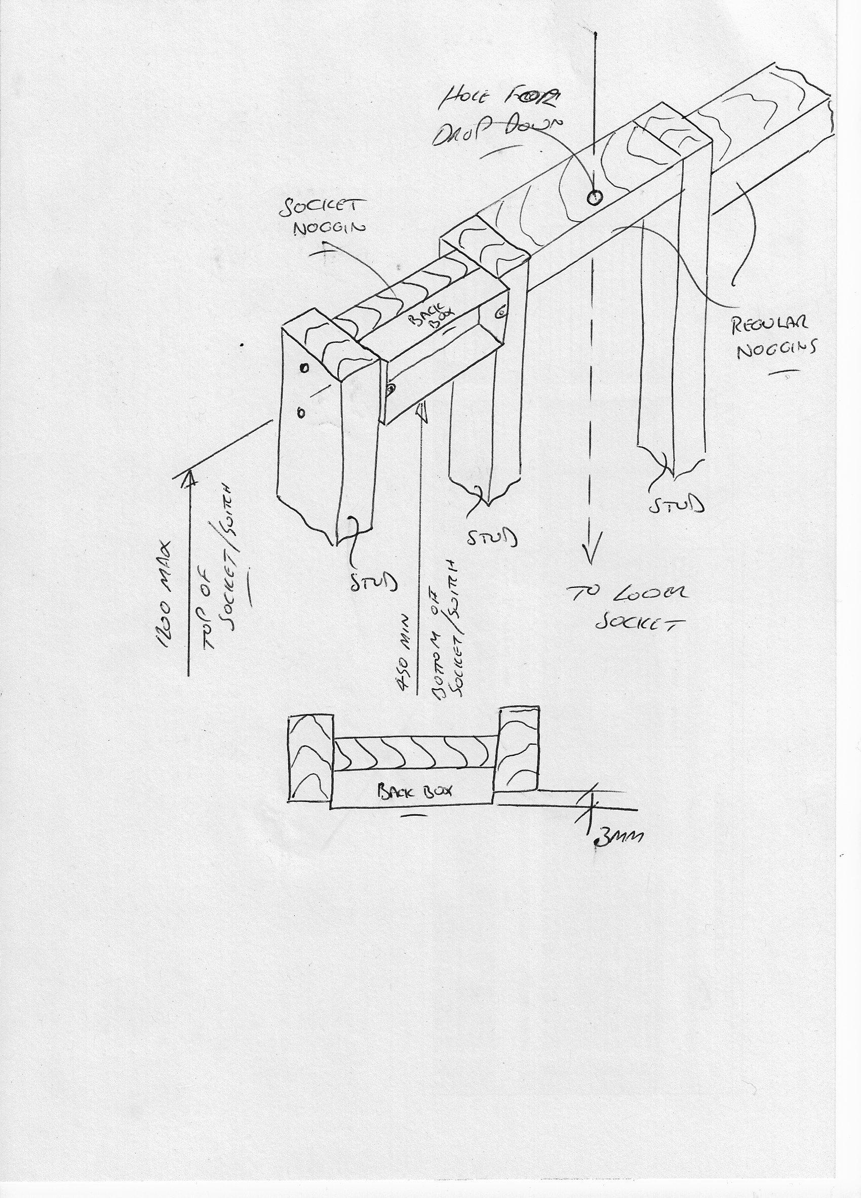

Onoff Posted April 5, 2019 Share Posted April 5, 2019 Don't know how you're doing your noggins...staggered? You can do on these lines: If fitting pb vertically you don't have to worry about the boards ending halfway over a noggin. Drill drop down holes in noggins if you think you might want lower (or higher) sockets in the future. If you think you won't how about say a high level socket for a wall mount tv later etc. Same going horizontal if you want. If filling stud with fluffy insulation you can still pretty easily thread cables through at a later date if you want an extra socket. Link to comment Share on other sites More sharing options...
ToughButterCup Posted April 5, 2019 Author Share Posted April 5, 2019 6 minutes ago, Onoff said: Perfik Rodders. Perfik. Link to comment Share on other sites More sharing options...
Onoff Posted April 5, 2019 Share Posted April 5, 2019 (edited) 18 minutes ago, recoveringacademic said: Perfik Rodders. Perfik. Seen before a fairly thin "socket noggin" with a socket either side, one in each room. Imo a crap idea as in noise and fire transmission route... Are these internal walls? You could go mad and run pvc conduit to save pushing aside insulation later...20mm round pokes nicely into a back box knockout with no need for a grommet. Edited April 5, 2019 by Onoff Link to comment Share on other sites More sharing options...
