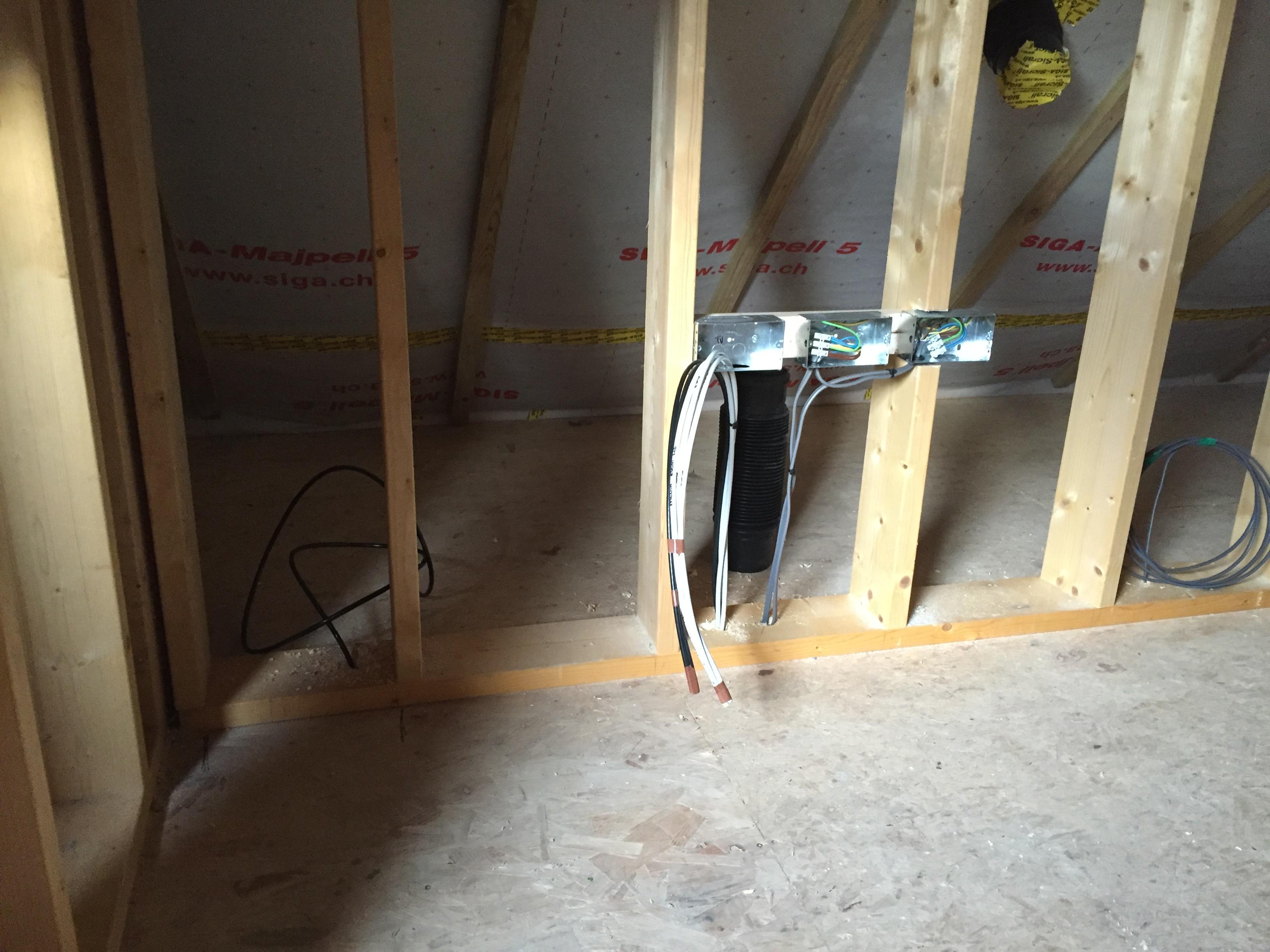

HerbJ Posted April 3, 2019 Share Posted April 3, 2019 Something like this? Our electrician installed specific noggins for every back box and support required for the electrical 1st fix - he has more tools than the carpenters! He didn't try to use the noggins in the stud walls that were part of the TF Link to comment Share on other sites More sharing options...
Oz07 Posted April 3, 2019 Share Posted April 3, 2019 Did all 3 switches need to be that close he's hacking your studs. God I hate when plumbers and sparks get saws out Link to comment Share on other sites More sharing options...
HerbJ Posted April 3, 2019 Share Posted April 3, 2019 1 hour ago, Oz07 said: Did all 3 switches need to be that close he's hacking your studs. God I hate when plumbers and sparks get saws out Yes - two double sockets and a TV coaxial/Cat 6 for TV etc. One of the the wall is a 1400mm high X 140mm stud wall, which requires zero zero structural integrity. The studs were not hacked. The carpentry is better than some carpenters work I have experienced. Link to comment Share on other sites More sharing options...
Mr Punter Posted April 3, 2019 Share Posted April 3, 2019 1 hour ago, Oz07 said: Did all 3 switches need to be that close he's hacking your studs. God I hate when plumbers and sparks get saws out He could more easily have fitted an extra noggin to the right, shifted everything over a bit and had the stud spacing out the backboxes by 38mm. Studs look plenty chunky enough to take it though. Link to comment Share on other sites More sharing options...
Oz07 Posted April 3, 2019 Share Posted April 3, 2019 1 hour ago, HerbJ said: Yes - two double sockets and a TV coaxial/Cat 6 for TV etc. One of the the wall is a 1400mm high X 140mm stud wall, which requires zero zero structural integrity. The studs were not hacked. The carpentry is better than some carpenters work I have experienced. Sound a bit touchy about it tbf! I'd of spaced them out more Link to comment Share on other sites More sharing options...
