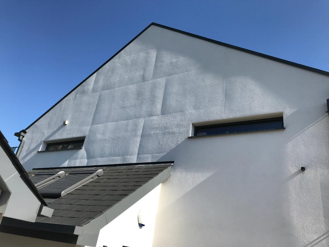

We have a render issue which may have been caused by lack of compression joints, not sure. It may also have been caused by insufficient fixing of the battens to the timber frame outer skin (panelvent board).
The boards under the Parex render are pillowing up as soon as it gets warm causing an unsightly effect.
The parex is highly elastic so no risk of cracking but does not look good.
Render firm committed to fix it but don't understand the root cause yet and understandably only want to do it once.
Going to push to have it resolved this year now that everything else is done.
Oh no, this is awful. I'm pleased they are committed to fixing this. Pat, the Weatherby rep, told me a story about a whole timber frame housing estate down south, which bowed in the heat because the cement/renderboards were butted up too close to each other and should have been spaced with room to expand. Perhaps this is the issue?
That has been discussed - they are butted up tight but it has been determined that that is per the board manufacturers recommendation.
Will see what actually happens...

It took a year or so for the issue to appear, firm are very professional and established - they've committed to fix it but we agreed that best for me to finish landscaping etc first and then they'll return so teeing that up for this summer.
Regarding board gaps, how do you stop them getting fouled by the initial coat of render, are they taped? This was the reason that our guys did not see the need for gaps (and neither did the board manufacturer).
I suspect it's a combination of factors, board expansion is putting strain on the batten fixings to the frame and these are flexing, allowing the boards to move.

They used Euroform Rendaboard 12mm which was approved by Parex.
Contractor thinks that hot air is building up behind the boards and that it's not suitably vented at the top but I think this is off target as the coping sits on a bracket with a generous drip overhang so unlikely to interrupt airflow.
Wow. No wonder the contractor is not arguing over correcting that.
A bit worrying that you don’t agree with his opinion of what went wrong. I hope it all gets sorted.
I would email pics to parex and see what they think?

@Bitpipe Is there continuous ventilation at the base of the cladding system with a decent path up behind? Is it just this gable end or other walls too?
Yep - batten is 25mm with insect mesh top and bottom. all walls have the effect to varying degrees.
At the top of the non gables, the render either finishes within 3mm of the soffit which allowed for alu cladding (the contractor suggested sealing that gap but I never did) or tucks under a grp edged flat roof. The gables have an alu coping but that sits on a bracket and there is a generous overhang and gap so airflow should not be impeded.

Parex reps have been out with the contractor, not sure if board vendor was there too. Plan is to re-convene this spring with MBC also and see if we can't figure it out.
@Bitpipe Is it possible to put a temperature sensor behind the Parex boards to see if there is a significant heat build up? I would be surprised if a ventilated cavity behind a white surface would get that hot.
I'm thinking its a combination of not enough fixings and no expansion gaps between the boards.

This is what the contractor has suggested should be do-able, just need to figure out how.
