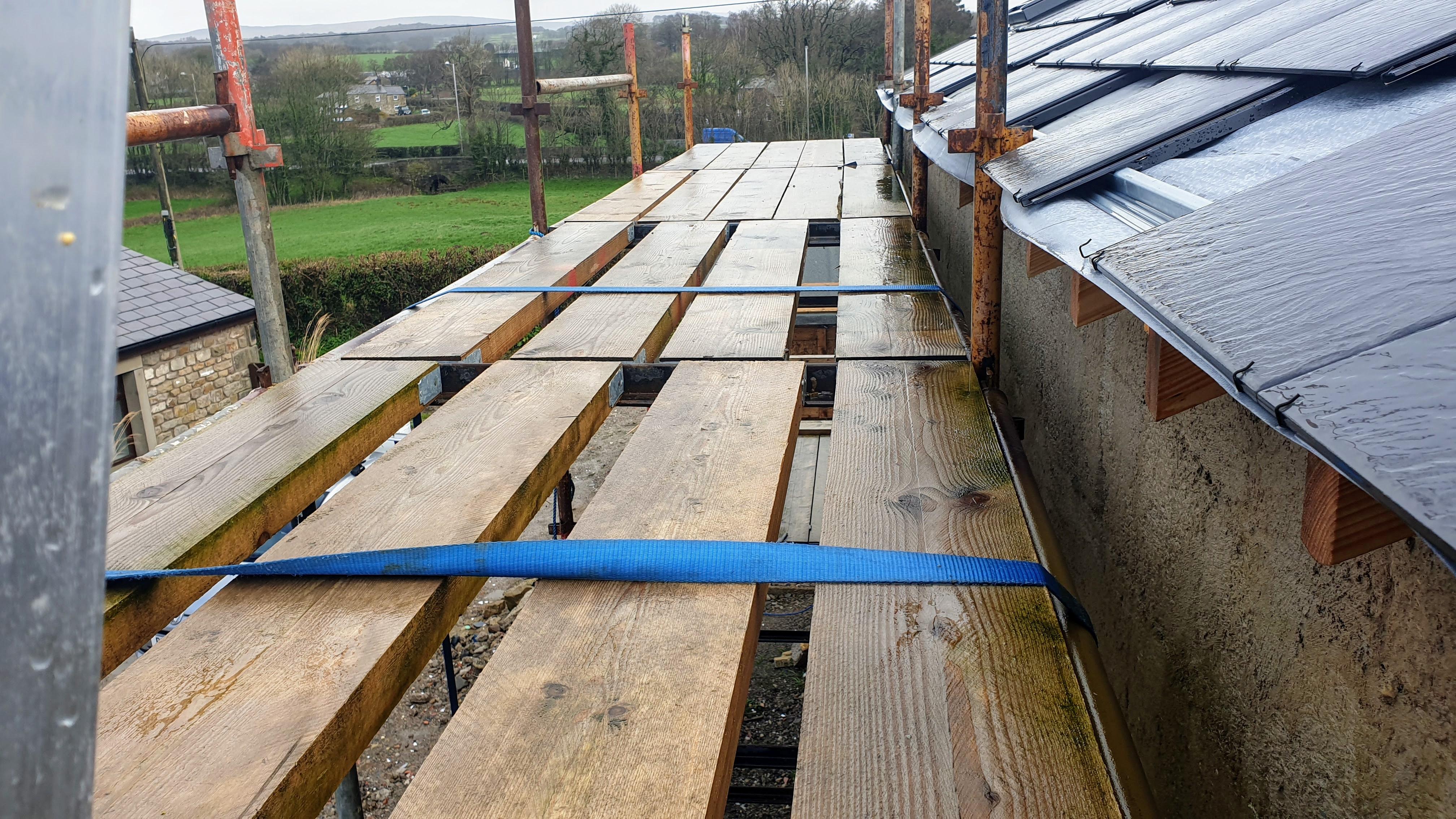

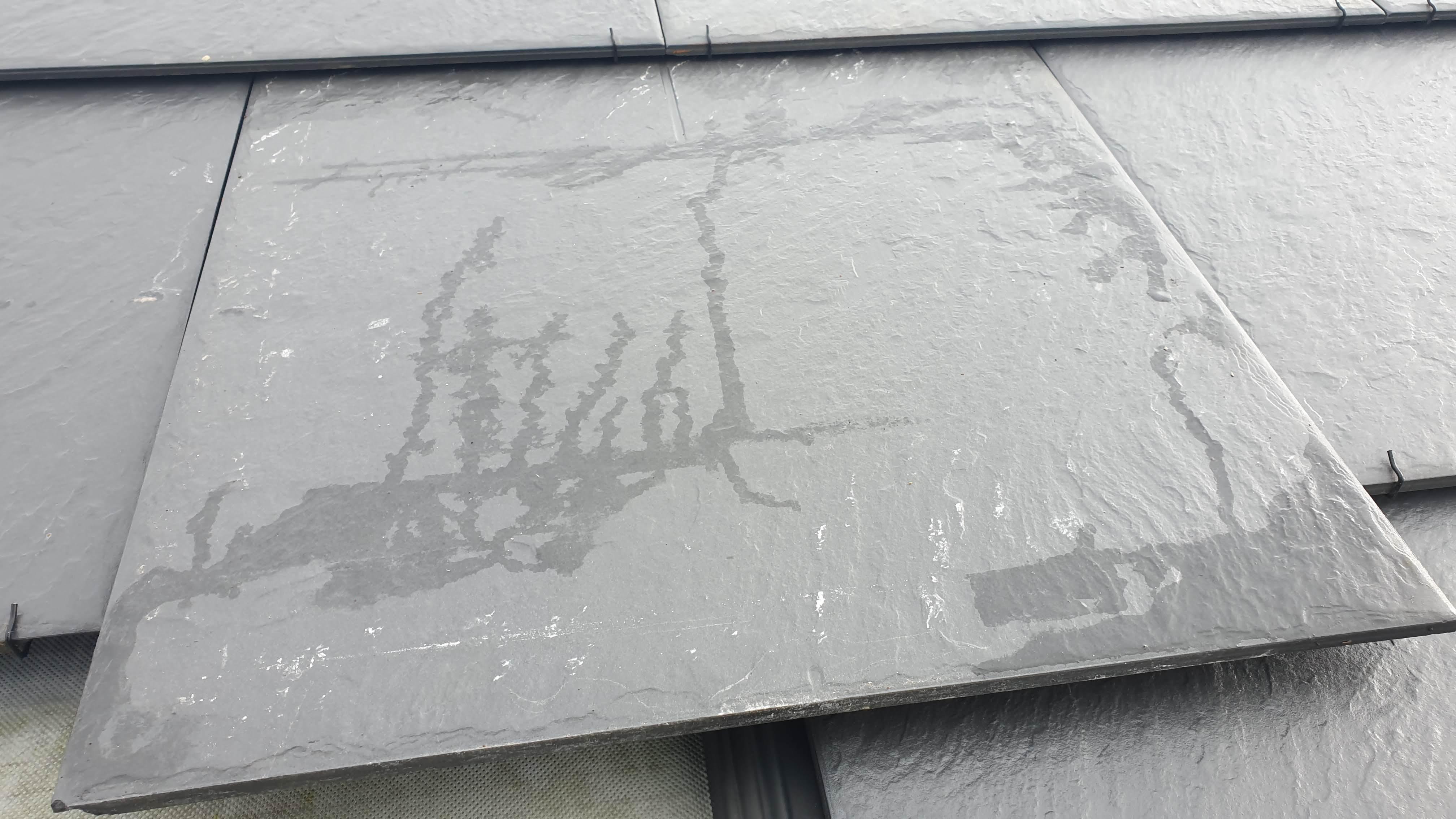

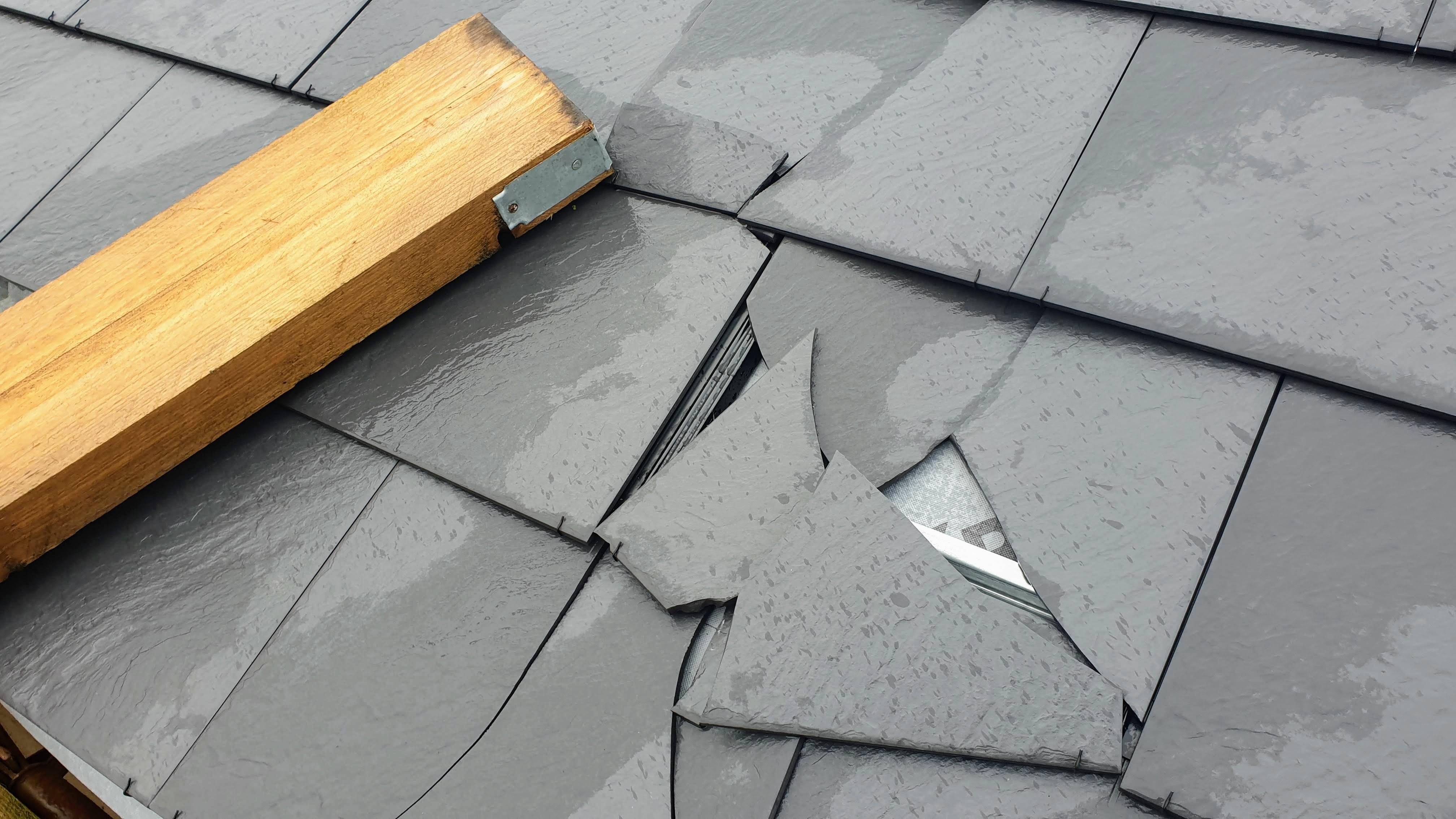

ToughButterCup Posted March 13, 2019 Posted March 13, 2019 Sufferin' scaffold boards Batman! Them boards is a flyin' ! Where to Robin? Off the scaffold and onto the roof Batman And there indeed they sat sneering at us. This one is quite artfully placed... This one was angrier and smashed a few more tiles than the first one And now for the good news. The tiles are Nulok tiles. Theres already quite a bit written about them - here if you want to follow it up The good thing about them is that they are very easy to replace : I mean even a doddery old codger like me can do it First, throw the broken tiles off the roof (yes I checked to see if Debbie was out of range) and and then replace the tiles. I haven't done that yet...... because For once I obeyed SWMBO, and came down off the scaffold because it was quite lively up there. But not before I had attached the scaffold boards to the scaffold with 3 tonne straps and not before I had thrown one scaffold board per bay down off the scaffold. I wanted to allow the pressure from tonight's gusts to dissipate rather than lift. So now, from the ground the scaffold looks like this; Replacing the tiles? Easy. Slide a new one under the clips. Job done. Had our roof been a normally slated roof, couldn'a done that now could I? Well - I'll do it when the wind dies down; have to do what SWMBO says (occasionally).
Carrerahill Posted March 13, 2019 Posted March 13, 2019 Glad this all went well. Could have been nasty. I was out fighting sheets of OSB yesterday. The Celotex stayed put miraculously!
joe90 Posted March 13, 2019 Posted March 13, 2019 Glad it didn’t do anymore damage and as you say, great that with Nulock it’s that easy to replace a couple (mine would not be that easy, regular slates but with clips so not as bad as nailed).

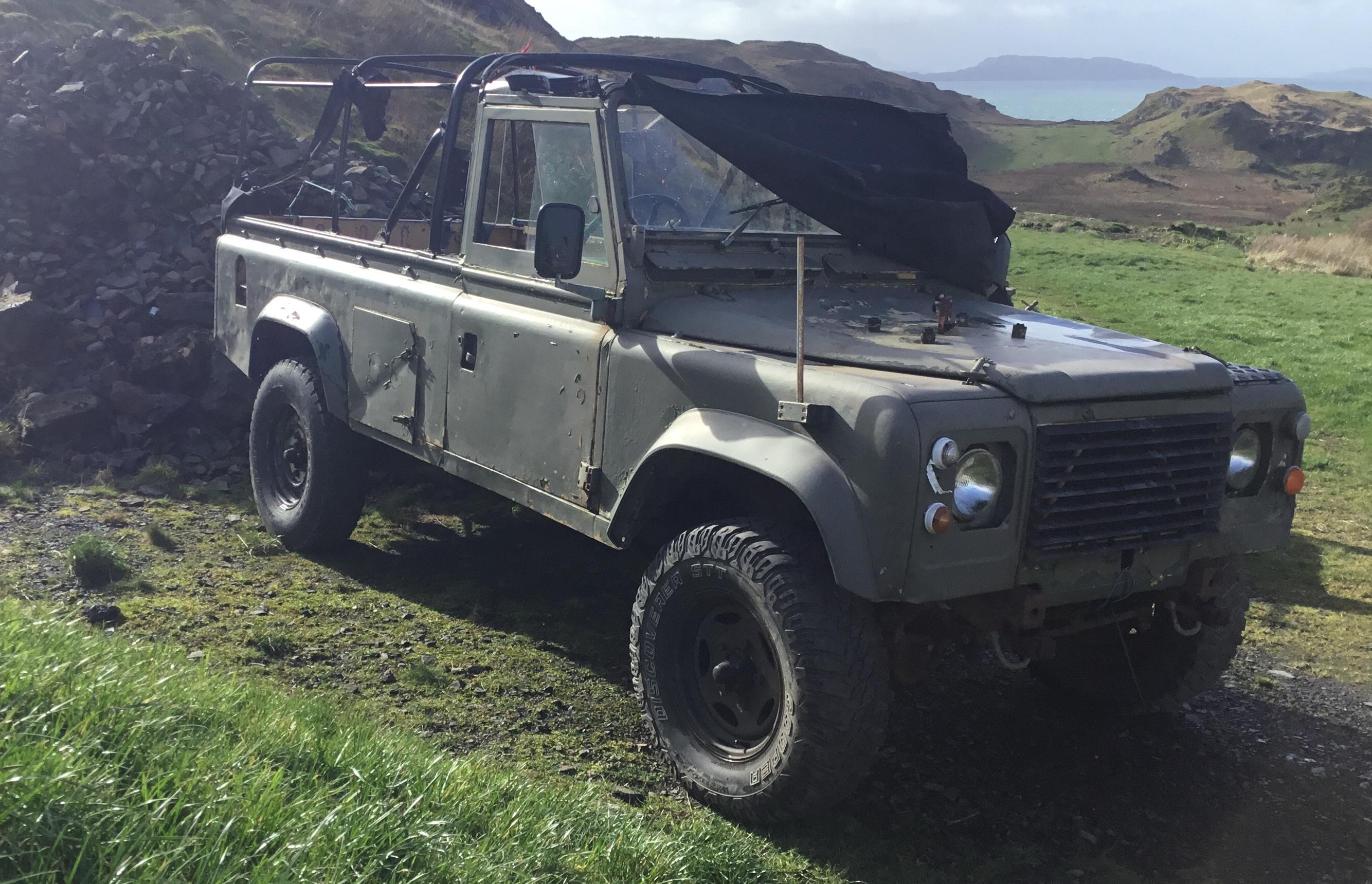

Cpd Posted March 13, 2019 Posted March 13, 2019 Living where I do I was yet again in the firing line last night.... most of the time everything is fine as we are used to big winds, however my poor old landrover suffered a devastating blow..... and now I need to think about replacing the cover or preferably putting on a tin top. Boohoo said piggy.
epsilonGreedy Posted March 13, 2019 Posted March 13, 2019 Quote and not before I had thrown one scaffold board per bay down off the scaffold. I wanted to allow the pressure from tonight's gusts to dissipate rather than lift. A British catamaran designer called James Wharram use to specific slatted decking based on similar thinking, he believed a catamaran with a slatted deck bridging the two hulls was less likely to flip. Decades later he conceded that a high-end aerodynamic expert had explained the fallacy of this belief. Anyhow those straps look serious.
ToughButterCup Posted March 13, 2019 Author Posted March 13, 2019 3 minutes ago, epsilonGreedy said: [...] Decades later he conceded that a high-end aerodynamic expert had explained the fallacy of this belief. I'd be extremely interested in reading that advice - or reading round that advice. The lifting force local to that corner of the house is directly proportional to the wind direction. In this case anything North of North West really 'gets it'. My little bit of aerodynamics understanding makes me wonder if I have - in creating the slots - merely created three or four turbulators that would be likely to puncture any drag bubble (downward pressure) there might be above the boards - thus increasing the lift acting on the boards. 'Nother sleepless night in store, it seems.
ToughButterCup Posted March 13, 2019 Author Posted March 13, 2019 15 minutes ago, Cpd said: [...]and now I need to think about replacing the cover or preferably putting on a tin top. Boohoo said piggy. Rag-tops, always the weakest link in any Landy. Never quite had the courage to fit one on mine.

Jeremy Harris Posted March 13, 2019 Posted March 13, 2019 39 minutes ago, recoveringacademic said: I'd be extremely interested in reading that advice - or reading round that advice. The lifting force local to that corner of the house is directly proportional to the wind direction. In this case anything North of North West really 'gets it'. My little bit of aerodynamics understanding makes me wonder if I have - in creating the slots - merely created three or four turbulators that would be likely to puncture any drag bubble (downward pressure) there might be above the boards - thus increasing the lift acting on the boards. 'Nother sleepless night in store, it seems. Slot effect. Airflow accelerates through a slot, and can increases the lift on the surface behind as it does so (just because lift is proportional to the square of air speed). Commonly seen on Bermuda rigged sailing vessels, when the slot between the foresail and the mainsail increases the lift from the mainsail, by increasing the airspeed over the low pressure (leeward) side (Bernoulli and all that). Also seen on leading edge slats and slotted flaps on aircraft wings, both techniques to increase lift at reduced airspeed, so allowing safe and controllable flight at lower speeds, by lowering the effective stall speed.
ToughButterCup Posted March 13, 2019 Author Posted March 13, 2019 10 minutes ago, JSHarris said: Slot effect. [...] Yes. But.... In this case there's no lifting surface behind the slot: so, to pursue the aviation analogy, I am hoping I have created several lift dumps. And just in case I haven't, i've harnessed the boards to half a tonne or so of metal, and that in turn is secured to a section of up-wind scaffolding. OK, in view of tonight's little set of gust fronts, you're going to tell me I should have taken the boards off the scaffold aren't you? Bugger.
jamiehamy Posted March 13, 2019 Posted March 13, 2019 42 minutes ago, JSHarris said: Slot effect. Airflow accelerates through a slot, and can increases the lift on the surface behind as it does so (just because lift is proportional to the square of air speed). Commonly seen on Bermuda rigged sailing vessels, when the slot between the foresail and the mainsail increases the lift from the mainsail, by increasing the airspeed over the low pressure (leeward) side (Bernoulli and all that). Also seen on leading edge slats and slotted flaps on aircraft wings, both techniques to increase lift at reduced airspeed, so allowing safe and controllable flight at lower speeds, by lowering the effective stall speed. Ah! So that might answer a question I've had for a while. I remember reading somewhere that a certain type of sailing vessel was said to almost 'create her own wind'. That will be this?
Jeremy Harris Posted March 13, 2019 Posted March 13, 2019 9 minutes ago, recoveringacademic said: Yes. But.... In this case there's no lifting surface behind the slot: so, to pursue the aviation analogy, I am hoping I have created several lift dumps. And just in case I haven't, i've harnessed the boards to half a tonne or so of metal, and that in turn is secured to a section of up-wind scaffolding. OK, in view of tonight's little set of gust fronts, you're going to tell me I should have taken the boards off the scaffold aren't you? Bugger. There is, the plank behind. It was possibly lift that caused the planks to lift up and hit the roof in the first place. A plank can produce lift, not as efficiently as an aerofoil, but still significant, and possibly greater than the drag force from just the wind acting on the projected area of the plank, perpendicular to the air flow direction. Try standing outside, holding a plank edge-on into a stiff breeze and you will feel the lift the moment there is any angle of incidence on the plank. When sitting on a scaffold, with a probable stagnation area where the underside of the planked section abuts the wall, there's a fair chance that air will try to flow from the higher pressure side (underneath the planks) to the lower pressure side (above the planks) through any slots, so possibly increasing the lift forces on them. TBH. I think this is possibly more of a theoretical debate than a practical one, as whether the added lift from the slots is significant enough to increase the risk of them lifting is pretty hard to assess. As a final point about slots, if you're ever down near Abbeville take a look at the blades on the old windmill there. It uses a leading edge slots to increase the lift on the blades, right at the stock. The people that came up with this design probably hadn't got a clue why it worked, they just knew it did.

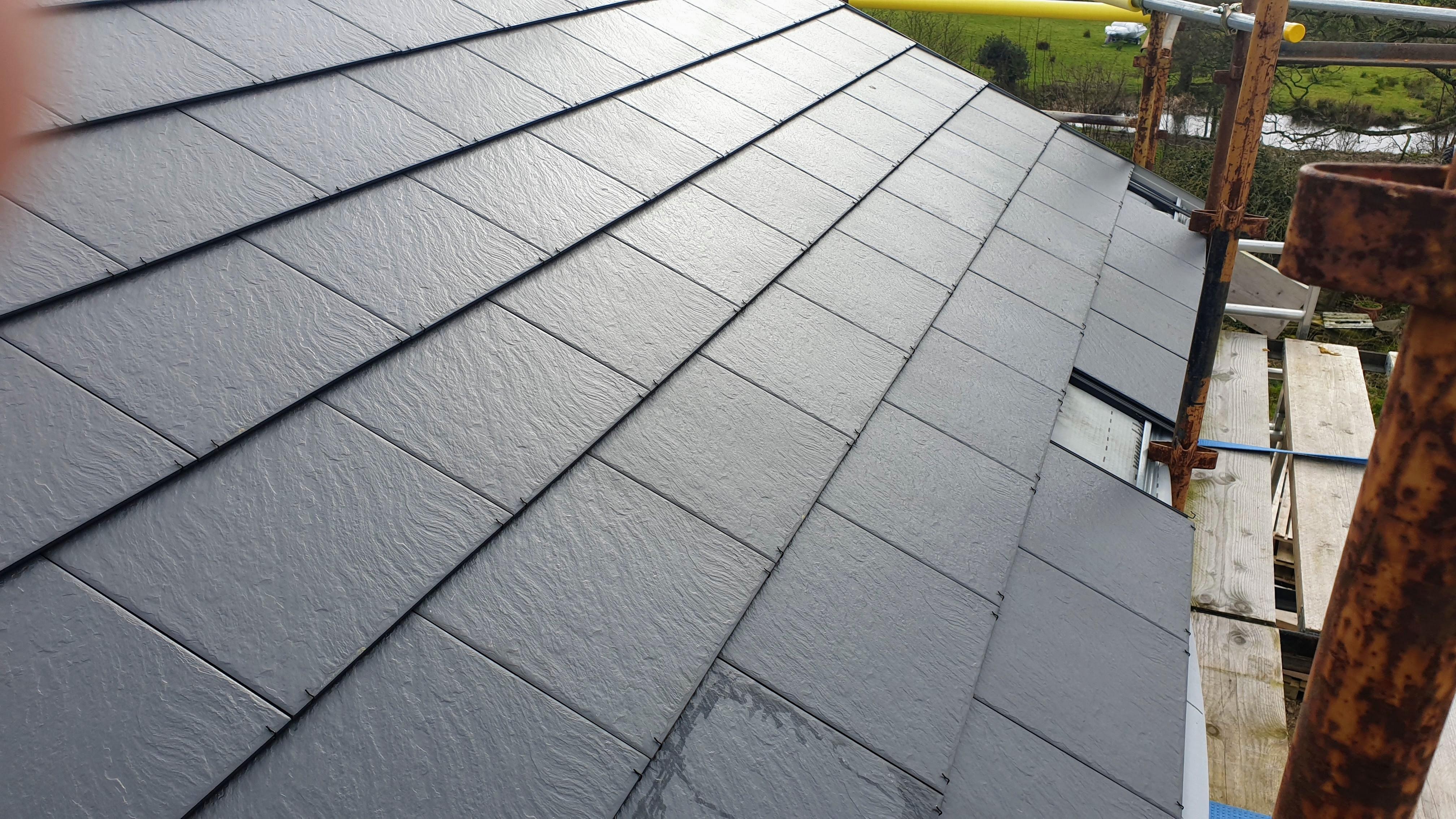

ToughButterCup Posted March 13, 2019 Author Posted March 13, 2019 24 minutes ago, Thedreamer said: [...] what do you guys do with your temporary downpipes [...] ? Are you posh or wot? The wind is due to drop later today, I'll pop up and fit the replacement tiles and take some photos for those who are interested in Nulok

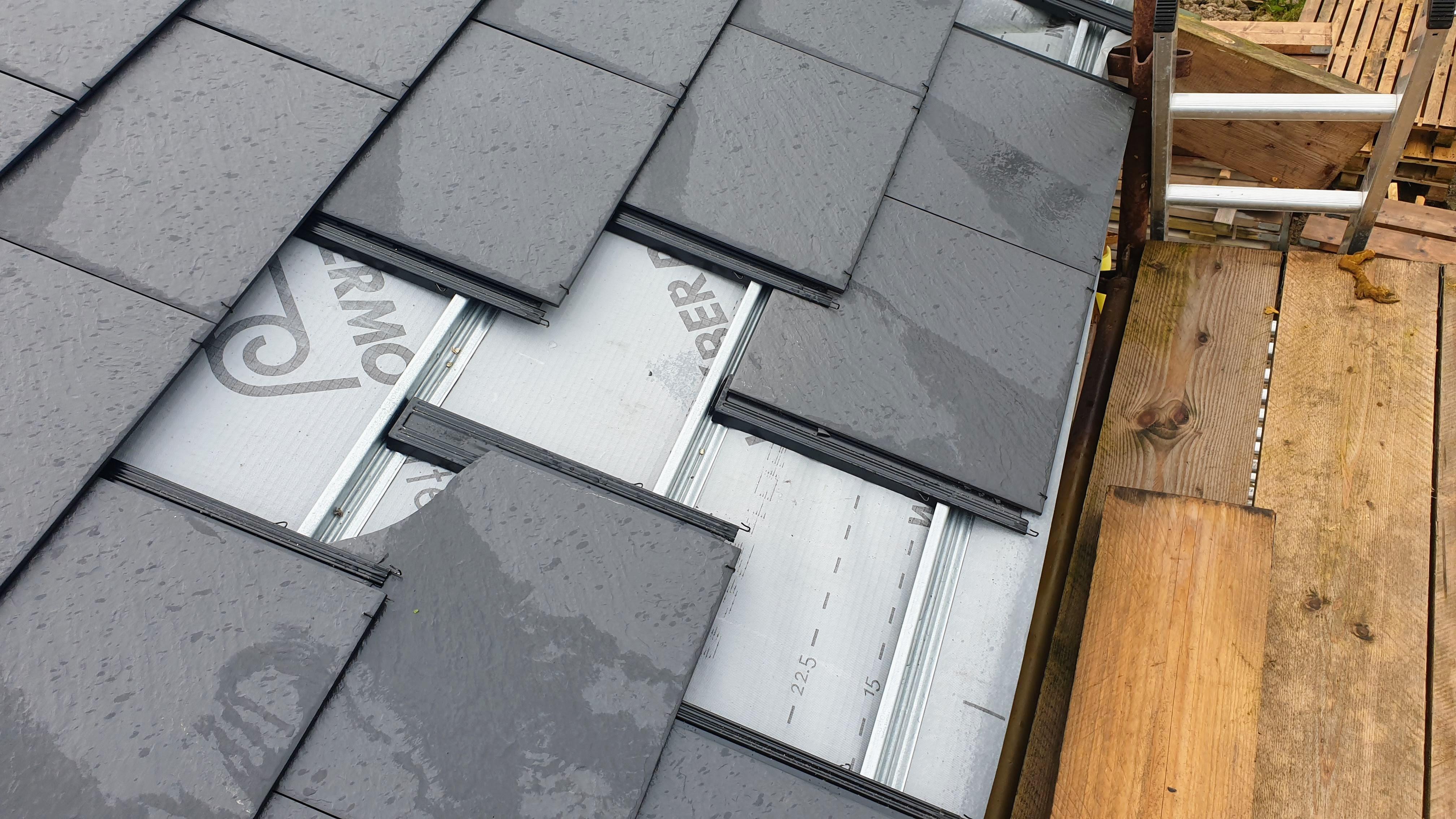

ToughButterCup Posted March 13, 2019 Author Posted March 13, 2019 And this is how quickly the tiles can be replaced.... Clear the broken tiles, shove under the tile above and .... 10 minutes later all six tiles have been pushed into place There's a gap in the tiling to allow for the fact that some idiot or other put the Kwikstage too close to the house.? Rookie scaffold error that....
Declan52 Posted March 13, 2019 Posted March 13, 2019 15 minutes ago, recoveringacademic said: And this is how quickly the tiles can be replaced.... Clear the broken tiles, shove under the tile above and .... 10 minutes later all six tiles have been pushed into place There's a gap in the tiling to allow for the fact that some idiot or other put the Kwikstage too close to the house.? Rookie scaffold error that.... Loosen the tie bar and use a plank/ledger as a lever and wedge it against the wall and push the standard out enough to get your tiles in. If you have the jack leg on a bit of timber, like your meant to, then it will slide out very easy. A few goes will do it and then redo the clamp.
ToughButterCup Posted March 13, 2019 Author Posted March 13, 2019 3 minutes ago, Declan52 said: [...] If you have the jack leg on a bit of timber, like your meant to, then it will slide out very easy. A few goes will do it and then redo the clamp. Jack leg?
