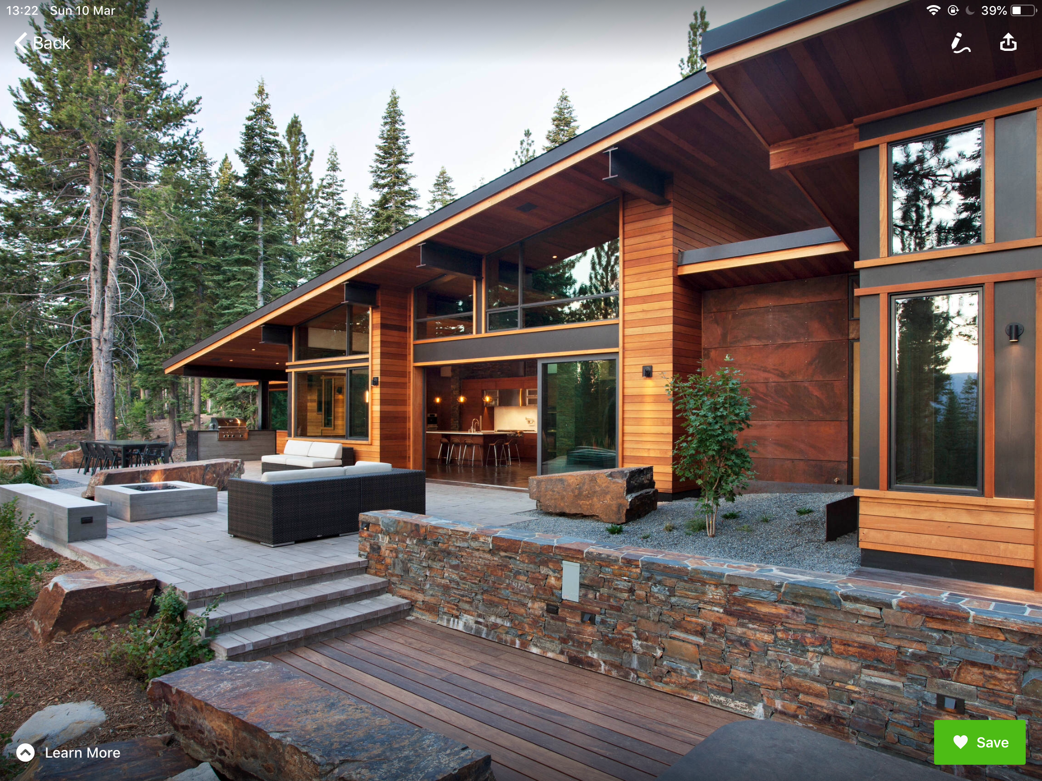

Russell griffiths Posted March 11, 2019 Author Posted March 11, 2019 Thanks both of you, we have a distinct look we are after, the picture shows a house we have based all our thoughts on.

Russell griffiths Posted March 11, 2019 Author Posted March 11, 2019 Timber will be treated with something, don’t know what yet as I want to try and replicate that picture.
Miek Posted March 11, 2019 Posted March 11, 2019 That picture shows some really well thought out details. Looks expensive. No knots in sight, hidden fixings, mitred corners, etc... 1 hour ago, JSHarris said: I've needed to go up and remove a fair few ring nails (anyone know an easy way to remove these bastards?) There isn't one. Ring shanks hold like screws, amazing fixings.
lizzie Posted March 11, 2019 Posted March 11, 2019 (edited) @Russell griffiths that looks like cedar. Have you looked at Russwood. I think they have some of the best cedar around. You need a high grade for that look. Need to watch the colour mix too as cedar can vary a lot in the same batch. If it were me I would e-mail that picture to the nice people at Russwood (after a prelim phone call ) and ask them to suggest a cladding to replicate that and send you samples. Nice look btw. Edited March 11, 2019 by lizzie 1
Gone West Posted March 12, 2019 Posted March 12, 2019 13 hours ago, Russell griffiths said: Thanks both of you, we have a distinct look we are after, the picture shows a house we have based all our thoughts on. That looks like Western Red Cedar and the top grade is called "No. 2 clear and better" which is what we used. Ours came without any knots and we have left it to 'silver'. To keep the look that you want will require quite a lot of maintenance. 1

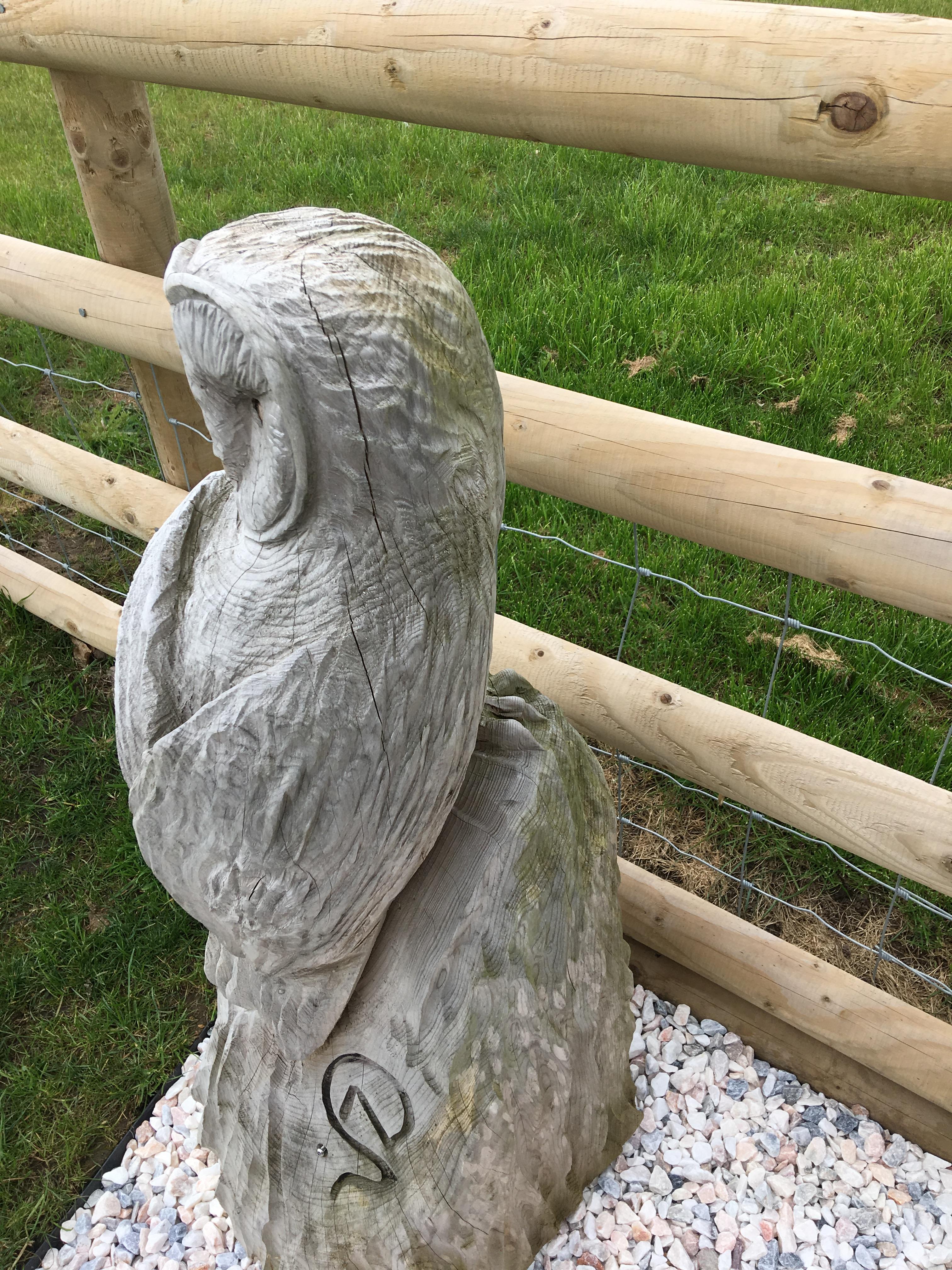

lizzie Posted April 7, 2019 Posted April 7, 2019 This is cedar, its carved from a log of a tree my newphew cut down somewhere in Hampshire. It has had no treatment whatsover and is just out in the garden in a fairly exposed location. Its weathering nicely 5 years on. I went for larch cladding in the end as I saw some I fell in love with. I had spent time looking at cedar cladding weathering at different points - 1 year, 2 years etc and found the uneven weathering look not what I wanted. I also looked into having it treated with siouu (?spelling) to help miniminse that. Also the mix of colours the new cedar comes in was again not what I wanted. Had been set on cedar (blame pinterest) until I saw my larch and that was it a coup de foudre for me. I think it depends on the look you want to achieve. If you go for a natural untreated cedar be prepared for it to take a few years to achieve an even silver colour.
