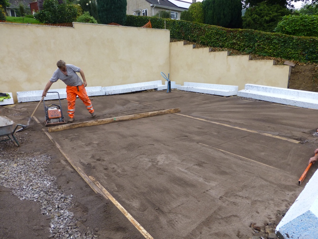

Jeremy Harris Posted March 11, 2019 Posted March 11, 2019 2 minutes ago, eandg said: Thanks both. We are/were waiting to get a design sorted before contacting a structural engineer but will get onto it asap. The ducting/cabling is one I'll need to get my head round - are there any straightforward guides about? I watched a few videos of passive slabs last night and they looked to be completely without anything bar EPS and concrete! Our passive slab was laid on a bed of whacked down coarse stone: You can just see the pipes and ducts coming up through this, they were all placed accurately in trenches underneath the sub-base. Next the sub-base stone was blinded and levelled with grit, to form a dead level bed for the shaped EPS blocks and sheet: You can see some pipe/cable ducts poking up at the back of this photo. Once the foam blocks and sheet were all laid, a DPM was laid and sandwiched between the top foam sheet and the two underneath, the reinforcing steel was added and tied in and the UFH pipes were laid and tied to the steels: The day after the photo above was taken the concrete was poured and trammelled roughly level, as shown in this photo: A couple of hours after the photo above was taken the slab was power floated smooth, leaving a finished floor that was flat and smooth enough to tile and floor to directly, with no need for screed or levelling compound.
Ross Posted July 29, 2020 Posted July 29, 2020 On 11/03/2019 at 16:56, Jeremy Harris said: Our passive slab was laid on a bed of whacked down coarse stone: ..... On 11/03/2019 at 06:59, Nick1c said: You need to talk to an engineer. We are having a passive slab & he wanted non made up ground, I am sure there are ways round it (presumably at a cost!), but you need to go with what they say. It would be worth contacting Hilliard Tanner in Ireland if your engineer isn't that familiar with this method of construction. Thanks @Jeremy Harris for sharing details of your passive slab. One further detail I would like to know is how the trenches were done and made up. Unfortunately the building regs don't have clear guidance on how to lay drains under a passive slab, and I've got an engineer suggesting that the drain should be encased in concrete! (which I'm hoping isn't necessary). It was my impression that the drains and services should only need to be in a bed of gravel, in a trench dug after having compacted the sub-base (but perhaps what they do in other countries isn't appropriate here). Unfortunately @Nick1c I don't think my engineer is very familiar with the system (Jackon Atlas in my case), but I don't really want to be contacting an engineer in Ireland.
Dan F Posted July 29, 2020 Posted July 29, 2020 (edited) 32 minutes ago, Ross said: Thanks @Jeremy Harris for sharing details of your passive slab. One further detail I would like to know is how the trenches were done and made up. Unfortunately the building regs don't have clear guidance on how to lay drains under a passive slab, and I've got an engineer suggesting that the drain should be encased in concrete! (which I'm hoping isn't necessary). It was my impression that the drains and services should only need to be in a bed of gravel, in a trench dug after having compacted the sub-base (but perhaps what they do in other countries isn't appropriate here). This is what out building inspector asked for: All drains are 110mm UPVC and have straight runs with minimal connection points below the slab. All drains are to be bedded and backfilled with 10mm pea shingle and the slab is reinforced. Drains serving as SVP’s to first floor are to have 200mm long rest bends at base with concrete support. Could it be there is a mix-up regarding the concrete supports? What passive slab system are you using? Quote It was my impression that the drains and services should only need to be in a bed of gravel, in a trench dug after having compacted the sub-base (but perhaps what they do in other countries isn't appropriate here). This is exactly what we did. See this post, you can just about see the concrete support in the drainage picture.: Edited July 29, 2020 by Dan F 1

Dan F Posted July 30, 2020 Posted July 30, 2020 1 minute ago, Ross said: Thanks for the helpful replies. Good to know what other people are doing. Another ignorant question: Can a water supply pipe go in the same trench under the slab as the soil drain pipe? Not sure who is doing your slab or what they do, but a typical approach is to use a 110mm UPVC pipe with a shallow bend for water supply and then to put MDPE through this afterwards. A 200mm shallow bend will just about work with 32mm MDPE assuming you feed it through from inside. (we were worried about this). 1
