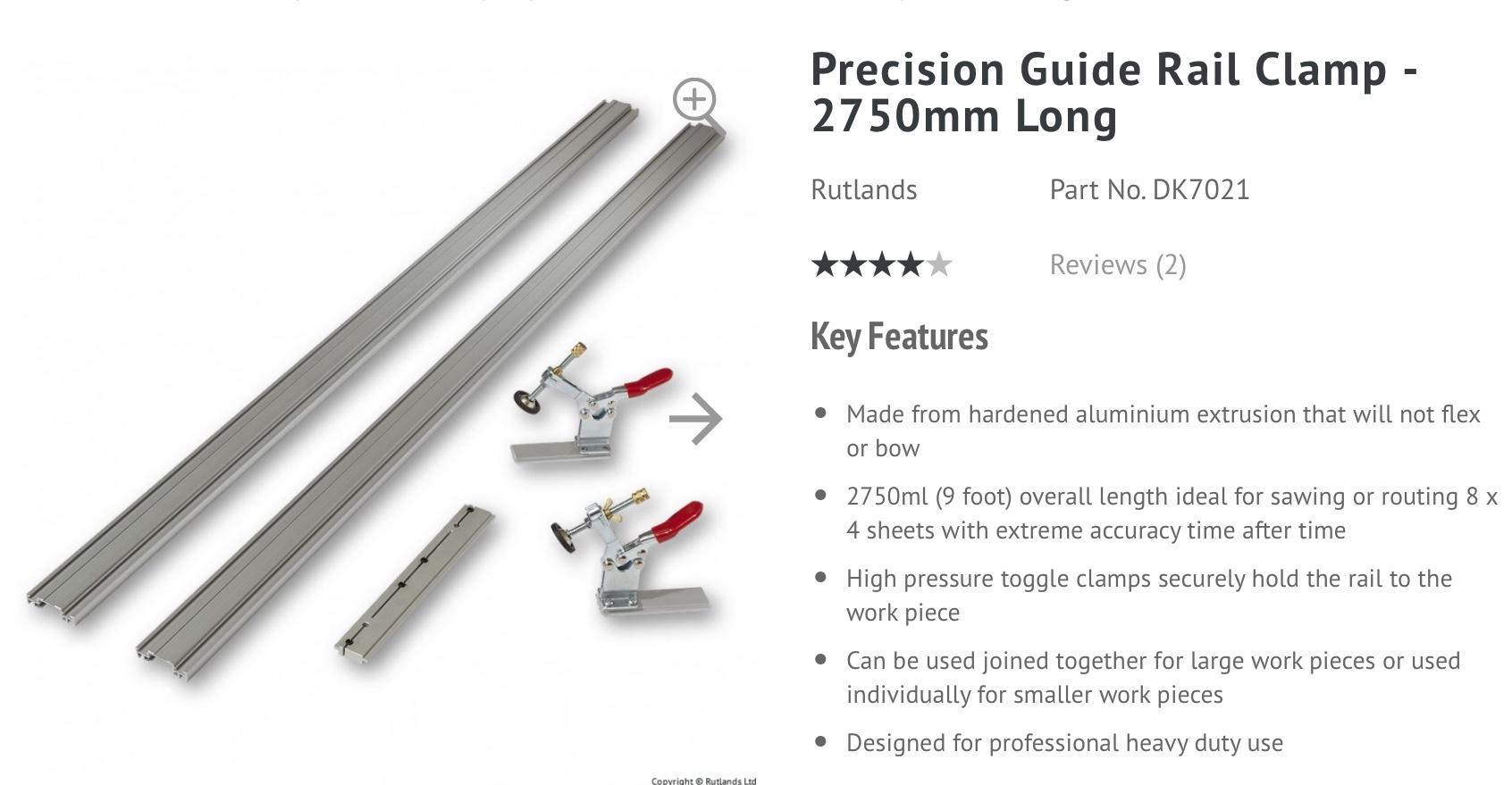

PeterW Posted February 23, 2019 Share Posted February 23, 2019 I can’t justify one - I borrow a Festool one from a joiner for the price of a 4 Pack when I need it. I do have some neat clamps that can span a full board and act as a rail and they have multiple uses. For repetitive stuff and where you want accuracy, as your local timber merchants to cut to size or get a B&Q Trade Card and get the sheet stuff via them - works out just as cheap as trying to do it myself. Link to comment Share on other sites More sharing options...
scottishjohn Posted February 23, 2019 Share Posted February 23, 2019 (edited) yes i bought a straight edge thats a clamp as well --fine for 4ft cut --but not long enough for other way www.onbuy.com/gb/clamps-and-vices/silverline-guide-clamp-1270mm-675056-guide-clamp-silverline-675056-1270mm~c5692~p3373033/ but neither are normal track saw unless you buy more extensions hardly the end of the world to clamp a bit of studding to a sheet anyway Edited February 23, 2019 by scottishjohn Link to comment Share on other sites More sharing options...
PeterW Posted February 23, 2019 Share Posted February 23, 2019 This is the one I have Link to comment Share on other sites More sharing options...
Jeremy Harris Posted February 23, 2019 Share Posted February 23, 2019 I just use a long length of 50mm x 8mm aluminium bar as a straight edge. Had it for years and use it for everything where I need some sort of cutting guide, from guiding a knife when scoring PB to use as a general marking out or saw guide. Clamped to a bit of board it's easy to just run a circular saw along it, with the base plate pushed up to the edge. Only thing to watch is the height of the clamps. I made up some low profile ones from some 1" aluminium bar, as the clamps need to be able to duck under the saw motor. Link to comment Share on other sites More sharing options...

Cpd Posted February 23, 2019 Share Posted February 23, 2019 Like others I use a aluminium rail, I use it with my jigsaw and circular saws and it doubles up as my “long” straight edge for levelling and marking. I got this bad boy for £30 ex demo but new they are over £60...... when breaking down sheets the clamps are great as it’s quick and easy. It will outlast me if I don’t do anything stupid with it........ 2 Link to comment Share on other sites More sharing options...
