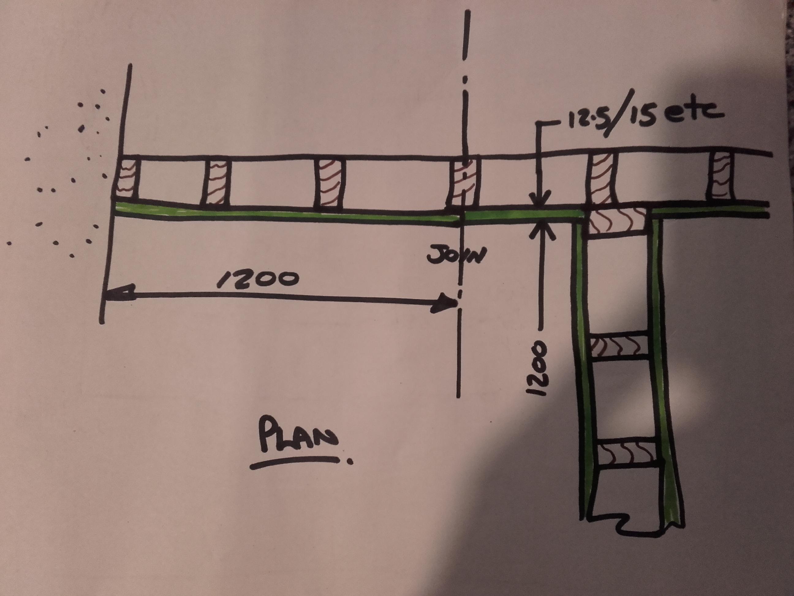

ToughButterCup Posted February 23, 2019 Author Share Posted February 23, 2019 20 hours ago, Onoff said: [...] Be careful with the next walls coming off at 90deg you'll want to consider the plasterboard thickness at the start. [...] Thanks for the warning. Not thought about a corner yet, but I will be next week. Whats the issue, and how is it solved? I feel another sketch coming on. Link to comment Share on other sites More sharing options...
Onoff Posted February 23, 2019 Share Posted February 23, 2019 49 minutes ago, recoveringacademic said: Thanks for the warning. Not thought about a corner yet, but I will be next week. Whats the issue, and how is it solved? I feel another sketch coming on. Some people will build all their studs and do a stud wall coming off of it perpendicular. They then pb the first wall but haven't accounted for the thickness of the pb. Also need to plan how you support the ends of the respective wall's pb at these junctions. Say below you'd built the stuff first, unsupported ends etc, more cutting. Link to comment Share on other sites More sharing options...

ToughButterCup Posted February 23, 2019 Author Share Posted February 23, 2019 Hmm, @Onoff, what happens here then? Wont the right hand edge of the left-to-right PB 'float' at the yellow circle? Link to comment Share on other sites More sharing options...

Declan52 Posted February 23, 2019 Share Posted February 23, 2019 11 minutes ago, recoveringacademic said: Hmm, @Onoff, what happens here then? Wont the right hand edge of the left-to-right PB 'float' at the yellow circle? Put another stud in. Or when you made it in the first place you put the one it just misses to the left a bit as long as it still works fine on the other side. Link to comment Share on other sites More sharing options...
Ed Davies Posted February 23, 2019 Share Posted February 23, 2019 42 minutes ago, recoveringacademic said: Wont the right hand edge of the left-to-right PB 'float' at the yellow circle? Isn't that Onoff's point, another reason to think ahead and not just follow the centre spacing slavishly? 1 hour ago, Onoff said: Also need to plan how you support the ends of the respective wall's pb at these junctions. Link to comment Share on other sites More sharing options...
Onoff Posted February 23, 2019 Share Posted February 23, 2019 42 minutes ago, recoveringacademic said: Hmm, @Onoff, what happens here then? Wont the right hand edge of the left-to-right PB 'float' at the yellow circle? Yes, that's what I was getting at with the drawing. The right to left also the same problem. 35 minutes ago, JSHarris said: I've always cut PB with a Stanley knife and straight edge, and noticed that the guys boarding our house out did the same. Just score the board, snap it, then run the knife down the paper on the remaining side. Quick, easy, very little mess and relatively clean edges. Same here. I do score against a metal straight edge though. Link to comment Share on other sites More sharing options...
Onoff Posted February 23, 2019 Share Posted February 23, 2019 1 minute ago, Ed Davies said: Isn't that Onoff's point, another reason to think ahead and not just follow the centre spacing slavishly? Exactly! When I've cocked up like this before I've added a bit of 2'x2' to support the floating and. Link to comment Share on other sites More sharing options...
PeterW Posted February 23, 2019 Share Posted February 23, 2019 I’ve either doubled up or come back 40mm, turned the next stud on edge and screwed it to the first, and then put another stud so you end up with a square “U” shape. The perpendicular then builds off this. Link to comment Share on other sites More sharing options...
Russell griffiths Posted February 23, 2019 Share Posted February 23, 2019 Tbh @Onoff corner is wrong, you need to construct a 3 stud corner i will try to explain the first straight wall will have another wall that intersects it, like a T, you need to know this point at this junction of the two walls you put 2 studs with a gap in between equal to the width of the wall that will be intersecting so your studs come along all nicely at 600 centres then you have 2 studs with a 90mm gap between them, turn a couple of off cuts of stud sideways between the 2 studs that are set 90mm apart this makes your 3 stud corner. Pic to follow. Link to comment Share on other sites More sharing options...
Onoff Posted February 23, 2019 Share Posted February 23, 2019 4 minutes ago, Russell griffiths said: Tbh @Onoff corner is wrong, you need to construct a 3 stud corner That's why @Onoff drew it! Link to comment Share on other sites More sharing options...
