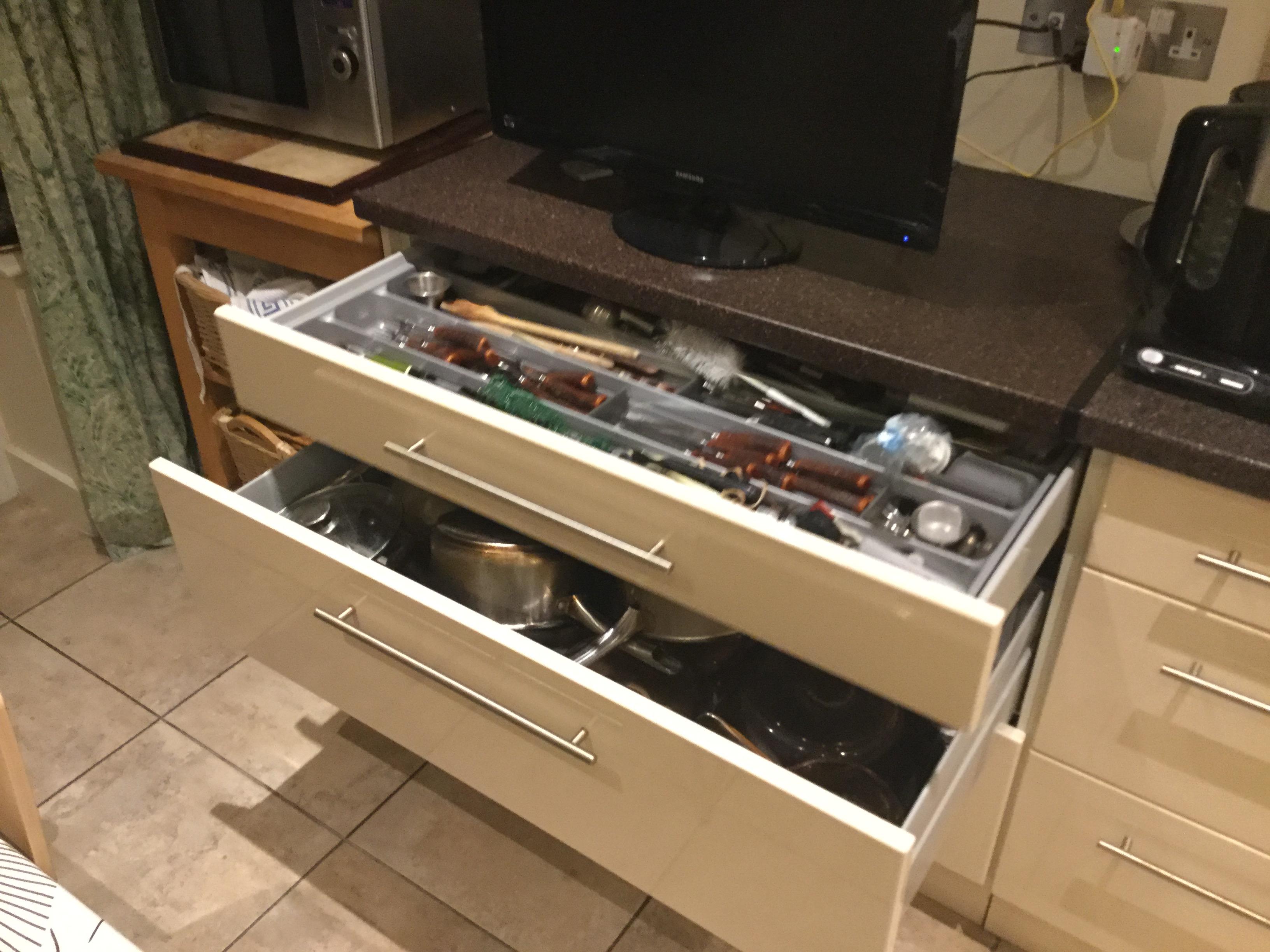

Ferdinand Posted February 18, 2019 Posted February 18, 2019 (edited) @Tony K There is value in using standard grids, but being a slave to them can make some things difficult. For example, sinks and range cookers, and chest freezers do not conform to that. And I love my 1m wide cutlery and pan drawer .. see below. And you need sufficient flexibility in for when something else does not quite come out as expected.eg if a door suddenly needs to be 150mm wider, or a wall needs an extra thickness of PB you forgot about. If you do everything to +-1mm with no adjustable-But-looks-planned elements, then there is a chance that you will be hoist by your own petard. So plan for a sufficient adaptability. You can use things like bin gaps, places stools go, tray slides, wine coolers, and a row of units that finished on an open wall not a corner where the end can be +- 6 inches. Personally I have found Howdens good, but it is branch based, and they keep offering me 1000 or 2000 screws free if I have a kitchen quote from them. Grid, Yes, Slave to a grid .. a rigidity too far. Ferdinand Edited February 18, 2019 by Ferdinand
