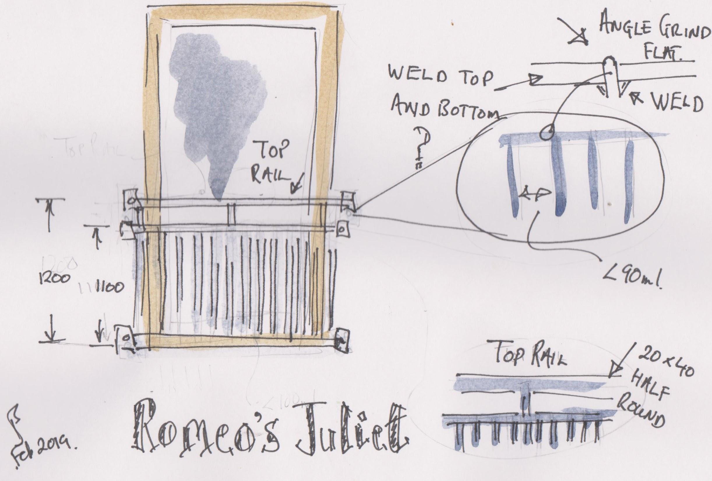

ToughButterCup Posted February 17, 2019 Posted February 17, 2019 I'm building our three Juliet balconies. And as you prolly know, I'm not a welding God . In fact one or two members who will remain nameless, ( @Russell griffiths, chief among them) really bruised my confidence badly.? So I have a question. Look at this - look at the way the verticals intersect with the horizontals...... For each of the verticals, as they go through the horizontals, should I weld both the top and bottom bit of the vertical bar ?
Onoff Posted February 17, 2019 Posted February 17, 2019 What sections are the verticals and horizontal?
Declan52 Posted February 17, 2019 Posted February 17, 2019 If you cut the top of the bar at 45 degrees it will look nicer than you cutting them flat. If you can weld it nice (very broad term) you can weld at both sides where it sits on the horizontal bar. If you can't weld nice then hide the whole weld underneath the bar.
ToughButterCup Posted February 17, 2019 Author Posted February 17, 2019 5 minutes ago, Onoff said: What sections are the verticals and horizontal? 12mm round vertical bars, 10mm by 40mm horizontals 3 minutes ago, Declan52 said: [...] If you can't weld nice then hide the whole weld underneath the bar. Thats the one. Mind you, by the time I've done 60 welds, I might just be starting to weld nicely.
Declan52 Posted February 17, 2019 Posted February 17, 2019 Just do it using a small spot weld to hold each bar in place then do the bottom section first. Then hopefully you should be able to tackle the top and leave a presentable weld. You will know when you finish the bottom row if you are able to otherwise just hide it.
Onoff Posted February 17, 2019 Posted February 17, 2019 Hats off to you having a go but if it were me I wouldn't dream of making one unless it was galvanised before painting. You'll regret it when water gets into your crap welding holes and rust streaks. Even worse where it fixes to the wall. At the very least zinc flame sprayed then powder coated. Just saying. https://bearmetals.co.uk/juliet-balconies?
ToughButterCup Posted February 17, 2019 Author Posted February 17, 2019 3 minutes ago, Declan52 said: [...] otherwise just hide it. ta! Just now, Onoff said: [...] when water gets into your crap welding holes and rust streaks. Even worse where it fixes to the wall. At the very least zinc flame sprayed then powder coated. [...] You could have chosen to write if instead of when . Wounded I am now, wounded I'll get round to spraying and powder coating when you finish yer shower boudoir OK? Deal? 1
Onoff Posted February 17, 2019 Posted February 17, 2019 Imho 12 dia verticals are too small and will flex. Something like 16x16mm sq would be better I think.

Russell griffiths Posted February 17, 2019 Posted February 17, 2019 Ha ha, not going to live that comment down am I. Although it was funny if I was going to make this I would make a jig up, if you have thought of this then ignore me. Grab a sheet of ply and draw out exactly to scale your balcony screw little blocks on to mark out all your spacing between bars and top to bottom etc. Cut steel and lay on your jig so all your steel sits exactly on top of there drawn shape drop a chunk of 2x2 across it all and screw down to hold it all still tack weld every joint now you can weld it all up with out it all going wibbly wobbly. or just go and get a chunk of glass cut to go over the door go get them HEPHAESTUS ??☄️⚡️⚡️

dpmiller Posted February 17, 2019 Posted February 17, 2019 Sorry, I'm gonna be blunt here- if you welding aint great, don't practice on a safety device. Heck look a the price of the product is Onoff's link, it's not worth taking the risk.
ToughButterCup Posted February 18, 2019 Author Posted February 18, 2019 6 hours ago, dpmiller said: Sorry, I'm gonna be blunt here- if you welding aint great, don't practice on a safety device. Heck look a the price of the product is Onoff's link, it's not worth taking the risk. Brother -in- Law supervising - very experienced welder......
