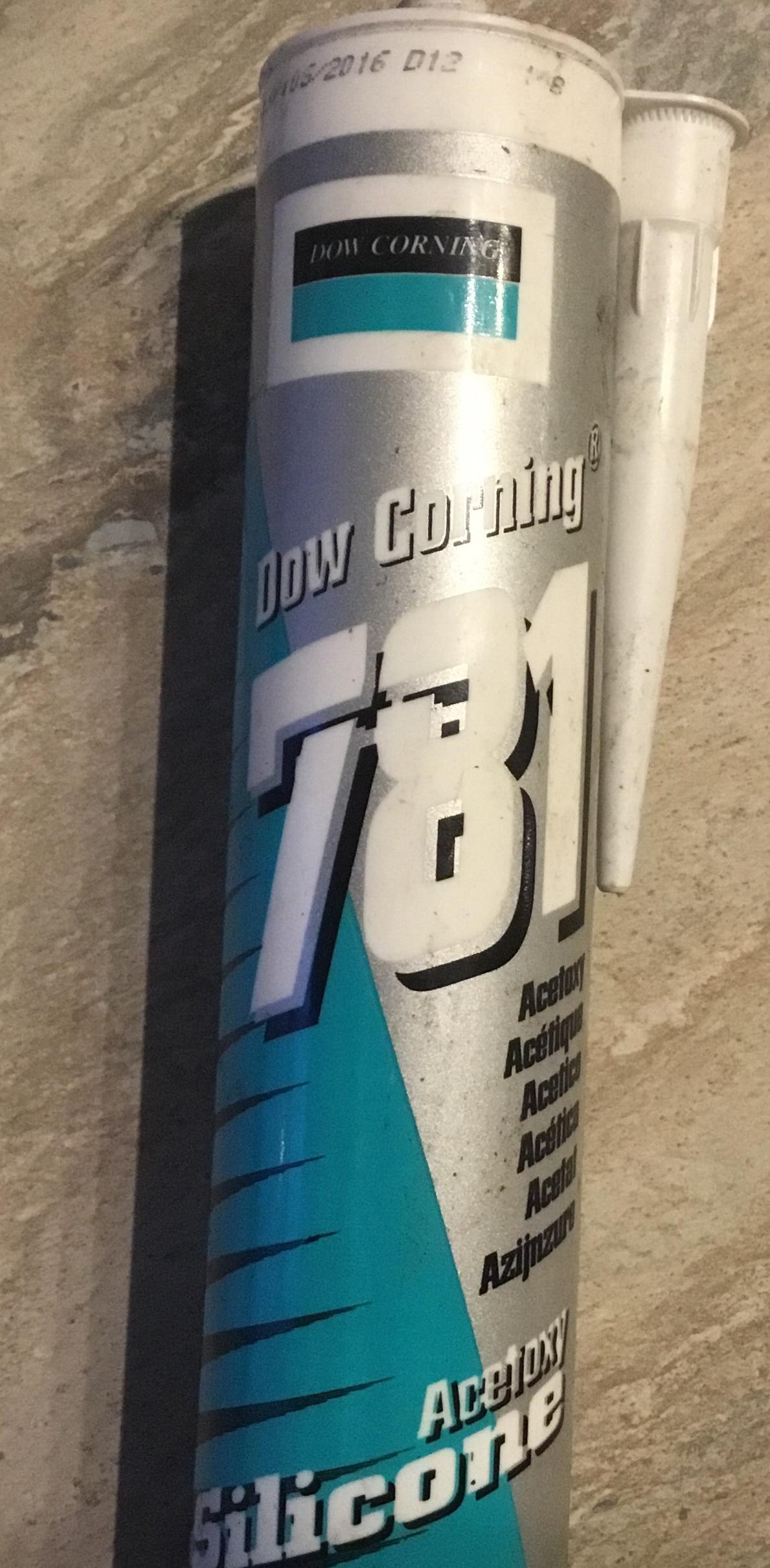

Cpd Posted February 7, 2019 Posted February 7, 2019 1 hour ago, A_L said: AC50 12 for £22.90 inc vat Great stuff for what it’s designed for, I have used a lot of this round all my plasterboard joints and all wall and ceiling joints but I don’t think it would be good for this job, it sets a bit ridged - yes it’s “permanently flexible” but you want something more rubbery in texture I think...... a silicon like ct1 in texture but cheep as chips. I got a bunch of this stuff for nothing as it was out of date and it’s been great for putting between wood joints to act as an air seal. Again this is not made for this but it does stay really rubbery / flexible.

Onoff Posted February 7, 2019 Posted February 7, 2019 4 hours ago, Cpd said: I got a bunch of this stuff for nothing as it was out of date and it’s been great for putting between wood joints to act as an air seal. I had the opportunity to get hold of some out of date Dow stuff but never bothered. Was told it won't set?
